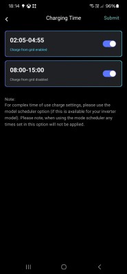

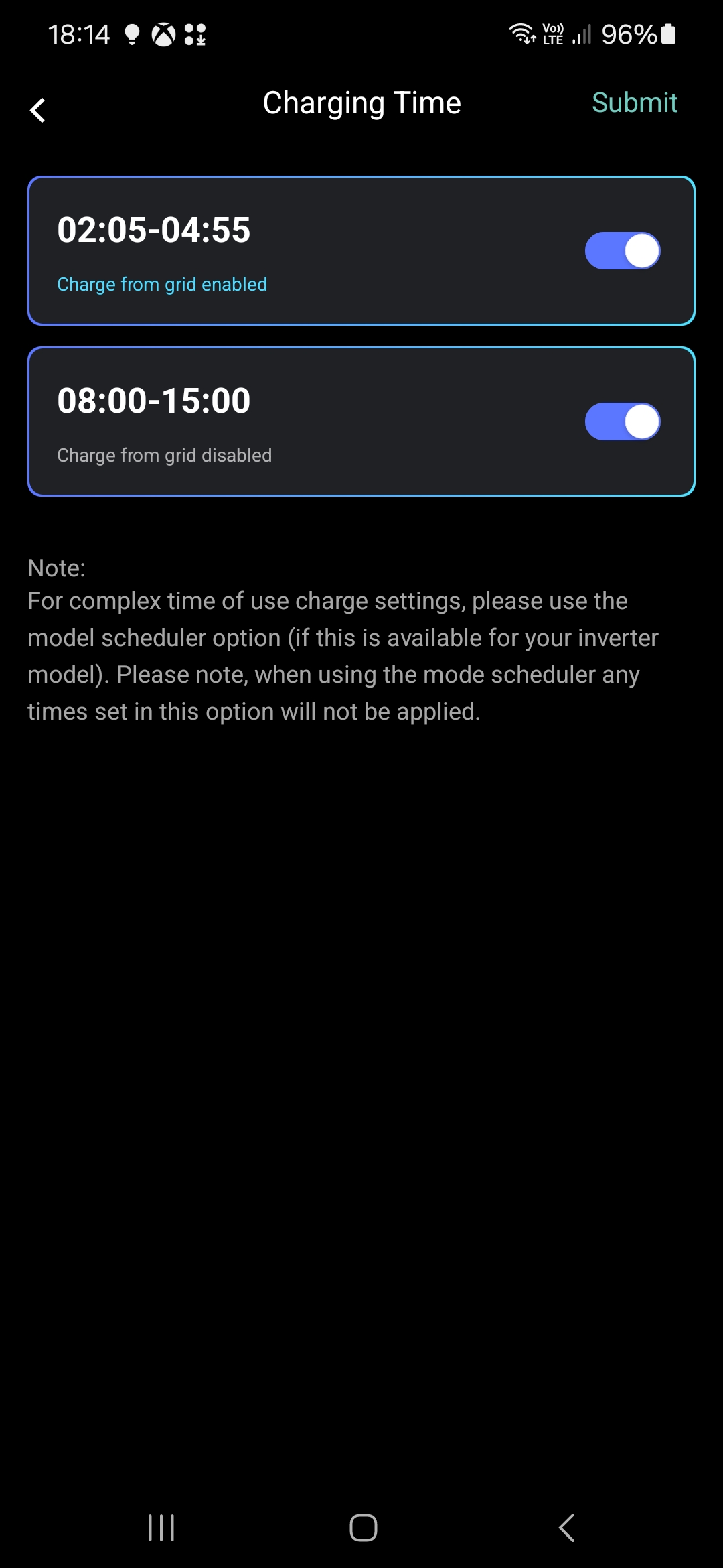

Work mod is set to self use and min soc is 20%, below is a screenshot of my charge time settings, as for preventing discharge I have no idea how I would do that in the first place just about worked out the charge times.
You need to remove the second ‘charge’ period 08:00-15:00 - because the charge from grid is disabled, this effectively sets your batteries to not discharge during that period and that’s the problem.
You only need the 02:05-04:55 period, the batteries will charge automatically from solar as long as the work mode is set to self-use.

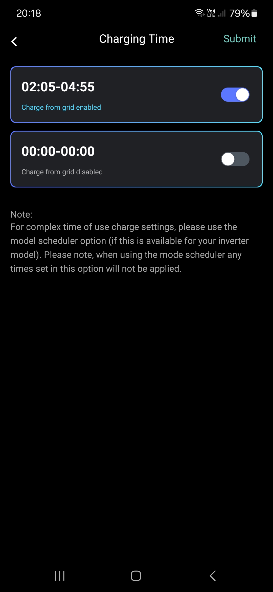

Wish that was made clearer in the app set up..., much appreciated will switch that 2nd option off so now looks like this, should hopefully do the trick.
Yep that’s spot on now

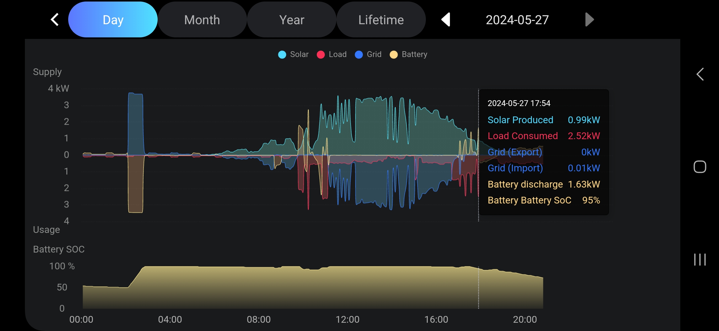

Battery discharge seems a little choppy is this normal sorry to tag onto this topic again battery is discharging now but seems choppy if you look at the picture below shows pulling from grid aswell as pv and battery.
I think I may be reading this wrong, starting to think load consumed includes battery ?
It does yes, it’s basically your house load whether being provided by solar or battery.
On the grid import, it’s a grid tied inverter which means it has to syncronise to the grid and it does that by taking a small amount of power (less than 10 watts), when you are exporting it takes no power as it remains syncronised by sending power to the grid.
The other thing to mention is this isn’t real time data, its built from a data sample taken every 5 minutes so it doesn’t always match what is happening ‘now’ on your system it could be up to 5 minutes behind.
