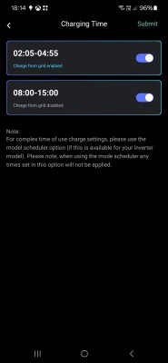

Correct Dave if pv isn't producing enough it pulls from the grid not the full battery, when pv ceases completely then the battery will doscharge. as for charge periods I have set up a 2 hour slot overnight to take advantage of the low rate to refill the batteries.
Work mod is set to self use and min soc is 20%, below is a screenshot of my charge time settings, as for preventing discharge I have no idea how I would do that in the first place just about worked out the charge times.
- Posts: 1786
You need to remove the second ‘charge’ period 08:00-15:00 - because the charge from grid is disabled, this effectively sets your batteries to not discharge during that period and that’s the problem.
You only need the 02:05-04:55 period, the batteries will charge automatically from solar as long as the work mode is set to self-use.

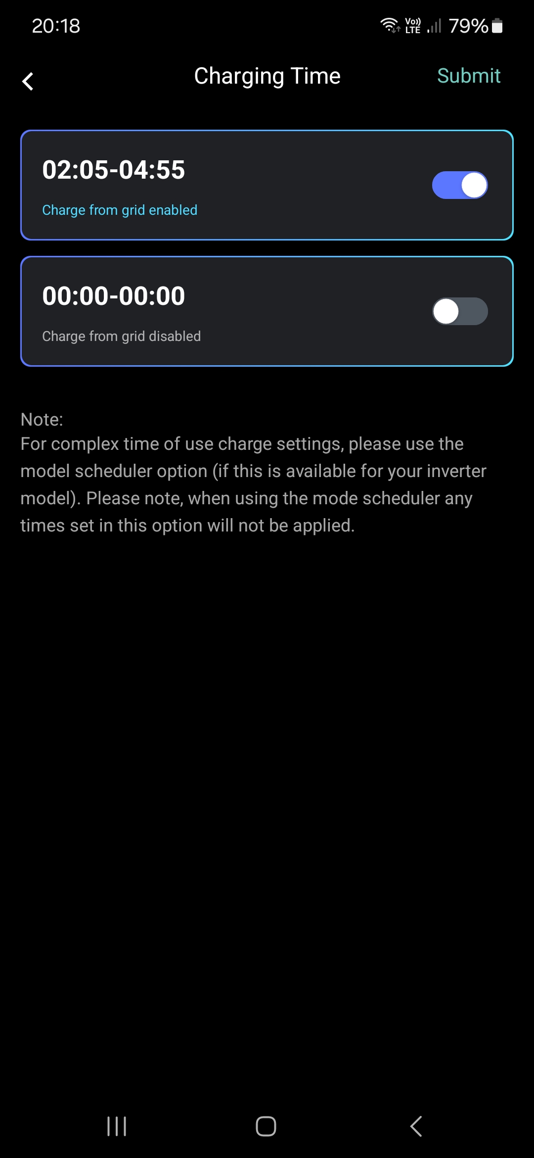

Yep that’s spot on now
It was changed about 6 months ago, there used to be 2 switches one for charge from grid and the other enabled the ‘don't allow discharge’ switch - when both were off it used to reset the times to 00:00 which was quite handy.

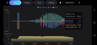

It does yes, it’s basically your house load whether being provided by solar or battery.Lee146 wrote: Mon May 27, 2024 9:15 pm I think I may be reading this wrong, starting to think load consumed includes battery ?
On the grid import, it’s a grid tied inverter which means it has to syncronise to the grid and it does that by taking a small amount of power (less than 10 watts), when you are exporting it takes no power as it remains syncronised by sending power to the grid.
The other thing to mention is this isn’t real time data, its built from a data sample taken every 5 minutes so it doesn’t always match what is happening ‘now’ on your system it could be up to 5 minutes behind.
