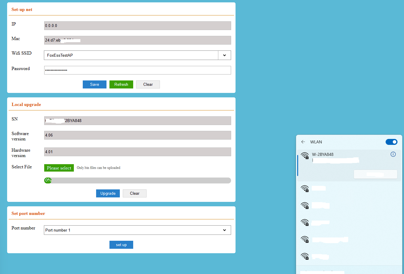

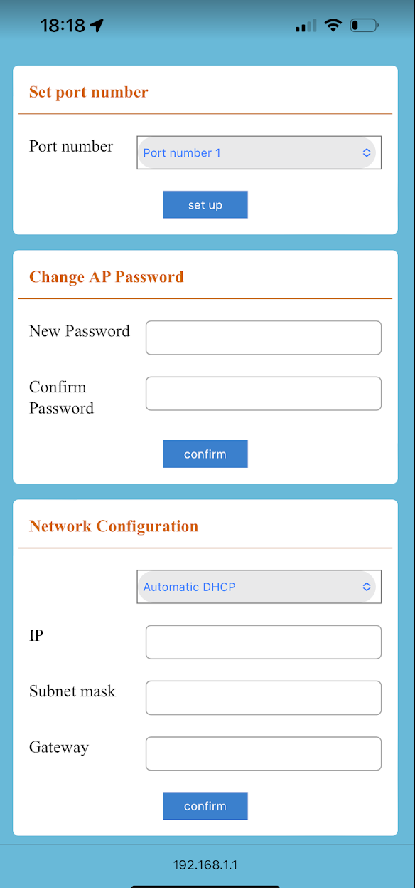

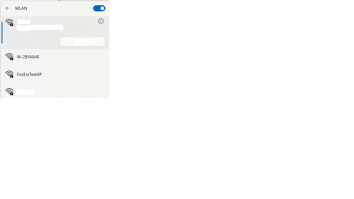

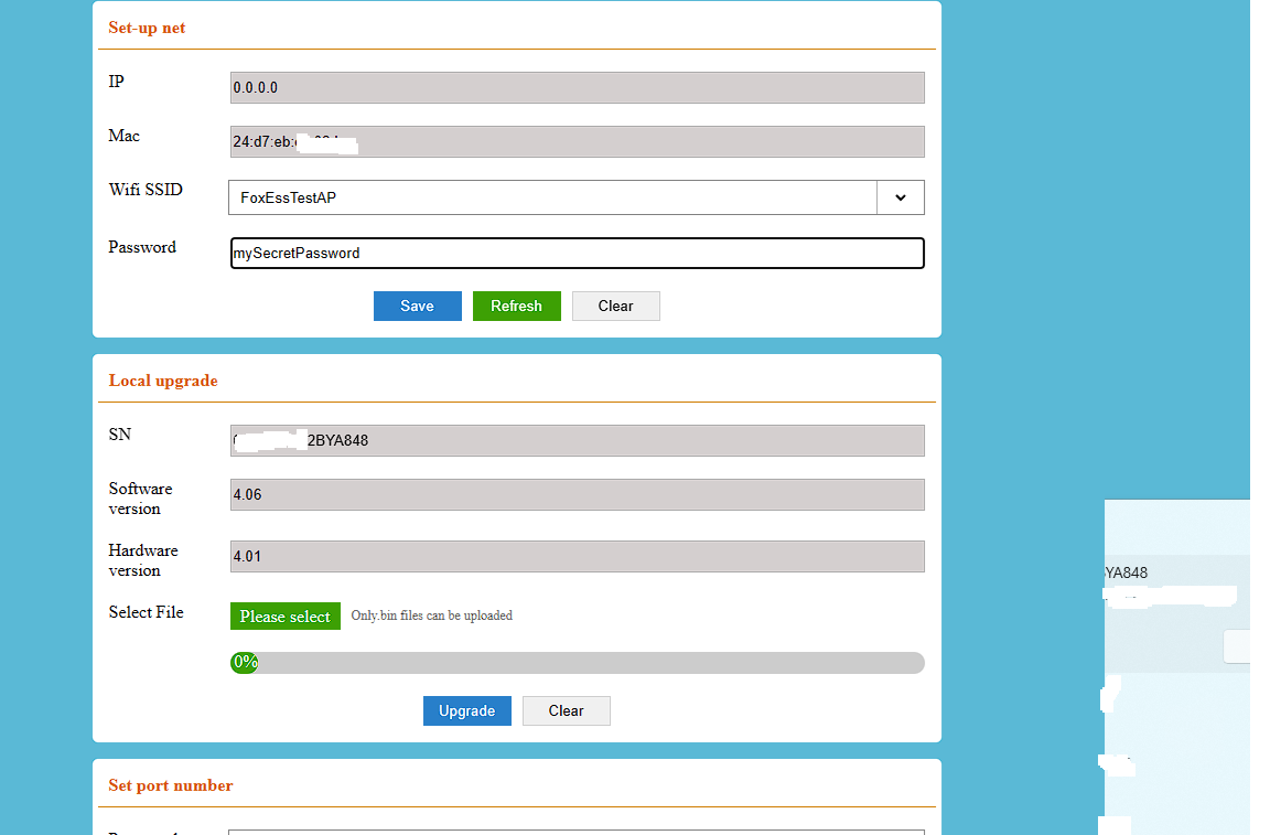

if there are some people out there which received the ANATEL Wifi dongle together with their inverter installation, could you please take a look find out if dongle's AP mode is still active after setting up STA mode? And if so, if password for STA mode is still readable in AP mode user interface? Best is, you check that from a second, uninvolved PC or smartphone - or you ask your neighbour
If you can read the Wifi password from there in cleartext, please confirm.
