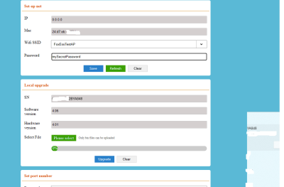

I made some screenshots to make it more clear: Connected to Dongle AP for configuration of SSID FoxEssTestAP; Dongle AP is W-2BYA848.
If you click into the password field, it is undisclosed:

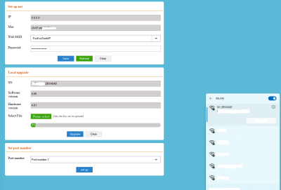

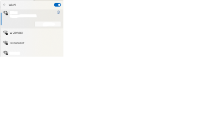

And AP mode is still available even when STA mode is fully configured:
So: Your neighbour may anytime connect to W-XXXXXX Dongle AP and read your Wifi password in cleartext.
I hope this helps to understand my point...
Best regards, CP

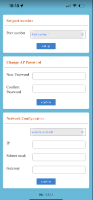

USB is the latest gen 3 version. the gen 2 you can update the default password. I'm just testing a gen 3 now and see if on the latest version this has been added.
Re: Possible security flaw in Anatel Wifi Dongle
Good news, I can confirm the following:
Version 3.16+ of the gen 2 (4 pin module) datalogger you can set the AP password
Version 4.12+ of the gen 3 (USB module) datalogger you can set the AP password
You need your installer or fox to update your data logger firmware.
I attached picture of the option below
