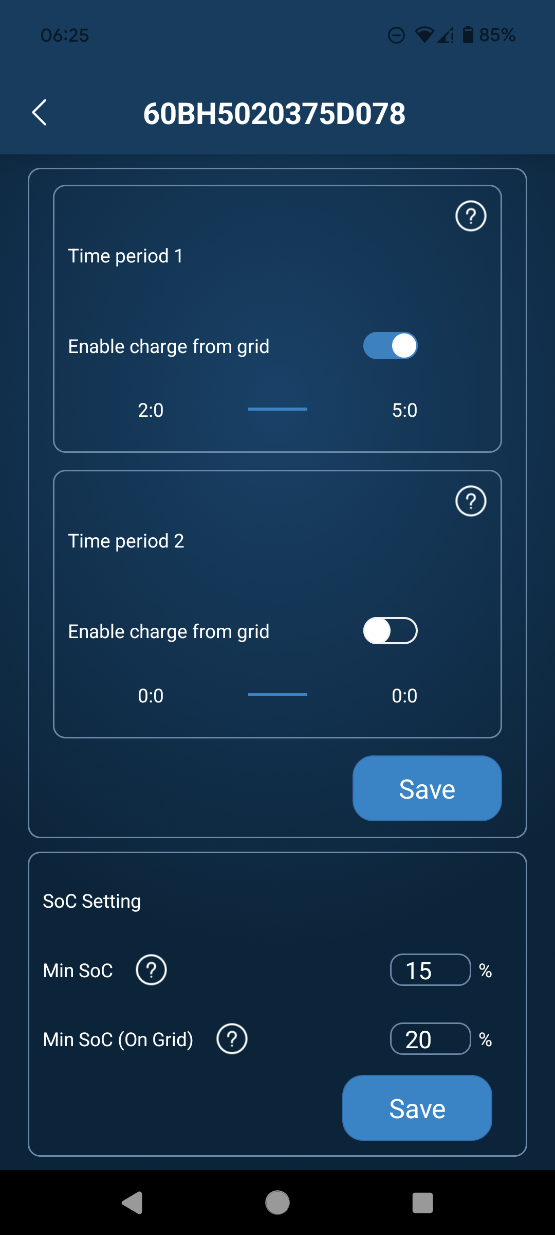

Hi, recently had my system installed and switched to octopus flux, and looking at how to charge overnight during cheaper tariff to top up the battery when needed.
Watched some great videos by iameccles and read threads on here suggesting how to do it, set the schedule up overnight as per the screenshot.... And no charge happened....any advice as to what I've done wrong or is there a hidden setting somewhere that I've missed that I also need to change to enable grid charging / battery top up overnight? I thought you could just put it in the schedule and it would automatically charge. Any help would be most welcome!

Those settings are correct for to charge from grid between 2am to 5am - were there any errors, which inverter model is it ?.

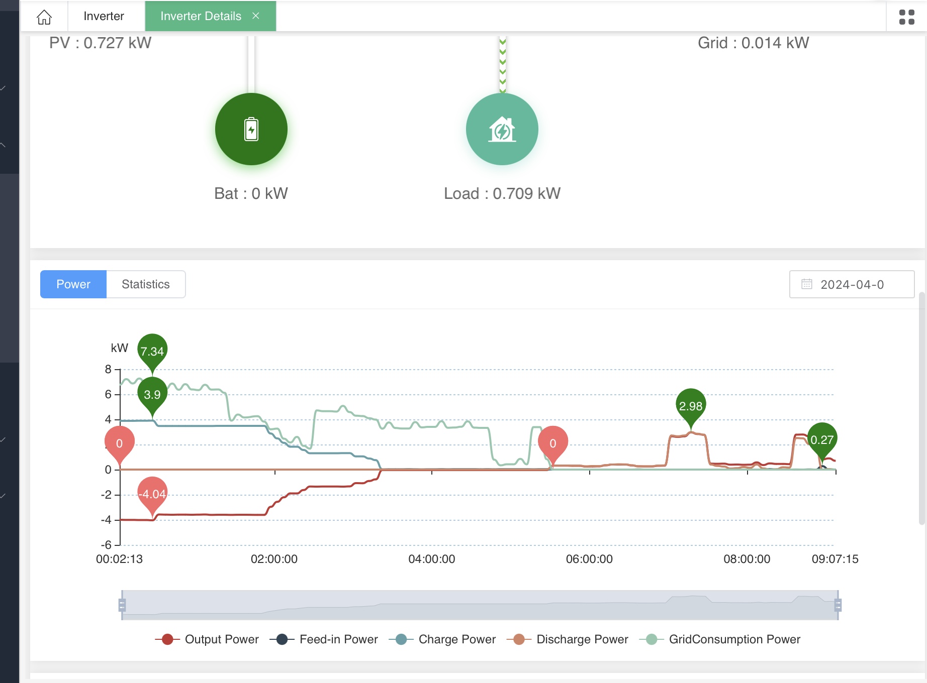

If you log into the Foxesscloud.com website - and go to the device page - on the graph at the bottom do you see any evidence of charge power (even if just small blips) - might be helpful if you post that here (the graph looks like the attached).

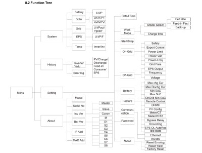

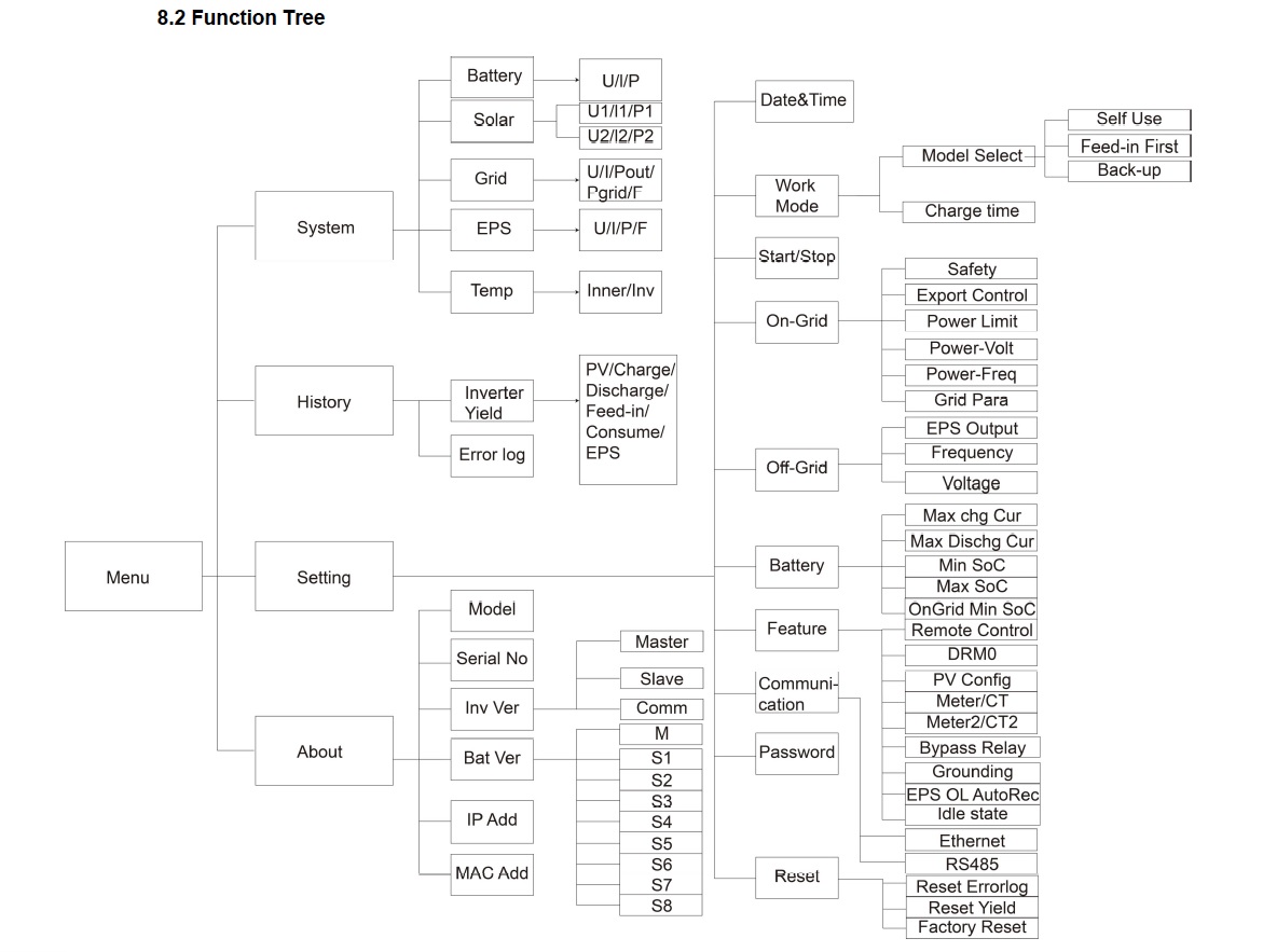

The inverter should have come with a user manual, but to be honest it's more of an installation manual - the good things in it are it shows the panel and explains how to start it, and also has the menu tree which shows the various options - although many settings should be regarded as being used only under instruction.
This is the menu tree -
The default password is normally 0,0,0,0
