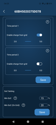

Hi, recently had my system installed and switched to octopus flux, and looking at how to charge overnight during cheaper tariff to top up the battery when needed.
Watched some great videos by iameccles and read threads on here suggesting how to do it, set the schedule up overnight as per the screenshot.... And no charge happened....any advice as to what I've done wrong or is there a hidden setting somewhere that I've missed that I also need to change to enable grid charging / battery top up overnight? I thought you could just put it in the schedule and it would automatically charge. Any help would be most welcome!
    				    				Those settings are correct for to charge from grid between 2am to 5am - were there any errors, which inverter model is it ?.

Thank you for the reply, for some reason (probably from me trying to have a look at the battery on screen display) the system had switched to off mode...it turned out i wasnt getting any solar in the morning - rang solar bureau - about it - they said theyd look into it and get back to me... i'm still waiting for a response.. i randomly pressed a few buttons on the battery display and restarted the system... and it worked fine and as expected last night and re-charged overnight...

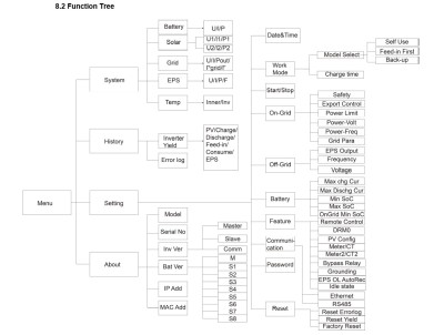

So as you suggested it wasnt in normal mode - thats what made me have another look! Is there a simple user guide somewhere which shows navigation of the on panel systems? (sorry really new too this, so learning as i go!)
I did try and look at my settings, so in the event of a power cut i know how to manually switch to back up mode... its locked by a password, one which i dont have - would it be a default number ie 0000? i tried 1234... with no joy.

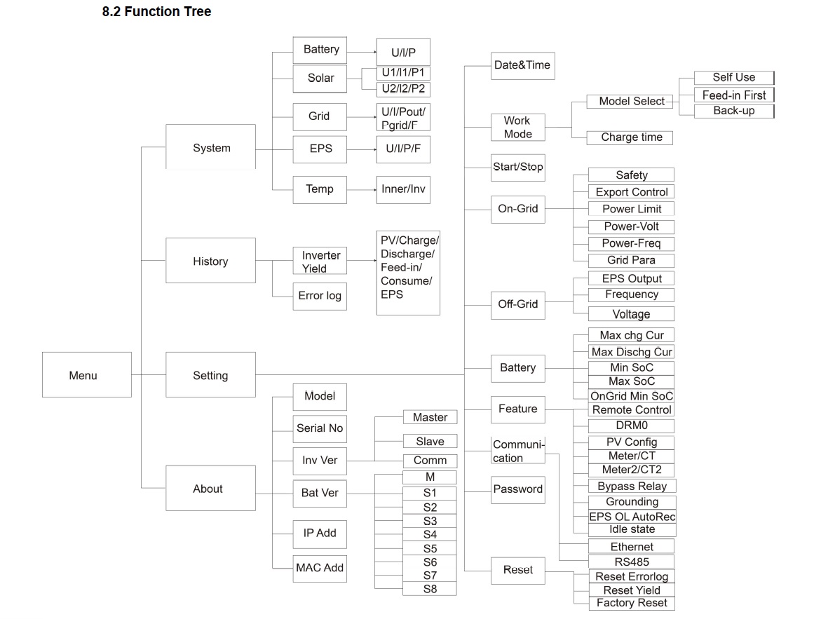

    				    			Ok, glad it's working again - it sounds like it hadn't been set to 'start', now it is started it will stay that way (unless you stop it).
The default password is normally 0,0,0,0
The inverter should have come with a user manual, but to be honest it's more of an installation manual - the good things in it are it shows the panel and explains how to start it, and also has the menu tree which shows the various options - although many settings should be regarded as being used only under instruction.
This is the menu tree -
