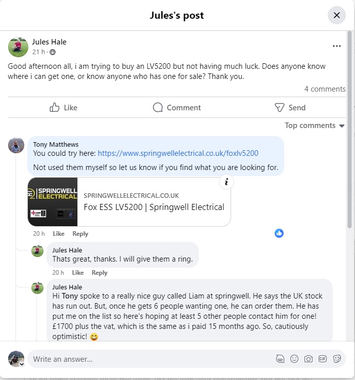

Good morning all, i am trying to buy another lv5200, which is proving almost impossible. No one sells them anymore, which is a bit annoying as i only bought these batteries 15 months ago. So, does anyone either know somewhere that still sells them, have got one for sale or knows someone with one for sale. Many thanks.

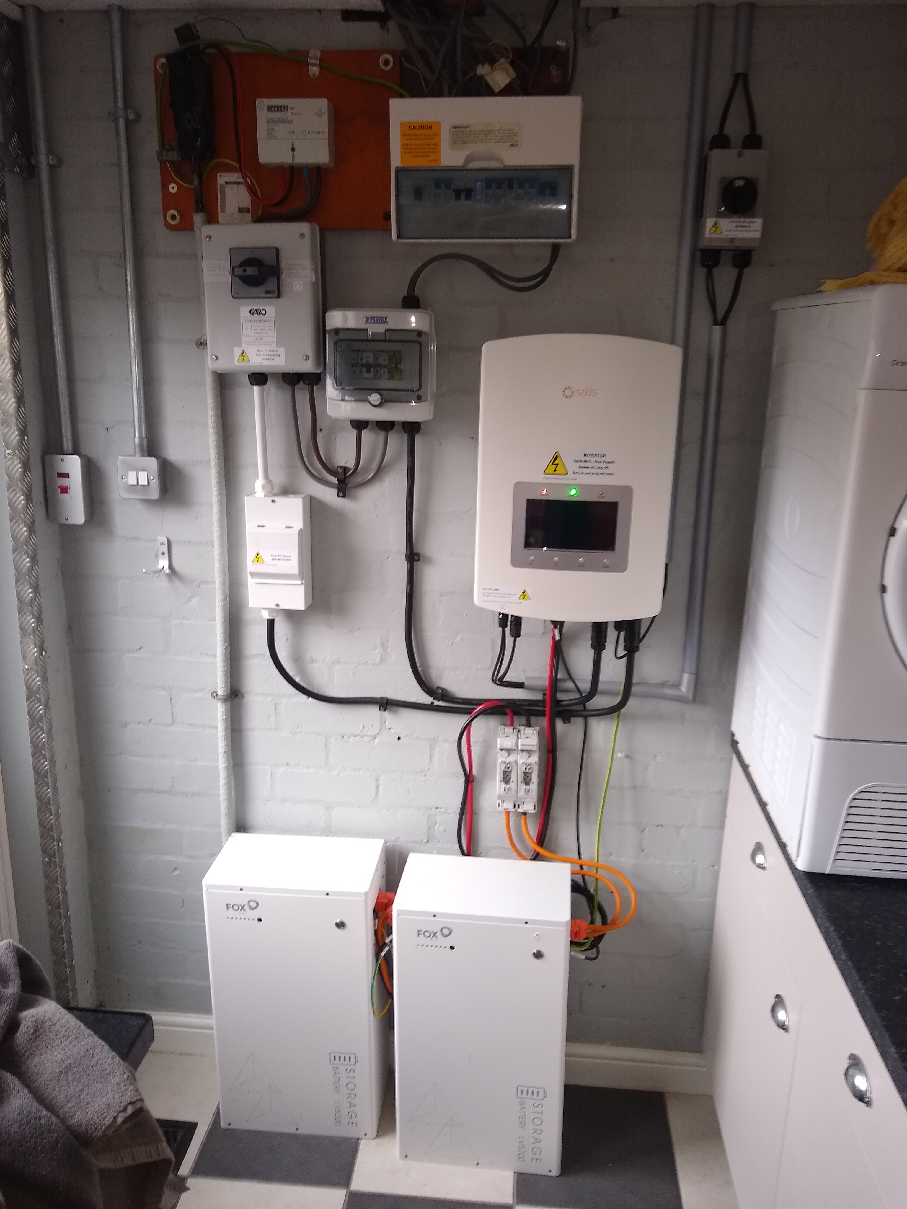

Good afternoon Dave, I really dont know what to think anymore! lol! Every way of doing it has its own problems.I saw that the ep5 has a junction box for more than 1 battery. I may be able to find room for that to the left of my set up. Just a quick add up, going to be 6 grand ish whichever battery i choose. The cube looks attractive but i havent got the height space under the inverter and the KH is slightly longer. Thank you for the FB post but it is actually me! Well, its my partners account as i dont do FB. I am starting to think that buying another lv5200 is a waste. I am trying to keep obsolete batteries going by putting more money into them, which is a bit stupid when there are alternatives. Maybe you are right. Get a system that suits us and try and sell the old one somewhere. This is how its set up at the moment in a utility room i built. I guess i could rip out some of her cupboards! Yeah, that will make her real happy! Haha! Thanks again for the comment. I might start to actually understand my solar eventually!

yes agree, it's a lot of money to end up at a similar place, but going forwards getting HV batteries is the way you want to go - more LV's isn't going to be a good investment.
The EP'x' range uses the junction box as the parallel connection point, each battery has a DC switch, so you wouldn't need those DC isolators - just the junction box.
It's even better with the ECS 'cube' batteries as they have internal ports which connect when they stack so much tidier for an indoor install such as yours - The cube batteries also have an on-board battery isolator on the master so again you wouldn't need the DC isolators which would give you more space underneath to fit a fair few cube batteries in a stack.
ok. Thats interesting. I have been measuring up and if those dc isolators were not there, it would make things a lot easier. So i wouldn't even need fuses between the battery and inverter? I do like the cube, but what's the betting these will be obsolete in 18 months time and the new ones cant be used with the KH! That would be typical of my luck! lol! I think i will seriously look at getting a cube. Are all the different sizes compatible? Can i put a 4.1 with a 4.8 and a 2.9kw for instance? That would make it more attractive as a system to me. Thanks Dave.
