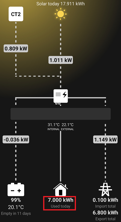

Energy Stats only uses the parameter loadsPower in the real-time display for house load.
meter2Power is optionally combined with pvPower in calculating the total "Yield today", based on the setting "combine ct2 with pvpower".
I could imagine that the position (and direction) of CT2 would make a difference as to how these values display. So I could add an option to include meter2Power in the real-time loads if you think that would help?

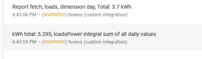

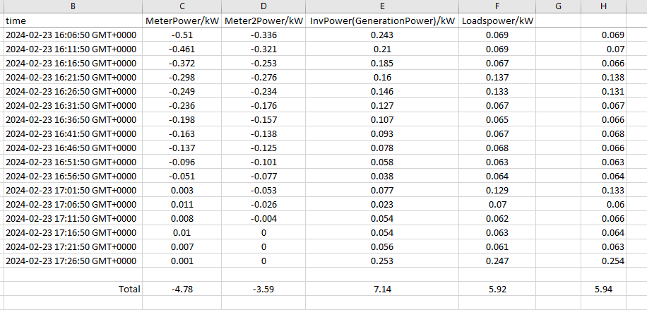

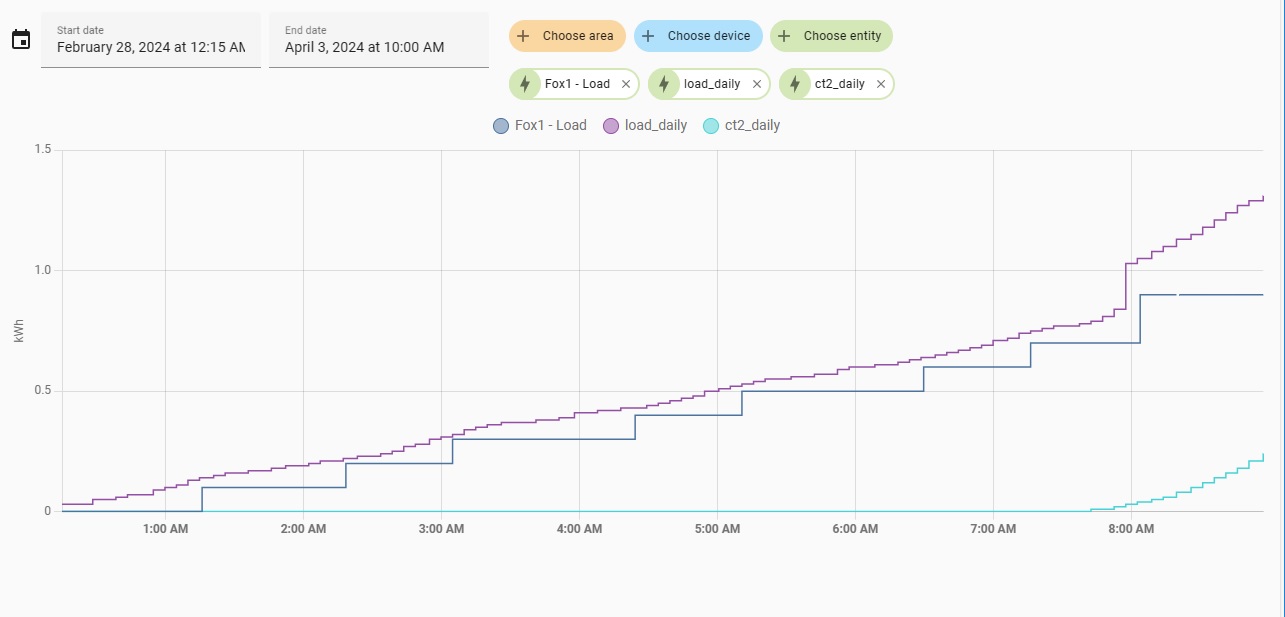

Is it possible to calculate the "Used Today" using the LoadsPower? Here are today's figures:
Adding up the 5 minutes figures show "LoadsPower" at 5.9kWh for the day, but Energy Stats (and Fox's apps) both show 3.6kWh instead. I could be wrong, but it looks like the apps are adding InvPower and Meter2power but as meter2power is negative, its doing 7.14 minus the 3.59kWh to give the 3.6kWh figure, so its reporting 2.3kWh too low.
In Energy Stats, I have the "Invert CT2 values when detected" option ticked, as then it correctly shows the feed from inverter 2 as positive. I don't use the "Combine CT2 with PV power" option though as this essentially subtracts the PV yield of inverter 2 from the main inverter due to it being negative and I get an incorrect lower number.
Looking at the figures over a few days, it looks like the way the inverter is calcuating the "Loadspower" figure is:
InvPower (7.14kWh) + MeterPower (4.78kWh) + (the inverse of) Meter2power (3.59kWh) = 5.94kWh (loadspower)
I'm assuming the CT clamp from Inverter 2 to Inverter 1 is the correct way around as it is seeing it as a negative value (incoming power).
Its all a bit confusing!

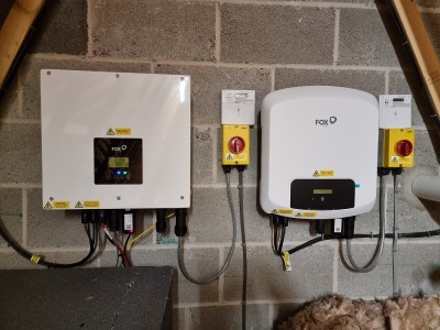

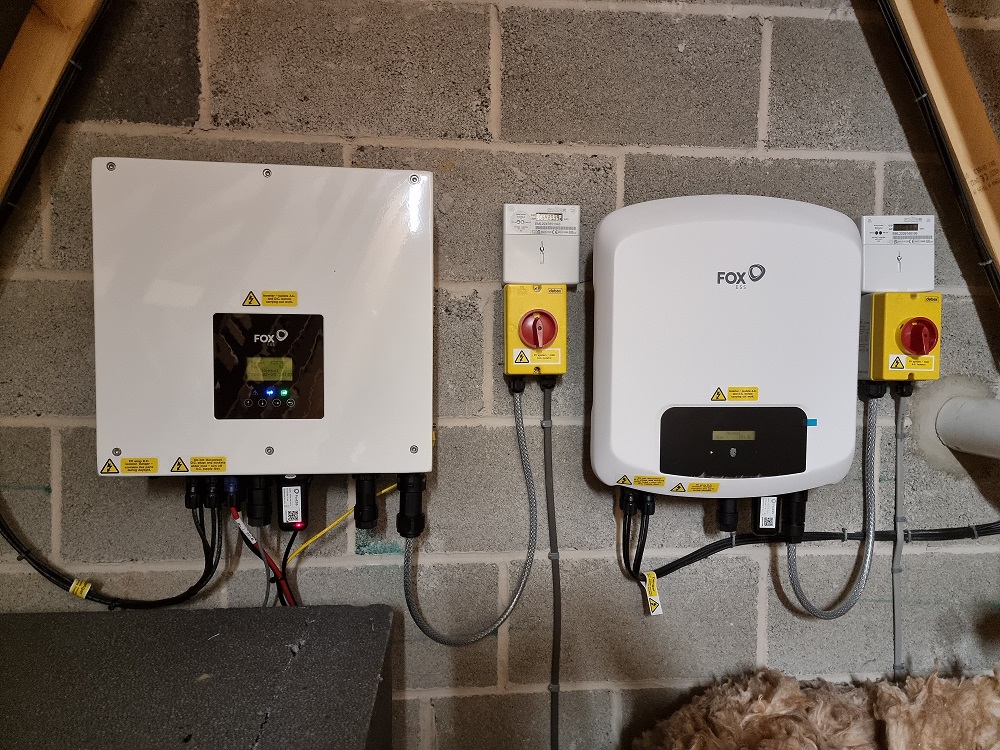

Hi Dave, this is the installation:
The H1-5.0-E inverter was installed first in 2023 and the F3600 last month. I'm not very knowledgeable and maybe you could confirm from the picture, but I don't think the installers have actually installed a CT clamp between the two as I requested. Looking at it, there appears to be nothing obvious connecting them both. I always assumed as I was getting a CT2 reading on the cloud/energy stats/Fox app that it was present, but now I'm not so sure. I've flicked through the inverter front panel settings and it isn't seeing it. I also have the added complication that the installers also didn't install a wifi module onto the F3600, meaning I had to install one myself. That added the problem that the inverters are on two different identically named sites in the cloud.
If this is the case then I'm not happy with the installer as they've already had to come back due to forgetting to install the generation meter on the second inverter!
- Posts: 1184
It's not visible on the picture but it could be fitted where the solar distribution box is, i've sometimes seen them clipped round the live inside the DB.
But it answers one question, there is definitely no CT fitted for the F series which is correct for this type of install.
The fact that you are getting a reading from CT2 even though the inverters are in 2 distinct accounts makes me think it must be fitted, so it's a question of where - i'm sure you're familiar with what the Foxess ones looks like it's a small white cable clamp with a black cable - the main CT(1) clamp will be fitted around the live tail of your smart meter.

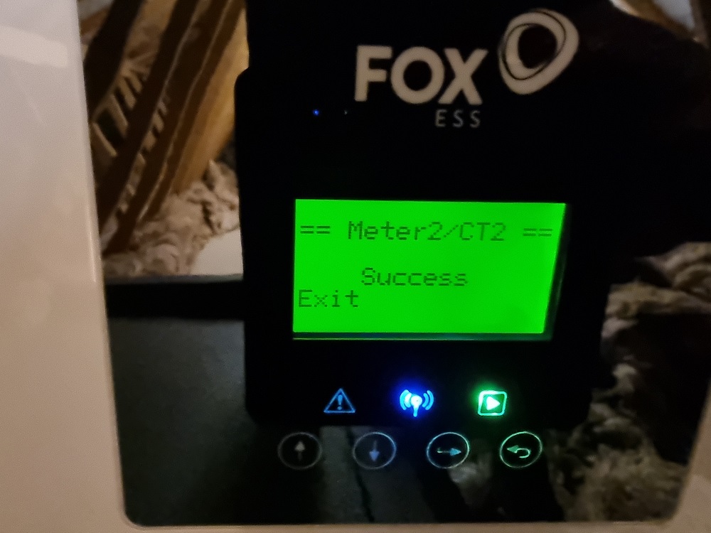

On the H1 hybrid if you can go into Settings, Feature, Meter2/CT2 it will give you 2 options 'Set' & 'Check' - if you select 'Set', it should say [CT], if it does you have a CT2 clamp fitted (somewhere) - just click the right hand return button to get out of there. Obviously if it says [Disable] then there is no CT2 fitted but i'm guessing there is - can you confirm what you see there.

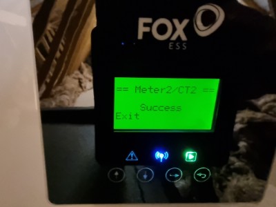

Hi Dave,
I've been through the inverter settings and CT2 appears to be there. If I go to meter2/CT2 and set, when selecting "CT" it shows "success".
I actually had 10 days after installation without a dongle on the F3600 (From 11th - early on the 21st Jan) and the figures showed exactly the same discrepancy as now. On the 20th January for example the apps showed a total house load of 9.6kWh, but the "loadspower" 11.6kWh, so I'm confident it is not datalogger related.

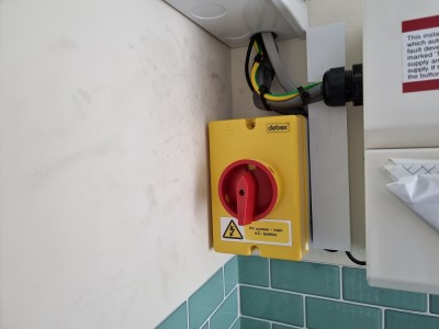

Here's the distribution box cabling that is visible. Nothing immediately obvious to me, but there's not really much to see.

I think that small black cable peeking out of the trunking looks a lot like the CT clamp cable, so i'm guessing it is inside that white distribution box on the right hand side of the photo.

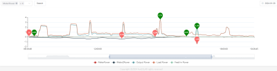

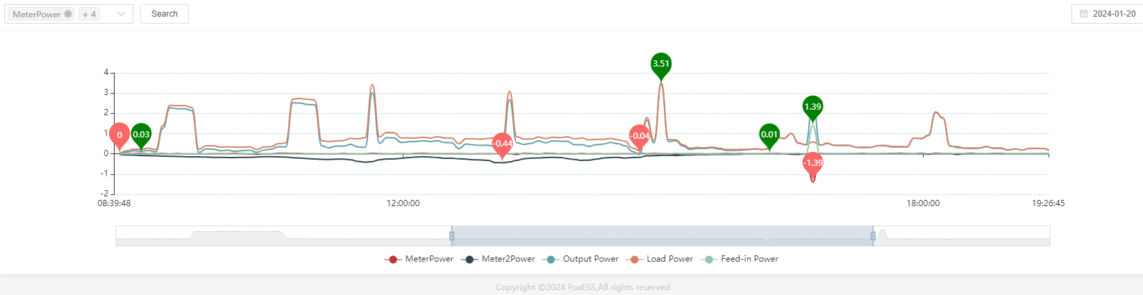

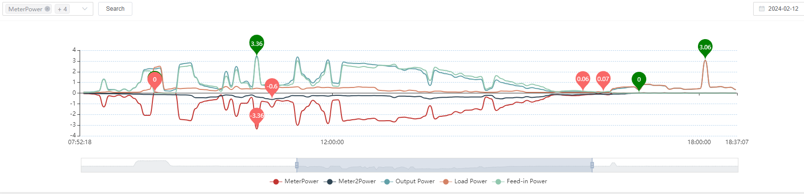

Can you post a couple of graphs from the fox website, using the graph at the bottom of the energy flow page where you can select sensors.
It would be helpful to see meterpower, meter2power, outputpower, loadpower and feedin power all together on the same graph for each day,
you've mentioned the 20th January above so that days trace plus a few other days where there was reasonable solar generation would be useful.

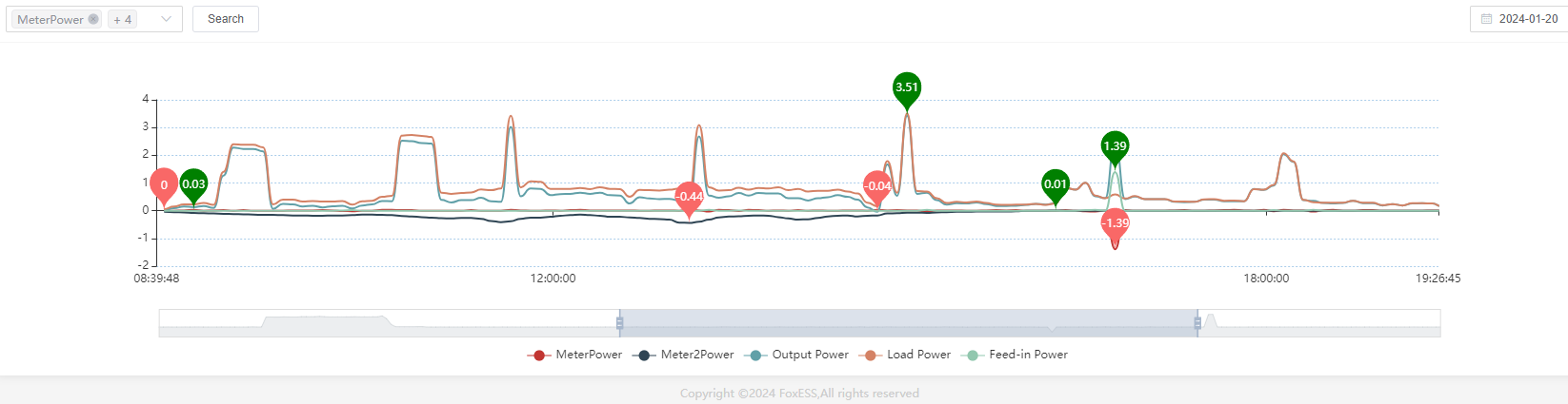

Here are the traces. The first is 20th January, before the wifi dongle was added the next day, Ive zoomed in to the daylight hours as the F3600 turns off and the Output power and Load Power then match exactly as only the H1 is online:

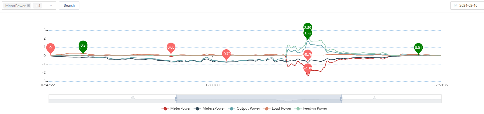

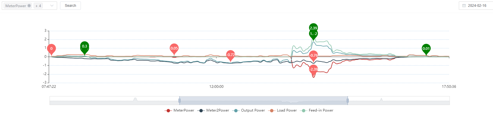

The next two are from the 12th and 16th February. I cant really show any generation from the F3600 better than this as its a NW-facing array and so isnt generating much over 3-4kWh per day at present.
What can be seen is as meter2power increases, output power reduces. When load is low, output power goes negative, which is what will happen when generation is high on the F3600 during the summer I imagine. Load Power is unaffected on the graph, it shows the house load correctly.
I'm wondering if its a cloud issue? The data is there, correct and going to Fox, but despite Load Power data being correct on the graph here, the issue persists?

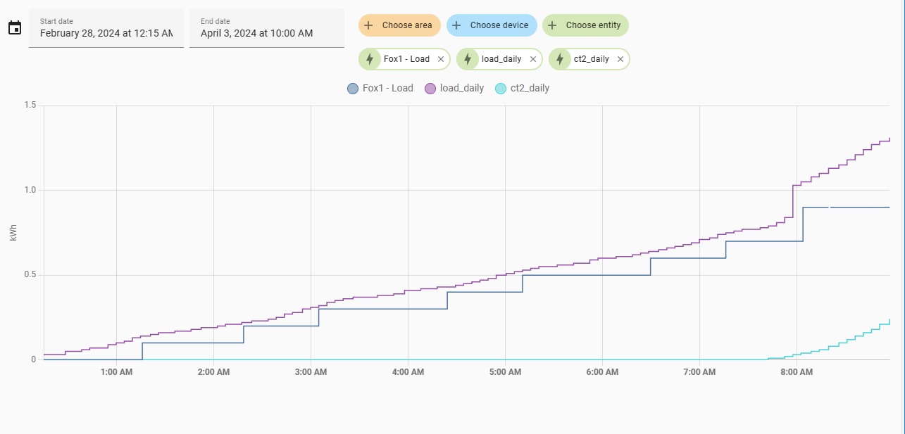

- Posts: 1184
As you say the load_power is calculating correctly, but not the cumulative - what I would really like to do is to gather raw data from the cloud and look at the report data (totals) and cross reference it, and/or establish a better method for getting to the cumulative loads.

Just a quick update, i’ve spent most of the day running test scripts against your data, and have written some riemann sums that will convert your reported load power 5 minutes samples (kW) into a time based increasing total (kWh).
I’m going to need a full day tomorrow to record a daily set of results as it will show the differences between reported load cumulative and actual load cumulative when measured directly off the load sensors.
At the moment I see exactly what you are seeing, namely the real time load_power is correct but the reported totals are not, as of around 20 minutes ago this was the difference
The first number (3.7kWh) comes from a report fetch by day, which provides hourly sums and when totalled it gives your cumulative load power that you see in ES and Fox apps.
The second number is taken by feeding all of your 5 minute load power samples for today and converting them into hourly usage and when totalled it is 5.295kWh which is I think your ‘real’ cumulative load usage - it’s a heck of a lot of maths but necessary to make sure the data is sound.
From your typical use, would you say that 5.295kWh sounds more realistic than the reported 3.7kWh ? (up to 6.45pm)
Hi Dave, it's a similar sort of difference as what I have been seeing. 3.7kWh is definitely not correct. Our usage today was pretty low as no-one was here most of the day, but it's actually a very good example of what is happening as the load totted up in the apps by just 0.1kWh between 8am and 3pm despite a low, but steady baseload. In this case, what was coming in from the F3600 exceeded the load, so output power was negative during this whole time and no load was counted in the total.
- Posts: 1184
Yes agreed, that is what I am seeing, they are correcting the load power to show the power coming in from meter2, but they are not correcting the load cumulative totals.reef wrote: ↑Tue Feb 27, 2024 11:12 pm Hi Dave, it's a similar sort of difference as what I have been seeing. 3.7kWh is definitely not correct. Our usage today was pretty low as no-one was here most of the day, but it's actually a very good example of what is happening as the load totted up in the apps by just 0.1kWh between 8am and 3pm despite a low, but steady baseload. In this case, what was coming in from the F3600 exceeded the load, so output power was negative during this whole time and no load was counted in the total.
Just an FYI if you ever decide to move to a home assistant all of these can be corrected by formulas and integral sums (you don't need to go to the trouble of RS485, you can access their cloud data).
This is your cloud data for today, showing the reported load total 'Fox1 - Load', the integral sum of your real load_power (load_daily) along with an integral sum of meter2 (ct2_daily).
As you can see the 'Fox1-Load' tracks load_daily until meter2 starts to generate power at which point the difference is related to (but not precisely) ct2_daily (the cumulative sum of meter2 today)
But it needs some maths and a home assistant do this.
I am going to email Foxess r&d and explain what I am seeing (incidentally there are different issues with 3 phase hybrids, which I have to cover to them), this might be a lot of backend work for them so I don't know how they will respond, but i'll let you know the response.
I've already messaged Al to bring him upto date with this, it's a difficult fix for the app, a lot of data and maths - but there may be something he can do to correct your todays cumulative load.
The F3600 array has generated around 4.8kWh today, so the result is as extreme as ever so should give a good example of it.
As of 16:50, the apps were showing a cumulative house load of 3.4kWh, but by my calculations from Loadspower, we've actually used 7.0kWh.
This is using a download of today's inverter data from the H1 and dividing the 5 minute Loadspower by 12 and adding all of the values up.
