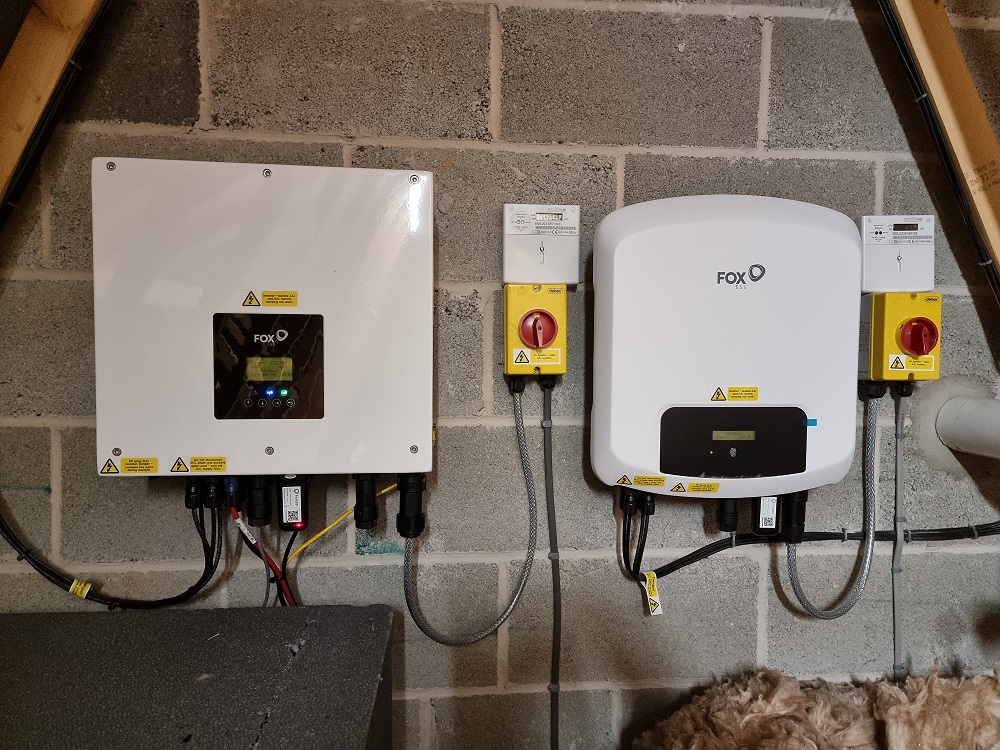

Hi Dave, this is the installation:
The H1-5.0-E inverter was installed first in 2023 and the F3600 last month. I'm not very knowledgeable and maybe you could confirm from the picture, but I don't think the installers have actually installed a CT clamp between the two as I requested. Looking at it, there appears to be nothing obvious connecting them both. I always assumed as I was getting a CT2 reading on the cloud/energy stats/Fox app that it was present, but now I'm not so sure. I've flicked through the inverter front panel settings and it isn't seeing it. I also have the added complication that the installers also didn't install a wifi module onto the F3600, meaning I had to install one myself. That added the problem that the inverters are on two different identically named sites in the cloud.
If this is the case then I'm not happy with the installer as they've already had to come back due to forgetting to install the generation meter on the second inverter!

It's not visible on the picture but it could be fitted where the solar distribution box is, i've sometimes seen them clipped round the live inside the DB.
But it answers one question, there is definitely no CT fitted for the F series which is correct for this type of install.

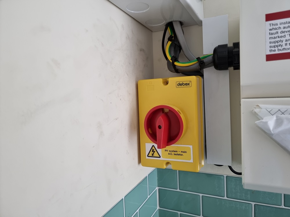

Here's the distribution box cabling that is visible. Nothing immediately obvious to me, but there's not really much to see.

I think that small black cable peeking out of the trunking looks a lot like the CT clamp cable, so i'm guessing it is inside that white distribution box on the right hand side of the photo.

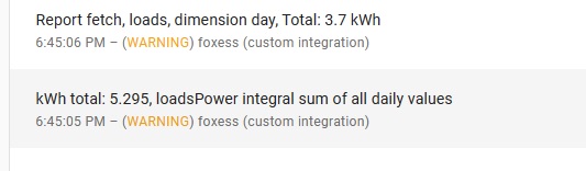

Just a quick update, i’ve spent most of the day running test scripts against your data, and have written some riemann sums that will convert your reported load power 5 minutes samples (kW) into a time based increasing total (kWh).
I’m going to need a full day tomorrow to record a daily set of results as it will show the differences between reported load cumulative and actual load cumulative when measured directly off the load sensors.
At the moment I see exactly what you are seeing, namely the real time load_power is correct but the reported totals are not, as of around 20 minutes ago this was the difference
The first number (3.7kWh) comes from a report fetch by day, which provides hourly sums and when totalled it gives your cumulative load power that you see in ES and Fox apps.
The second number is taken by feeding all of your 5 minute load power samples for today and converting them into hourly usage and when totalled it is 5.295kWh which is I think your ‘real’ cumulative load usage - it’s a heck of a lot of maths but necessary to make sure the data is sound.
From your typical use, would you say that 5.295kWh sounds more realistic than the reported 3.7kWh ? (up to 6.45pm)

Hi Dave, it's a similar sort of difference as what I have been seeing. 3.7kWh is definitely not correct. Our usage today was pretty low as no-one was here most of the day, but it's actually a very good example of what is happening as the load totted up in the apps by just 0.1kWh between 8am and 3pm despite a low, but steady baseload. In this case, what was coming in from the F3600 exceeded the load, so output power was negative during this whole time and no load was counted in the total.
