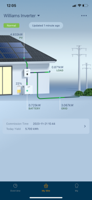

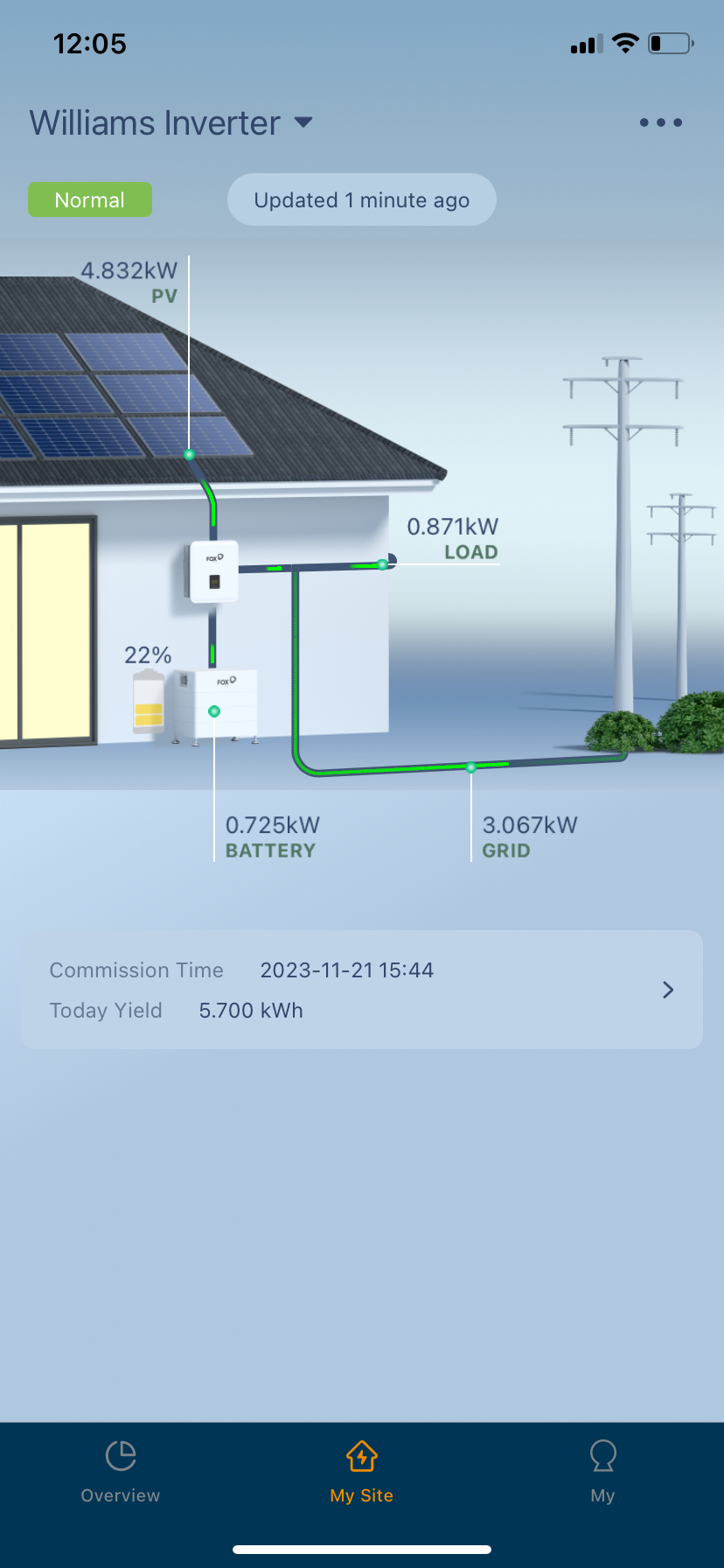

We have a nice sunny day today but the system is exporting instead of storing. I attach a couple of photos.
It is cold and the kit is in a heated garage, though it is still cold in there.
Do you think this exporting could be due to a cold battery?
Any help appreciated.
Thank you!
Philip

Can you see what the battery temperature is? If they battery gets too cold, it does limit the charge and discharge current to stop it getting damaged, below a certain temperature the battery will stop working entirely (it is not harmed, it will come back to life when things warm up).

One thing I've recently discovered after using the v2.0 app to download the inverter data is that the batteries can be a lot colder than you think and a lot lower than the "battery temp" value shown in the cloud. I was getting reduced charge rates from the grid overnight and couldn't understand why as the cloud said the batteries were about 16C. However looking at the battery cell temperatures in the data from the v2.0 app, they were sat between 7.8 and 9.2C.
I'm betting you're getting a low charge rate for that very reason. Especially with the cold weather at the moment.

The battery is 14 degrees. I can’t work out how to get the data I’m afraid.
The room is cold at about 5 degrees so I think this may be the issue. I’m sorting a stud wall and will put some low level heating in there to keep the temp up in winter.
