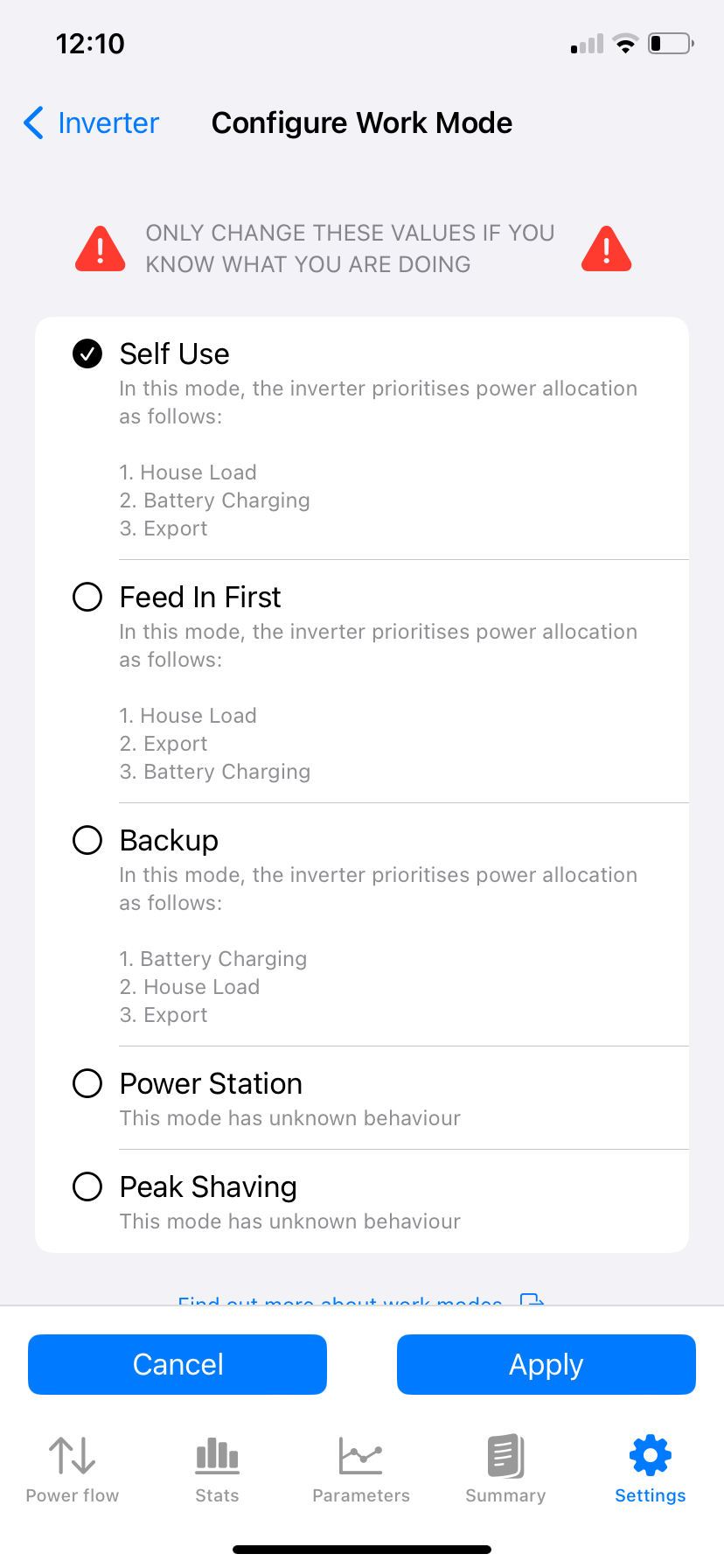

We have a nice sunny day today but the system is exporting instead of storing. I attach a couple of photos.
It is cold and the kit is in a heated garage, though it is still cold in there.
Do you think this exporting could be due to a cold battery?
Any help appreciated.
Thank you!
Philip
