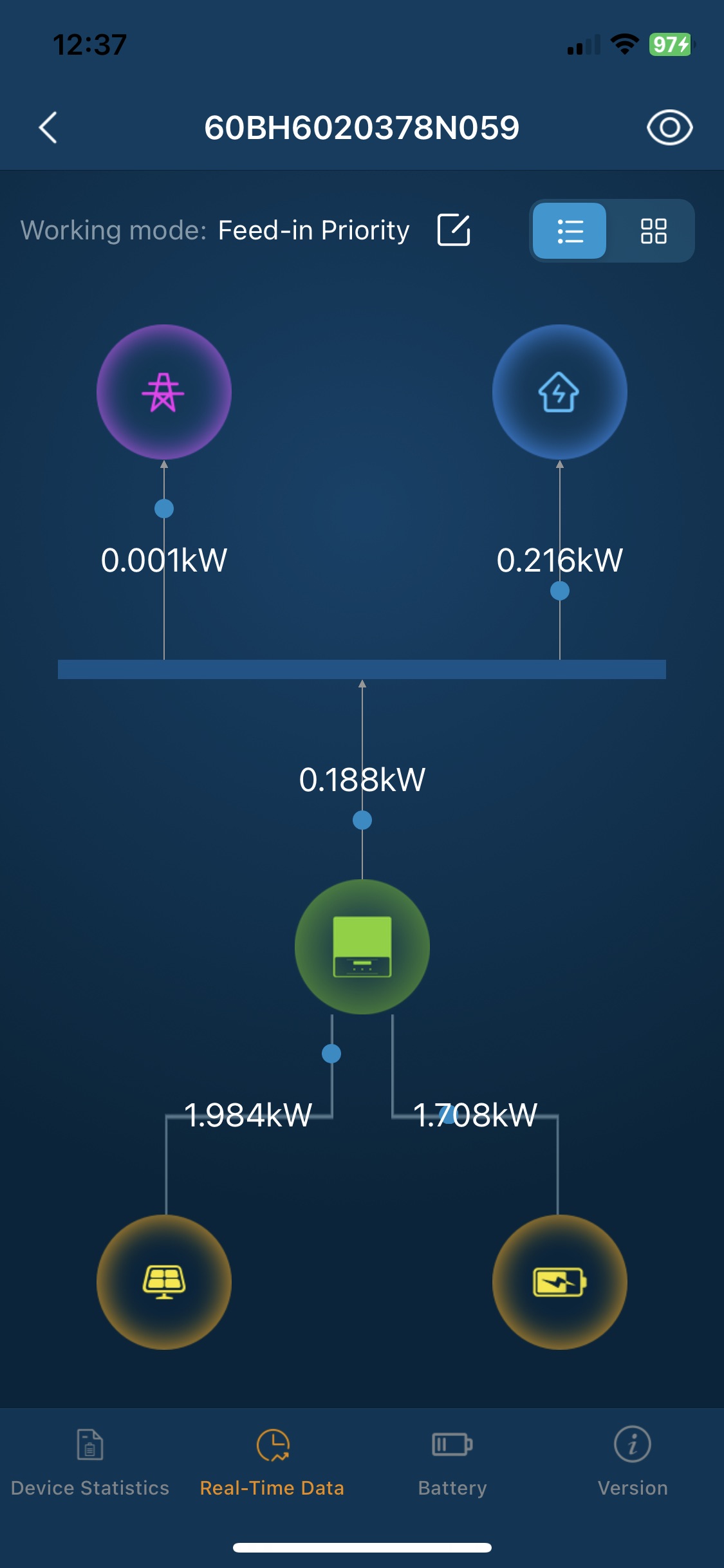

Whichever Working Mode I set (Self Use or Feed-In Priority) there is never any Feed-In
This is what it looks like while in Feed-In Priority:
When Working Mode is set to Self Use, priority still tops up the battery, with the amount of PV generated reporting as steadily decreasing as battery approaches 100%, at which point the PV tracks the amount of power being used by the home.
Does anybody have any suggestions on whether there is a known issue (eg. I'm using a known bad firmware version) that can be fixed at my end, or does it look like I need to contact the installer as they have not done something correctly?
