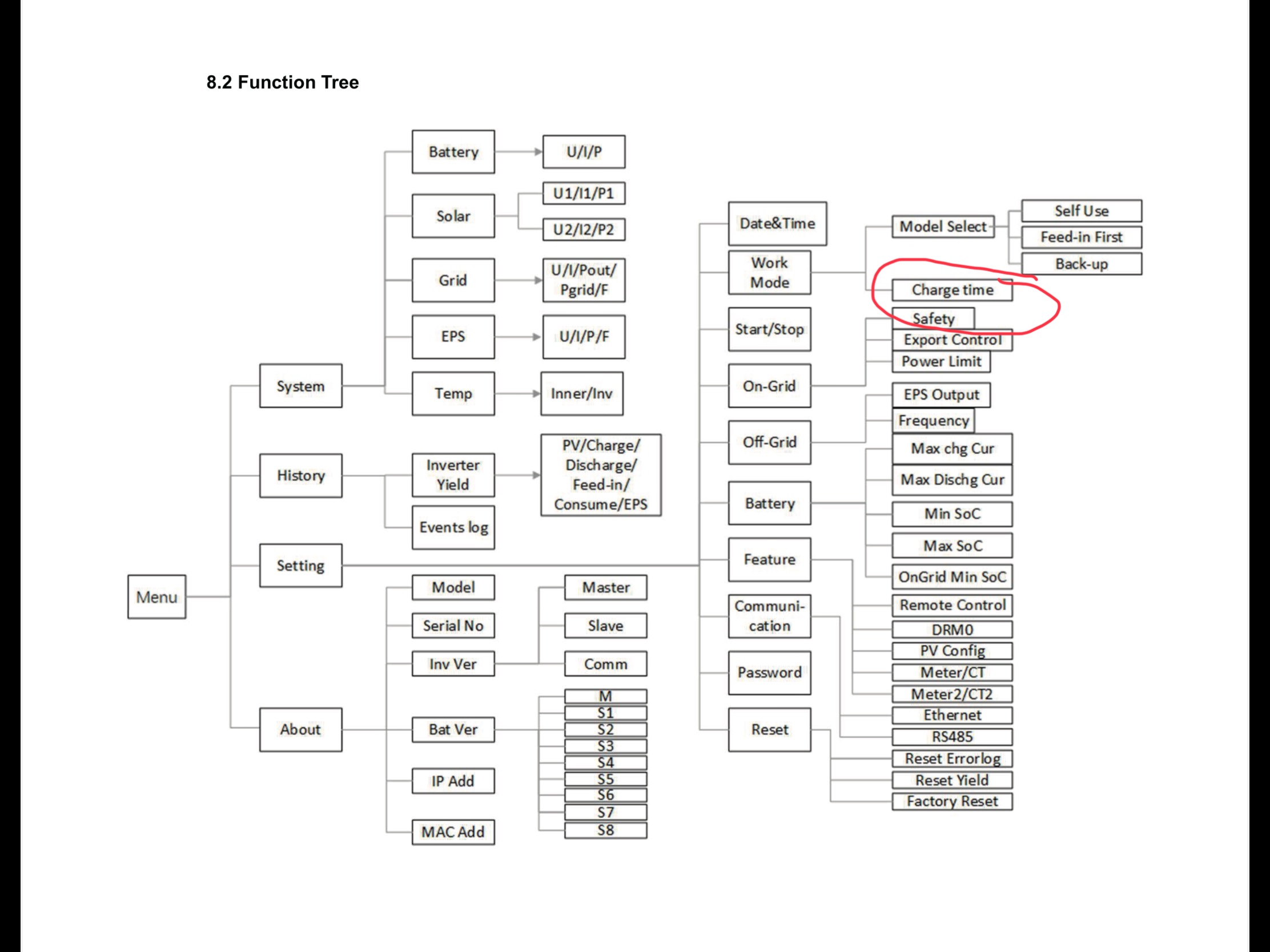

Failing access via the website, you can change the charge times at the inverter panel in Settings, Work Mode, Charge Time (the inverter passcode is usually 0,0,0,0).
Make sure that the times are 00:00-00:00 and P1/P2 are set to Dis (disabled) and that should bring your batteries on-line, you can then set a charge period for overnight charging with P1 set to En (enabled).

Following the advice above, I managed to reset the charge times directly at the inverter, but not being able to set these in the app is a real pain.
