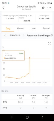

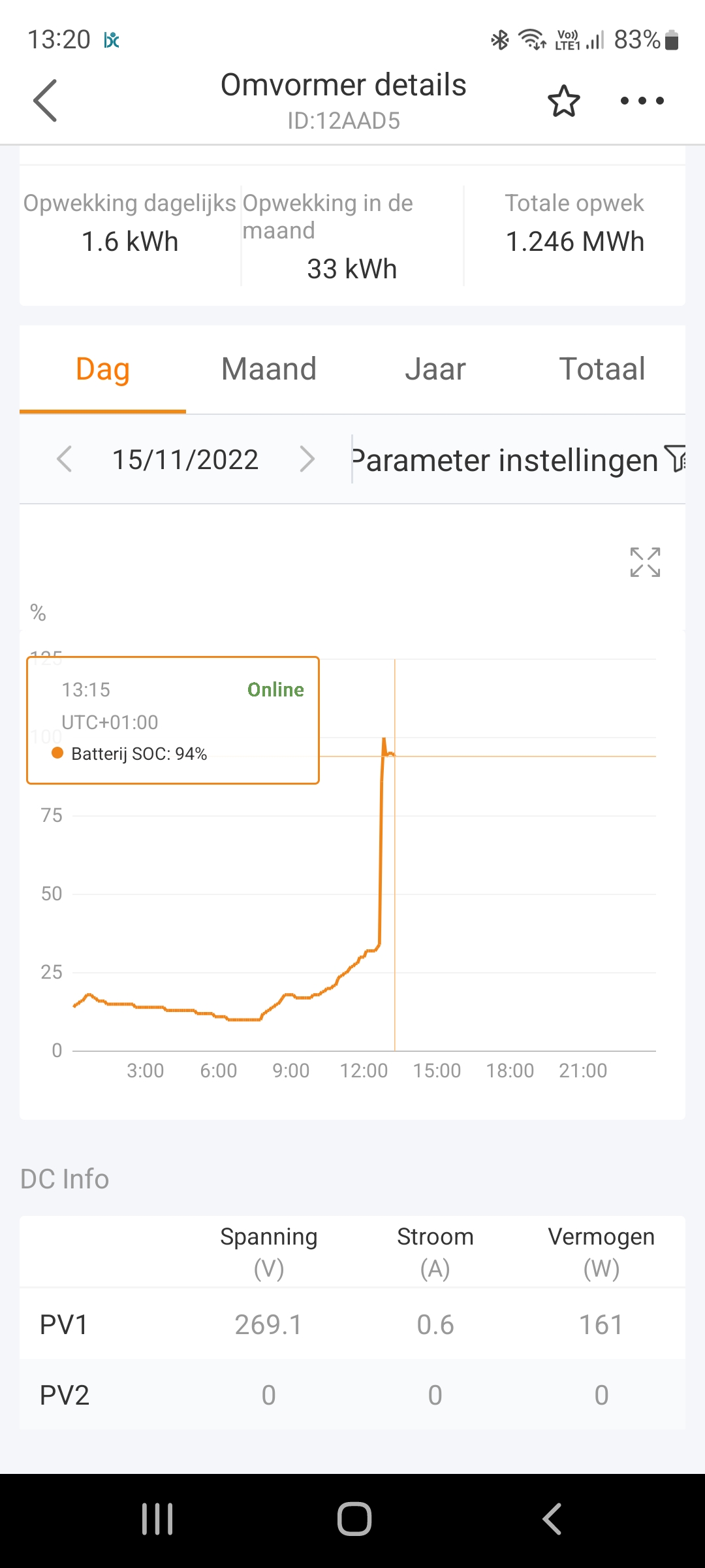

I have a Solis hybride inverter since july, and added a second LV5200 battery last month.
I noticed during charging the leds on the batteries are not the same. The master battery indicaties...40 to 60%, the slave battery 60 to 80%.
As result, the Solis inverters jumps all of a sudden from 70 percent to 100% (after a sudden rise in battery voltage)
I suspect the 2 batteries are not in balance. Anybody any idea´s how to solve this?

Somehow when the batteries are empty (according Solis), I can see the main battery one led blinking, so between zero and 20%, but the other battery is between 20 and 40%.
Yesterday it jumped from 35% to 100% on Solis. And we discharged it completely over the night, it looks like we discharged almost 8 kWh?
It is a strange situation.
