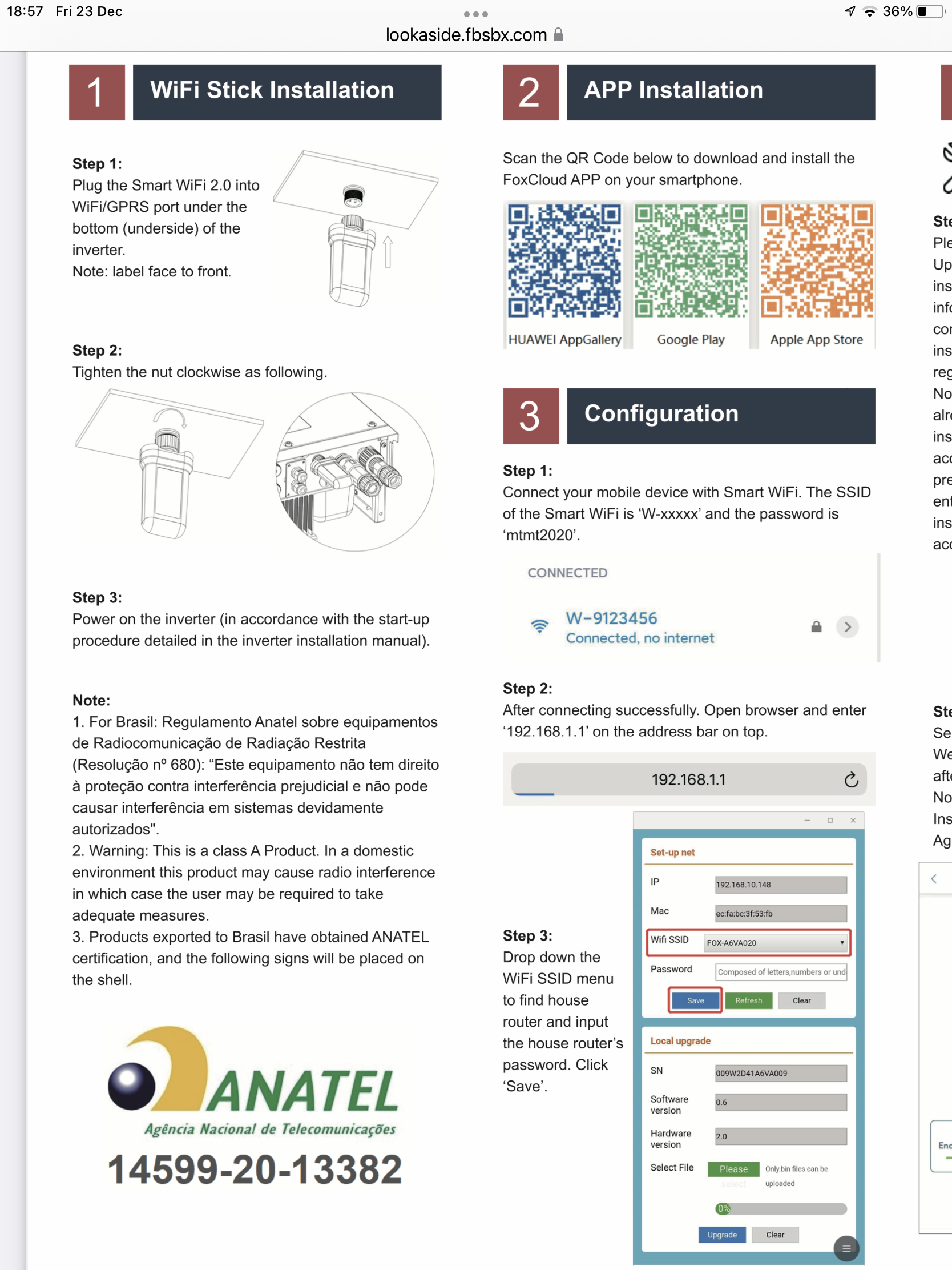

I’ve attached the guide for re-connecting the wifi dongle to your routers wifi below, follow it from step 3 - You would expect the red light to flash slowly with the occasional green pulse.
Before doing that it might be worth resetting your router (power off/on) and see if the dongle re-connects, otherwise follow the guide from step 3.
