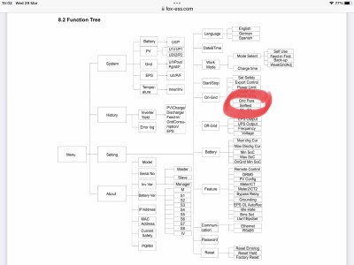

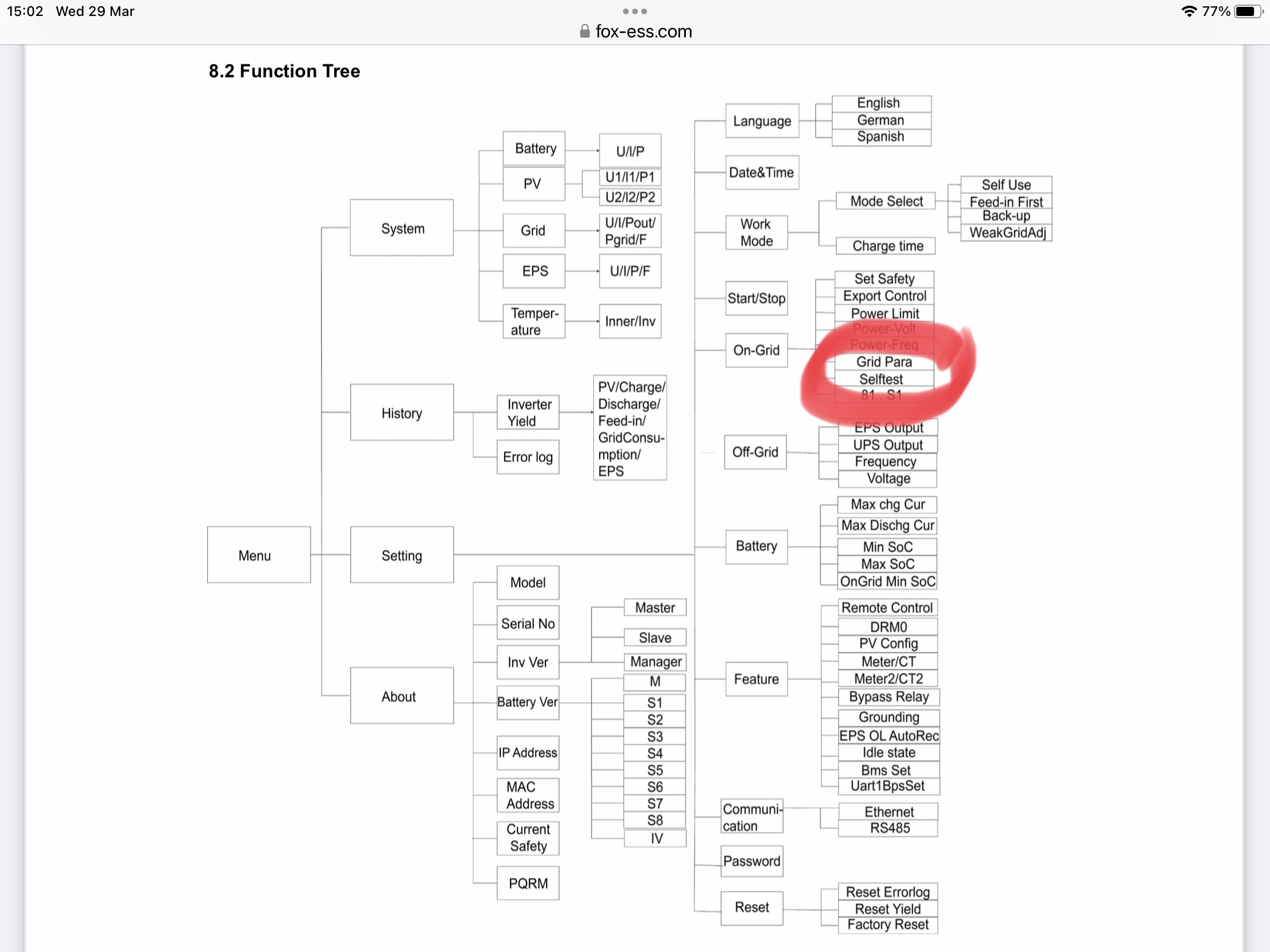

Is it an H1 or H3 inverter,? you can find the option for that in the menu under Settings, On Grid, Grid Params and at the bottom of the list is 10minavg
