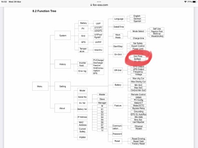

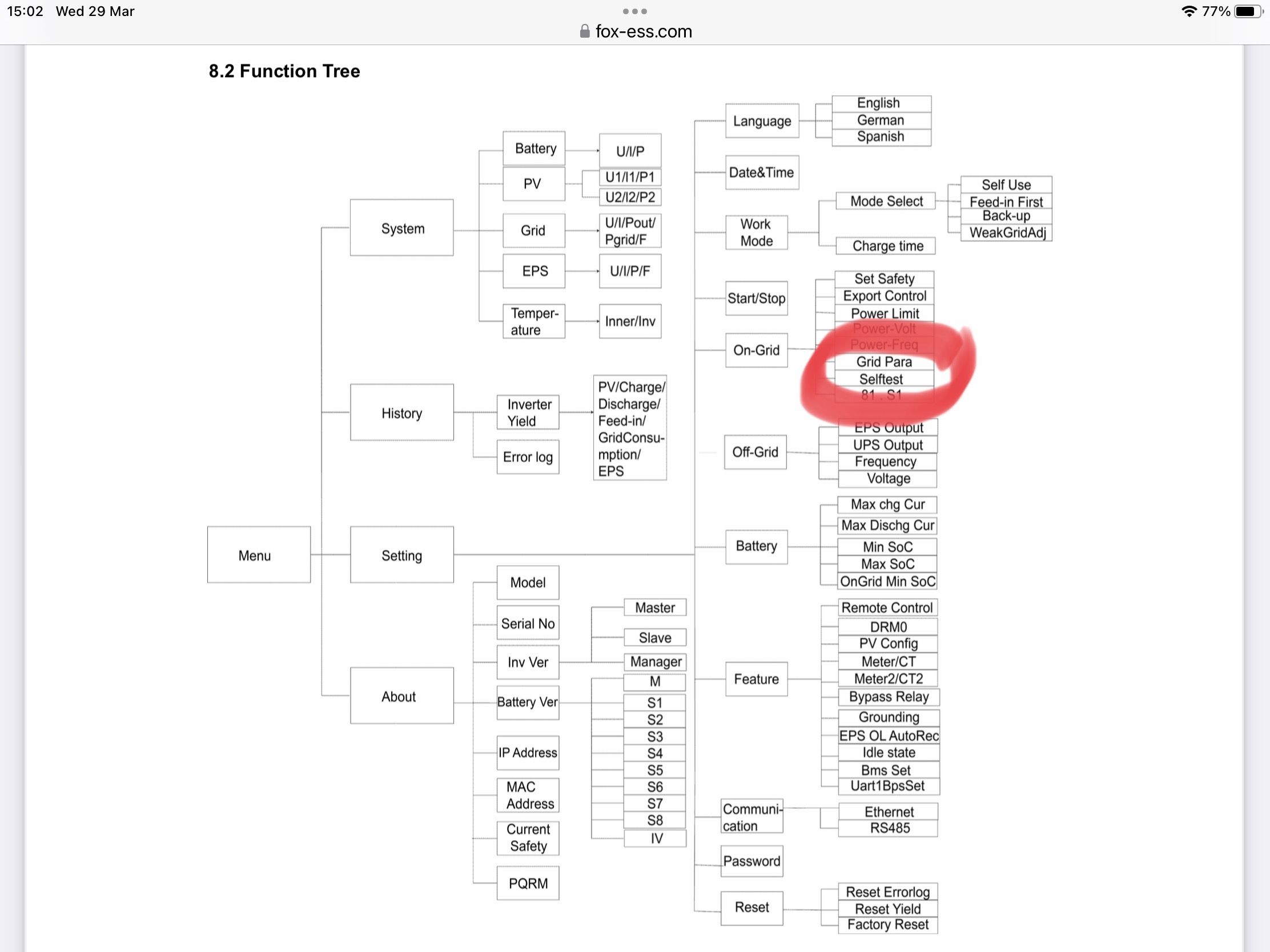

Lowering power limit will reduce the output power which may reduce your voltage slightly when it nears maximum output - you need to change the 10minaverage voltage.
Is it an H1 or H3 inverter,? you can find the option for that in the menu under Settings, On Grid, Grid Params and at the bottom of the list is 10minavg
