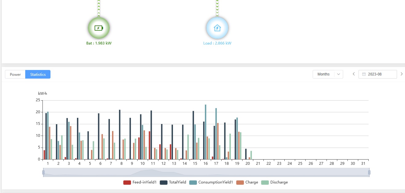

Can you only see this in the little graphs? I can see the total yield but would like to see how much has been exported total?
    				    			If you click on the 'Statistics' tab, you can see Feed-In-Yield1 which is the total you have exported for the period selected either day, month, or yearWolfenden12 wrote: ↑Sat Aug 19, 2023 6:37 pm Can you only see this in the little graphs? I can see the total yield but would like to see how much has been exported total?
