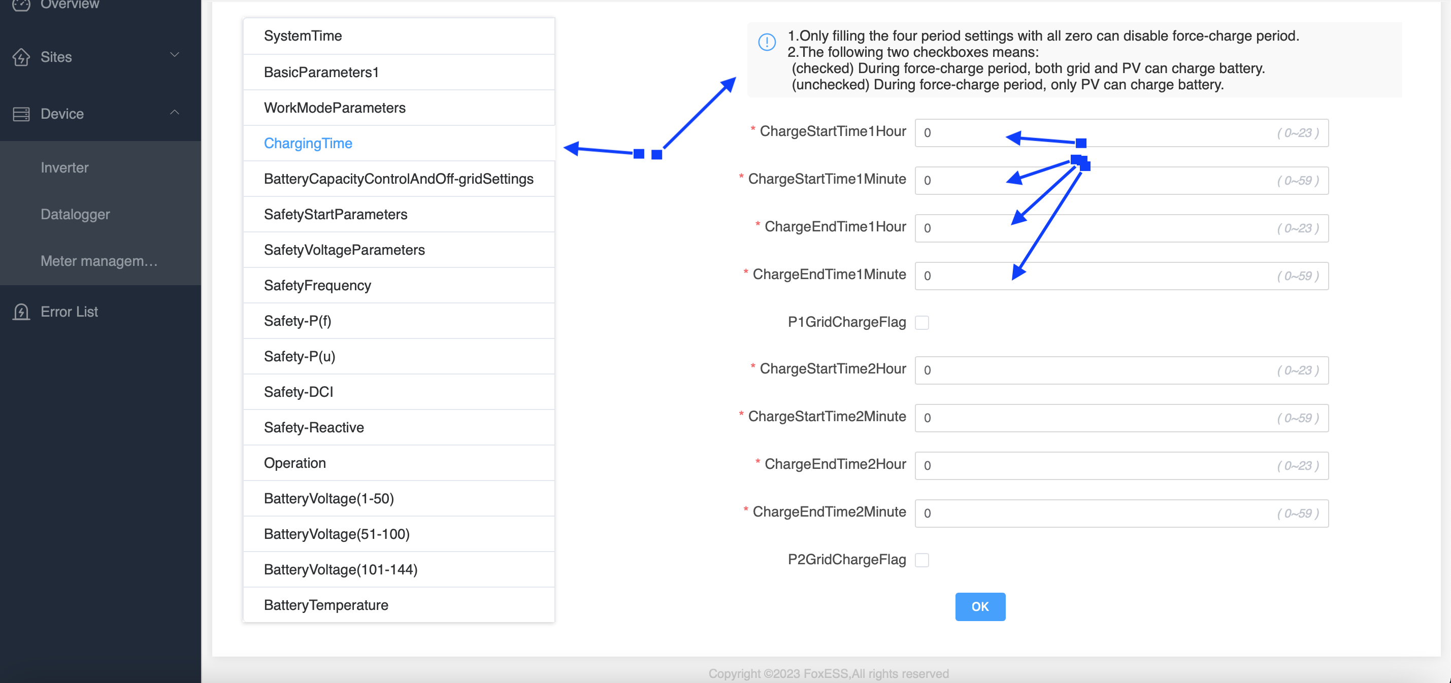

Hi all,
in a similar situation I found out that you need to have the ChargingTime all 4 parameters exactly down to zero. Even if the functionality is disabled. See the screenshot with the warning on top. This is how I fixed my battery not discharging.
Hope it helps other user.
ps: It can also be done directly in the inverter.
KR, ptrin
KR, ptrin
