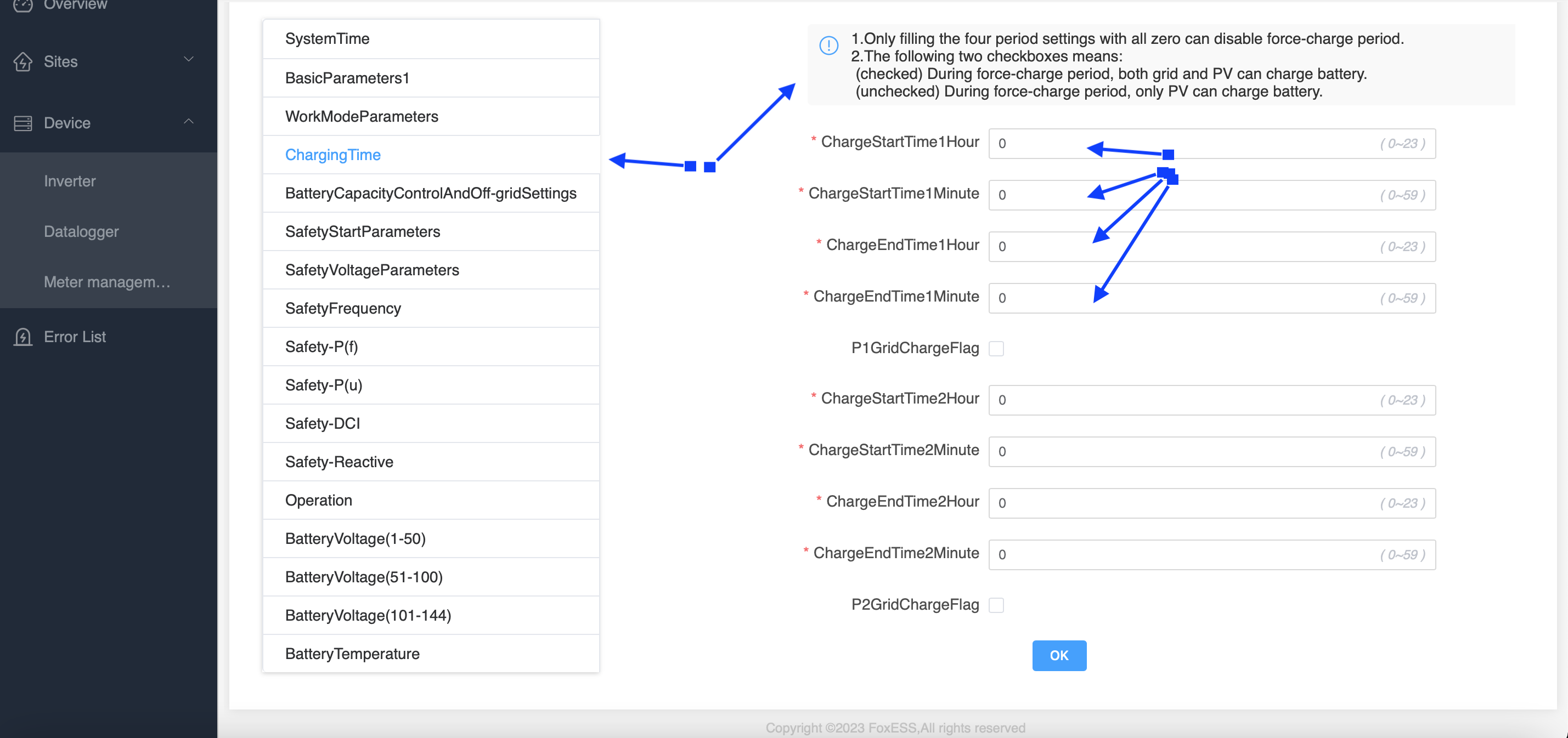

Hi all,
in a similar situation I found out that you need to have the ChargingTime all 4 parameters exactly down to zero. Even if the functionality is disabled. See the screenshot with the warning on top. This is how I fixed my battery not discharging.
Hope it helps other user.
ps: It can also be done directly in the inverter.
KR, ptrin

No I've still not got to the bottom of it. The firmware has just been updated (I'm not sure how) but doesn't seem to have helped.
And my charging times are already set to 00:00 unfortunately, tried that before! But thanks.
