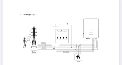

According to manual I found its a 3 phase inverter and only works with a meter.

Does that make sense ie do you have three phase power at that location?
