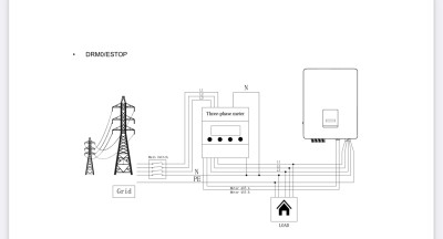

Looking at the installation manual for the G3 inverters, it doesn't look like there's any mention of a CT clamp like with the installation guide for the inverter just posted. Anyone know what's different there?
Looks like the G3 uses a meter rather than a CT clamp to measure current going in and out (see section 6.3). @Lingmops, I'm not sure exactly which one you'd need, something to talk to your installer about.
EDIT: At a wild guess something like this ? https://www.acrel.uk/acr10r-energy-mete ... erter.html
So I guess I have to figure this one out without them
At a guess, something like this https://www.eastroneurope.com/products/ ... modbus-3k7 could work, it would need to be wired into your incoming supply and also connected to your inverter, but that should then let your inverter "know" and log how much energy is going in or out.
The wiring itself would be straighforward for any electrician, but you might want to find a supplier and give them a call to double check suitability before buying. I have no affiliation with or knowledge of these folks https://aphex-metering.com/product/east ... -v2-meter/ for instance, but that's the kind of company I would call for advice (in the knowledge that I'd feel honour bound to buy whatever device they recommended in return!)
According to manual I found its a 3 phase inverter and only works with a meter.
Does that make sense ie do you have three phase power at that location?
