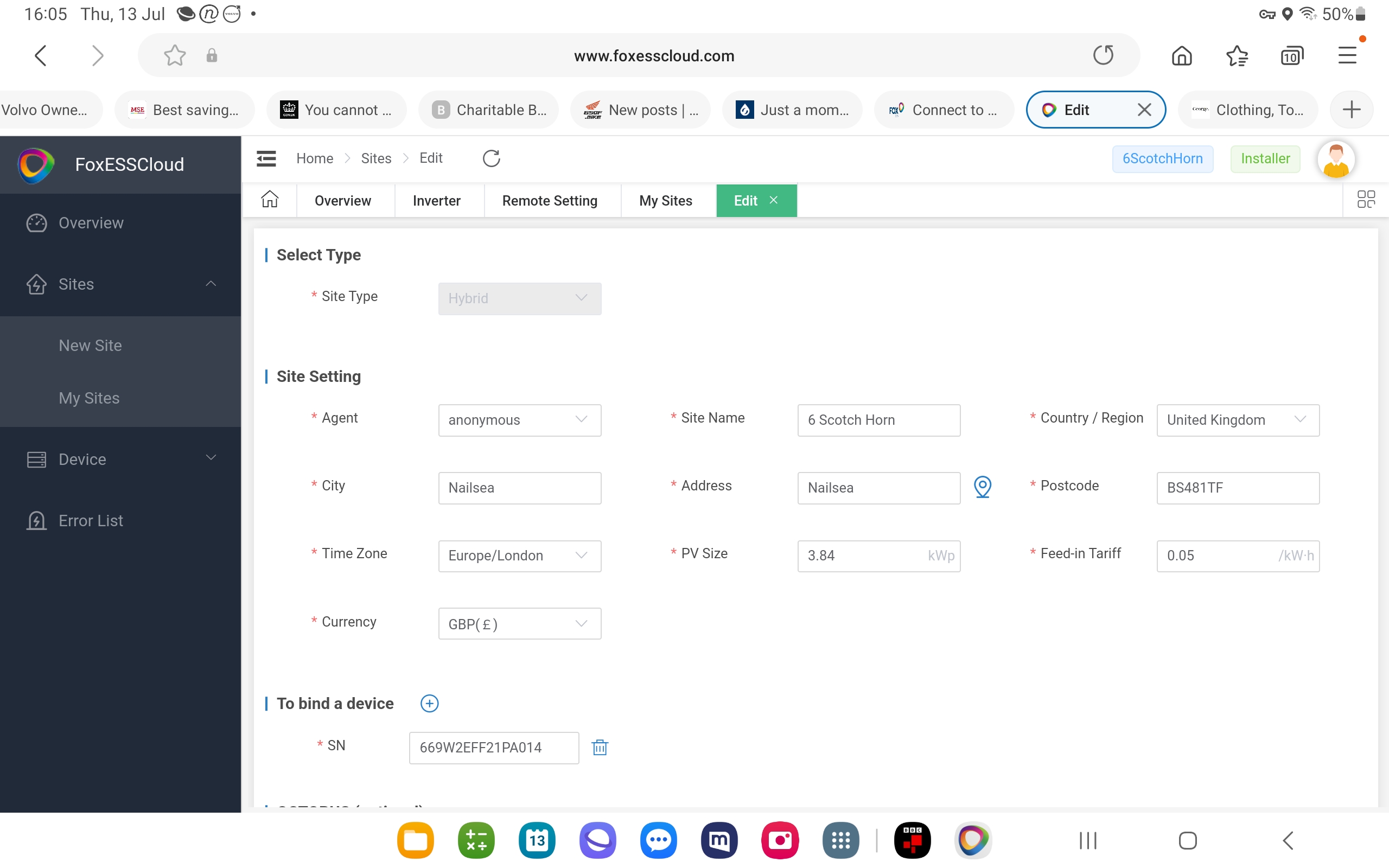

How can I best do this? Prefer not to go through HA. On the foxess cloud page there is an Octopus entry, is this what I need to use?
Do you have a screenshot? I've not seen that myself, not that I'm on the Fox Cloud website all that often.

I can't see it in your Screenshot but it looks like it's just below the lower edge, I've found it in my own view now.

The 'To Bind a Device' section needs to be completed in order for me to save and exit the page - can someone help me with what this info is and where I would find it?

I believe that is the serial number of the Wifi datalogger that's plugged into your inverter (with the red flashing light)The 'To Bind a Device' section needs to be completed in order for me to save and exit the page - can someone help me with what this info is and where I would find it?
