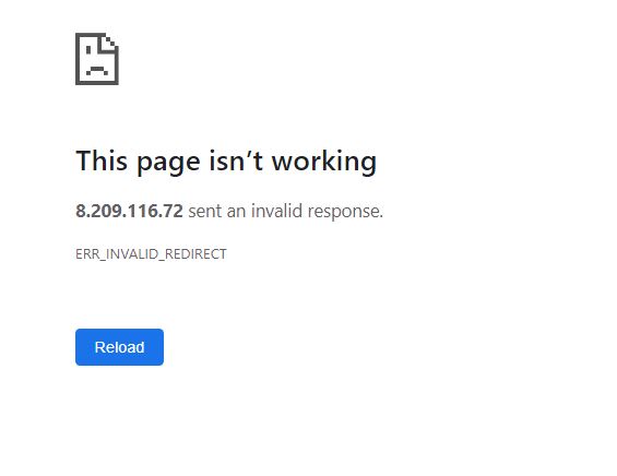

You can check here but the site itself is working, this looks to be an issue with your DNS resolver. Can you get to http://8.209.116.72 in your mobile browser?

Thanks for your response, no I have not been able to access the url you provided - please see attachment.
VPN is off..

The app and website work fine on my phone which is Android 13, so that's not the issue. I'm pretty sure the issue is that the DNS on the phone you have the problem with has got messed up somehow.
Weirdly the site doesn't like being visited via the IP which suggests some sort of shared hosting situation. Be that as it may, the site is currently up and working, so the problem is either your phone or your internet connection. As you have another device that does work, it very much suggests the problem is with your phone.
Have you changed settings on your phone eg set a custom DNS or whatever? Does it have any anti-malware apps that might be triggering a false positive block?
