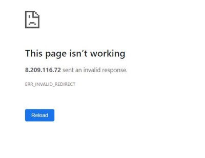

You can check here but the site itself is working, this looks to be an issue with your DNS resolver. Can you get to http://8.209.116.72 in your mobile browser?
Judy01
Posts: 20
Joined: Thu Sep 28, 2023 7:50 pm
Thanks for your response, no I have not been able to access the url you provided - please see attachment.
