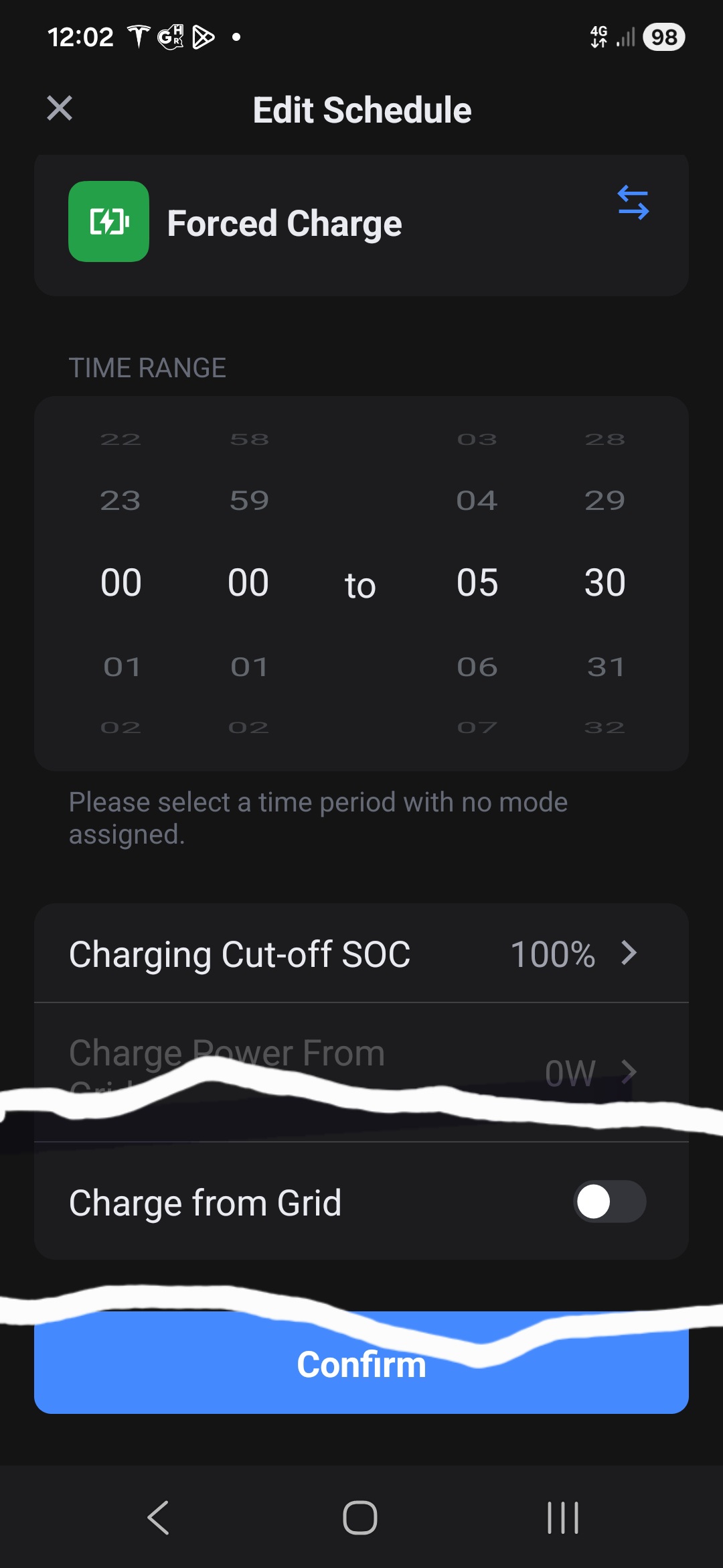

This time of year with sunnier days I would normally set my Batterys to Force Charge during the cheap energy period BUT with the 'Charge From Grid' toggle Disabled.
This means the batterys dont discharge into my car when it is charging but also dont Charge from the grid as the sun is charging the batterys in the day.
This year after an app update this toggle for Charge from Grid is still present but doesnt stop the batterys from charging from the grid. The toggle can be set to enable or disable and it still charges from the grid.

Have added screenshot with Charge from Grid toggle circled.

It doesn't matter if its enabled or disabled it still charges from the grid.

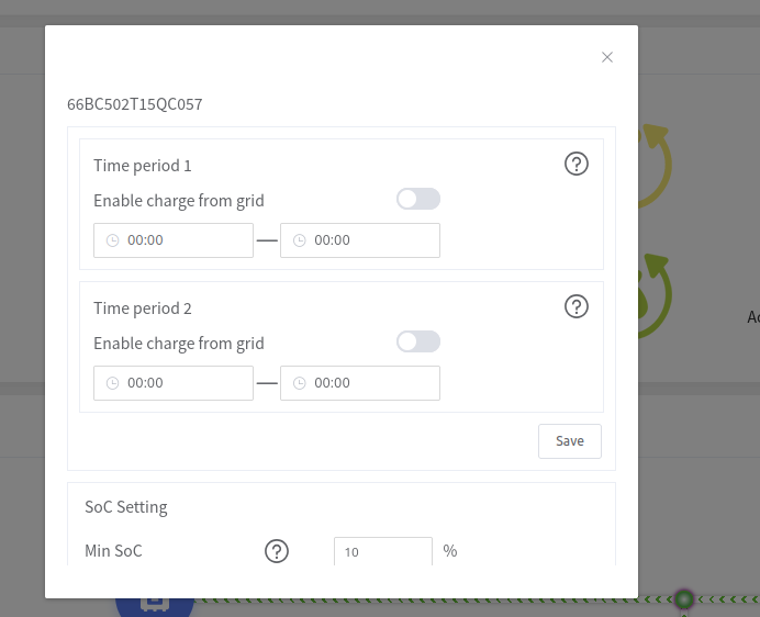

After much back and forth with Foxess Helpdesk, Alex persevered and did a great job, there is a way around this issue.

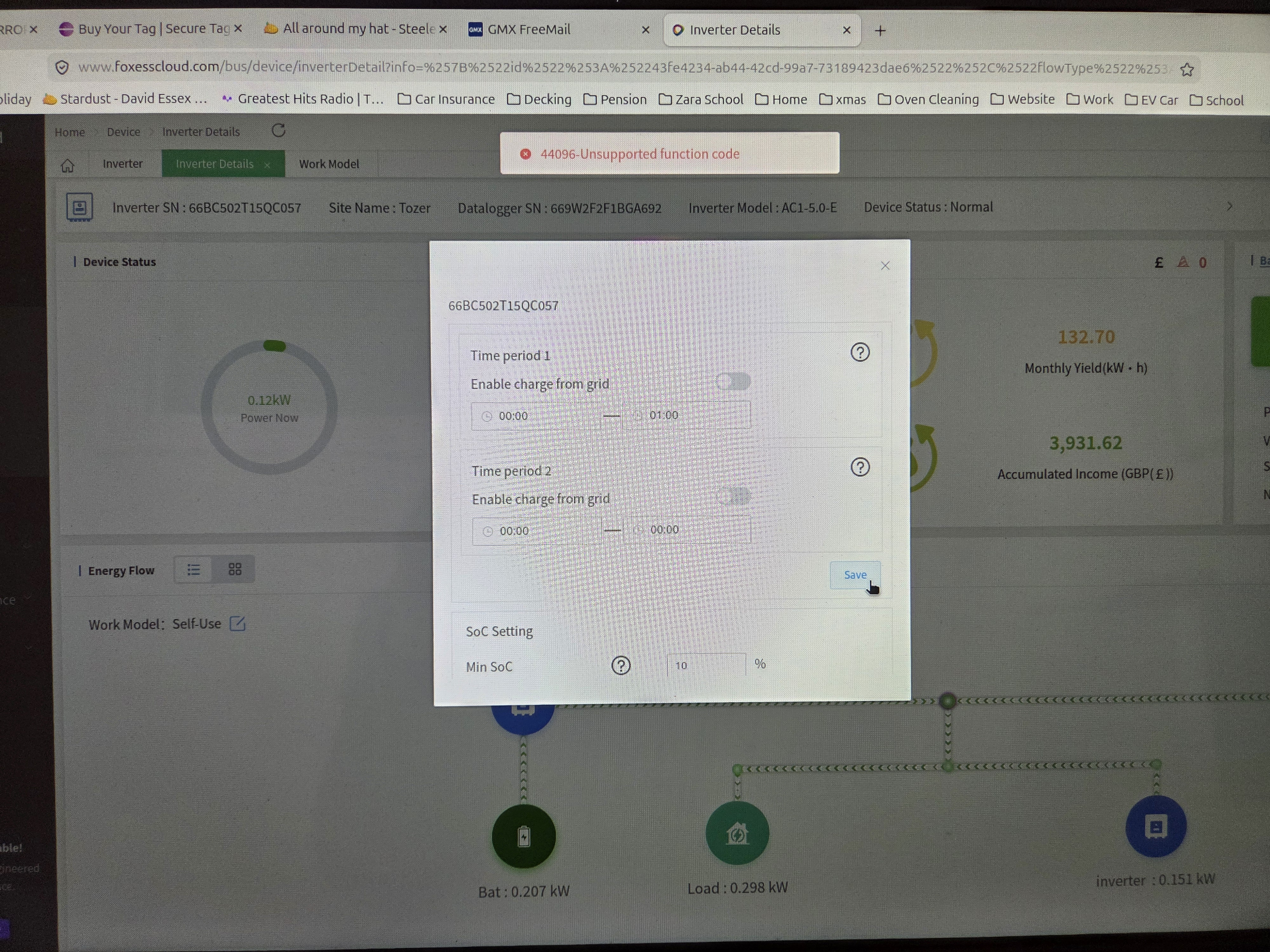

Firstly disable the Work Scheduler in the app - Go to the app - Click on Work Mode - Click on Blue Opposing Arrows in top right corner - select Self Use. This turns off Work Scheduler in the app and prevents the 44096 error when setting the Forced Charge in the Desktop website.

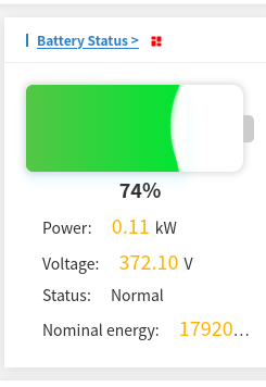

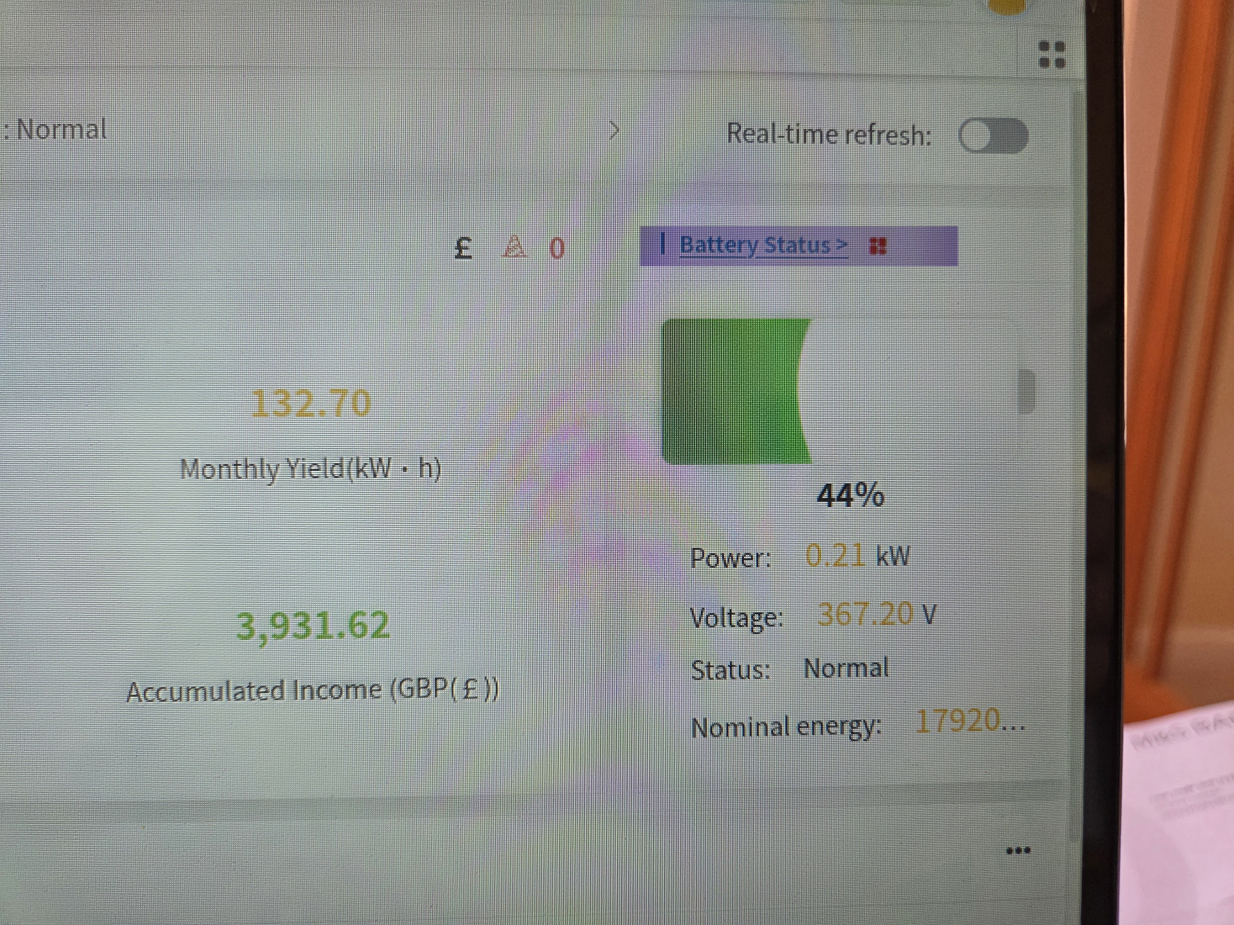

- Using Version 1 Desktop foxesscloud.com go into your Inverter Details screen
- Click on the Red Bubbles to the right of Battery Status
Screenshot from 2026-05-06 09-51-09.png (19.25 KiB) Viewed 42982 times

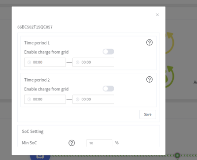

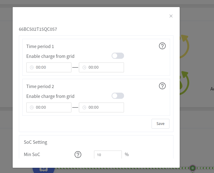

- A window will open to set your times for a Forced Charge
- Set your times
- Enable or disable charge from Grid
- Save
These settings will not appear in your app
If you get a 44096 error its because your Work Scheduler in the app is still enabled or basically not set to Self Use
This is far from ideal and who knows when V1 of the website will be pulled but works for now I guess.
