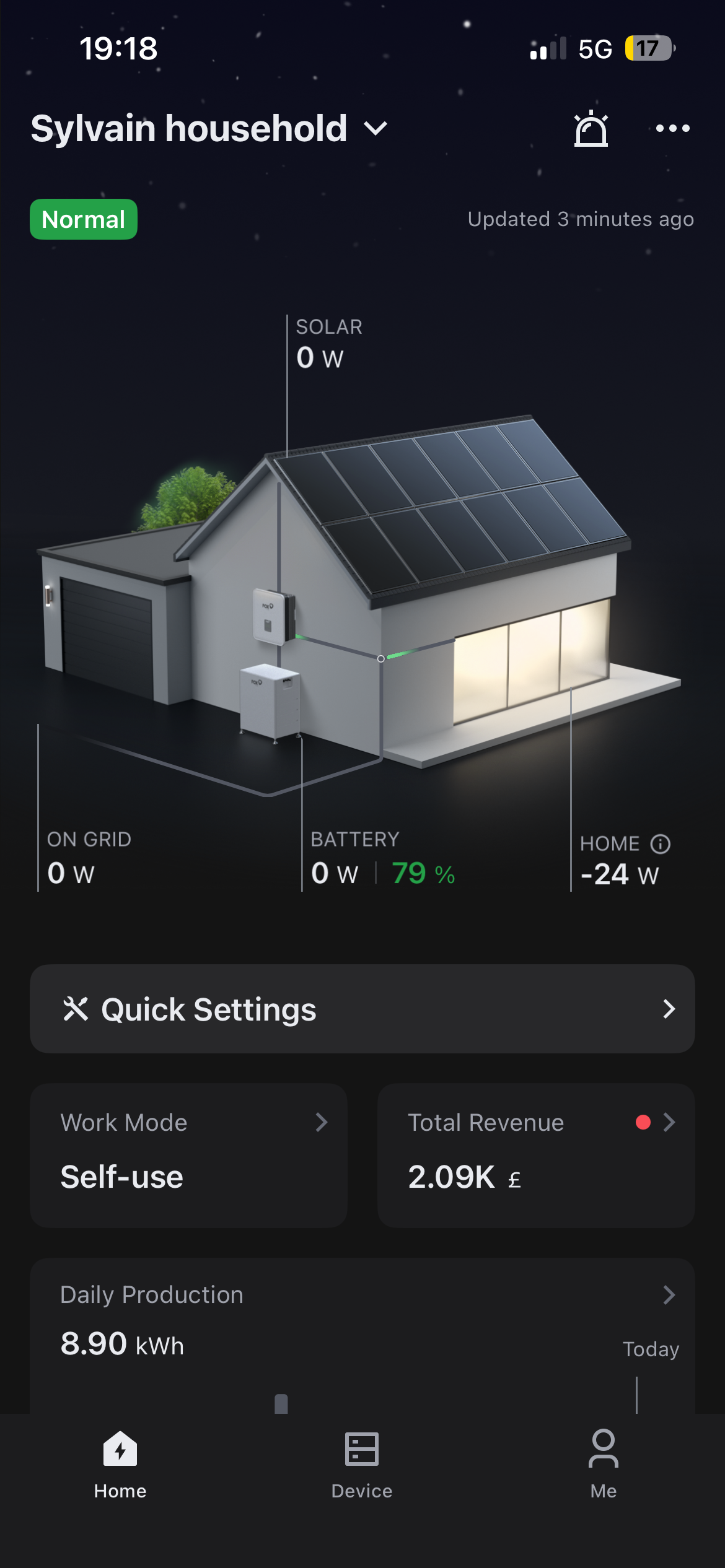

My dongle is flashing red slowly and the app says the dongle, the inverter and the batteries are "online".

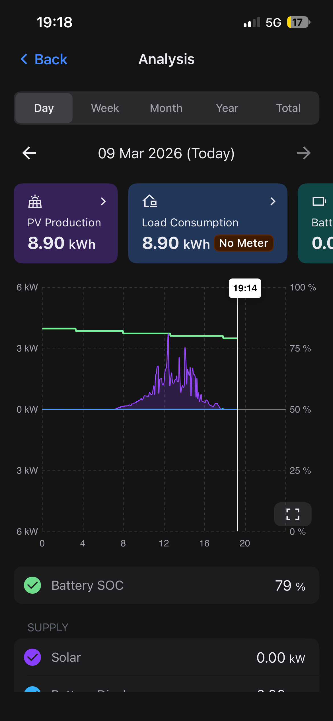

However on the app's home screen, all data (on grid, battery, solar, home) show 0W.
Moreover, the battery seems not to discharge even when SoC shows 80-90% and it is the night (normally during the night, the battery would discharge to cover the home consumption).
I have checked the inverter screen directly and it says the same thing (all data (on grid, battery, solar, home) show 0W, SoC at 80-90%).

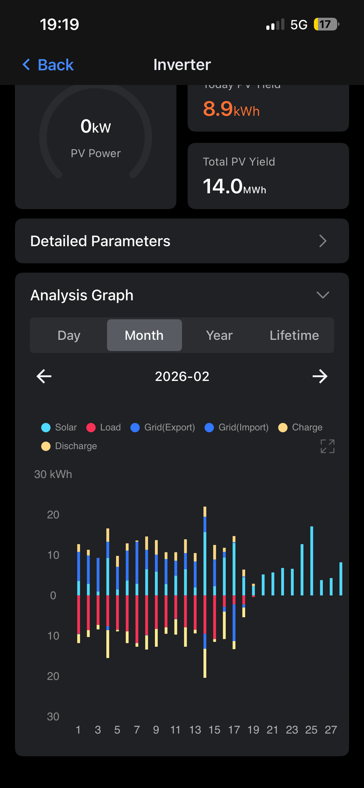

Looking at the historical data, this situation started on 19 February at ~4.30am (it took a while to realise as I was on leave for 2+ weeks).
Other weird thing is that from this date, the battery discharged slowly to 7% SoC and suddenly recharged to 100% on 5 March without any particular reason.
