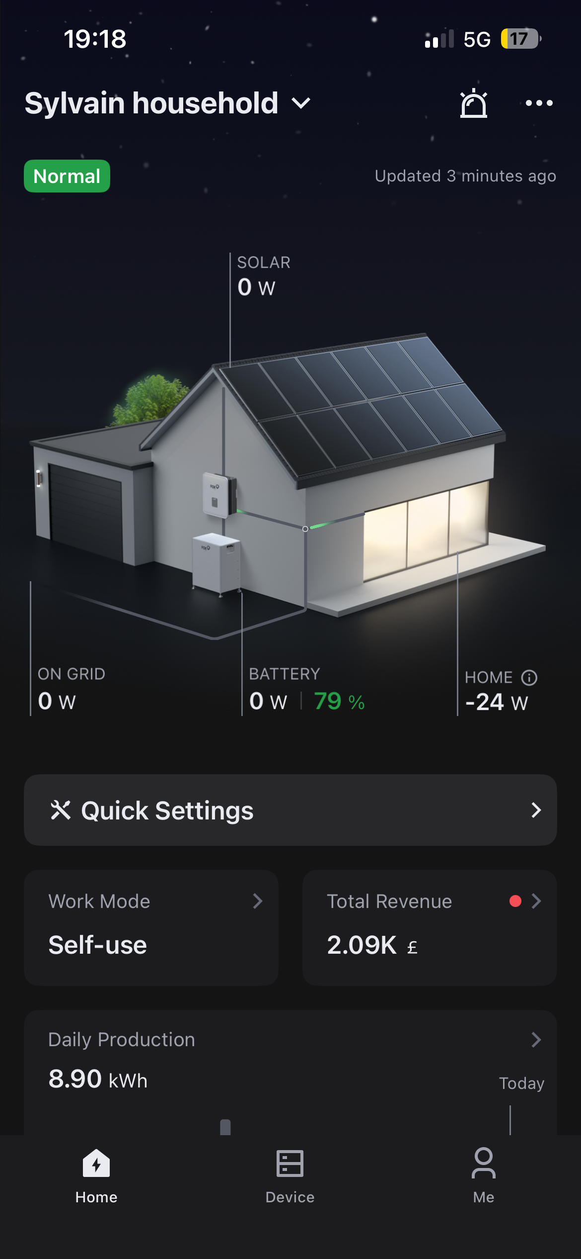

However on the app's home screen, all data (on grid, battery, solar, home) show 0W.

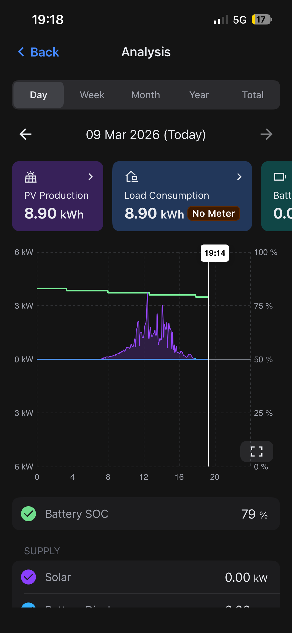

Moreover, the battery seems not to discharge even when SoC shows 80-90% and it is the night (normally during the night, the battery would discharge to cover the home consumption).

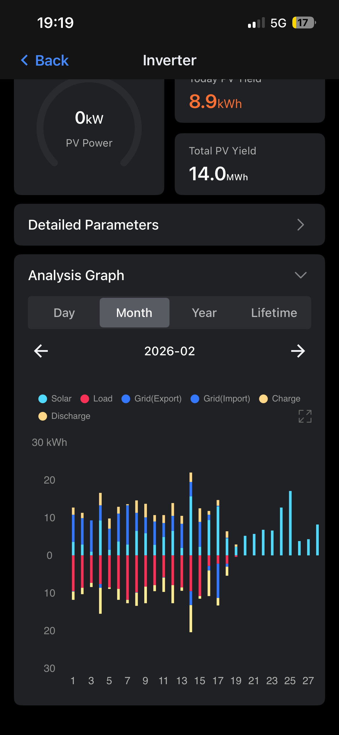

Looking at the historical data, this situation started on 19 February at ~4.30am (it took a while to realise as I was on leave for 2+ weeks).
Other weird thing is that from this date, the battery discharged slowly to 7% SoC and suddenly recharged to 100% on 5 March without any particular reason.
