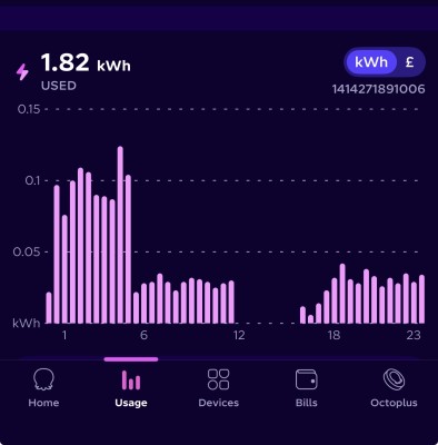

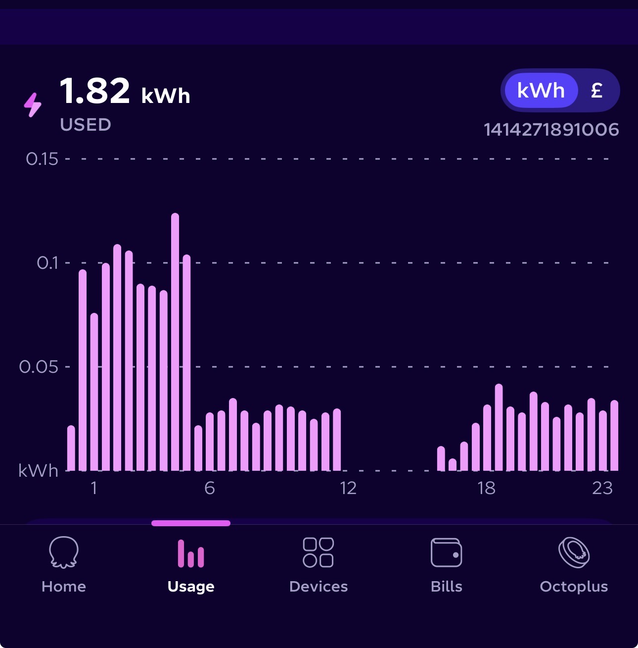

Why does the home still consume from grid when there’s enough charge in the battery? This is while we are on holiday so barely any consumption other than fridge, WiFi, alarm etc.
Is this much “normal”?

Now on the face of your Octopus graph, that is actually quite good in isolation, that represents a house base load of under 100 Watts. Given that you have solar/battery, then it should have been less than 0.5kWh for the 24hrs (it can vary, but lower than posted)

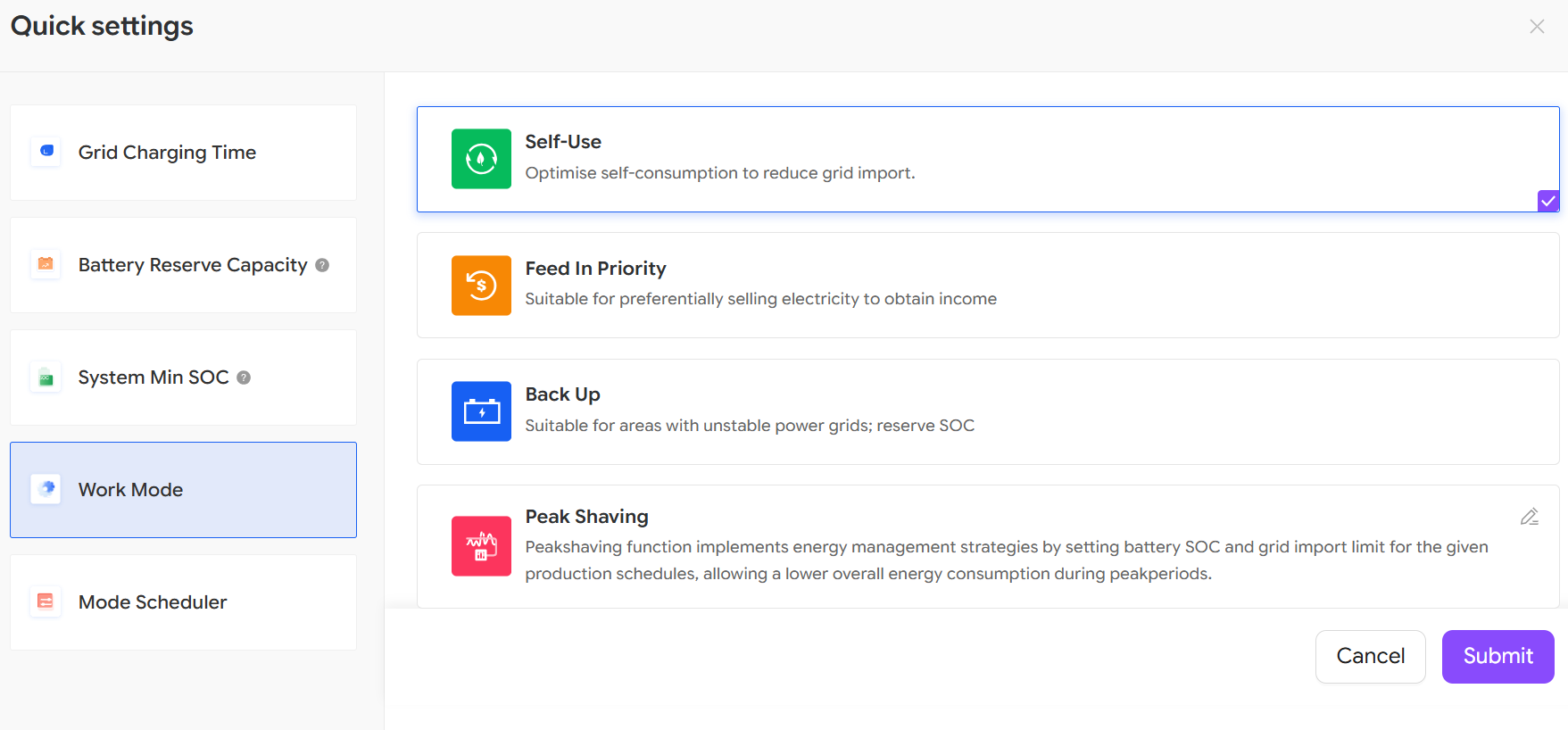

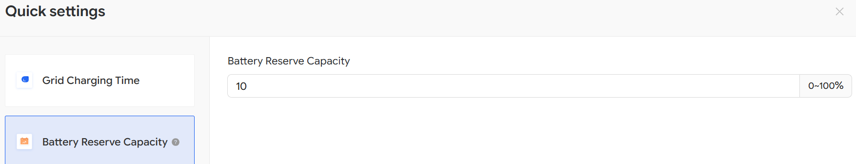

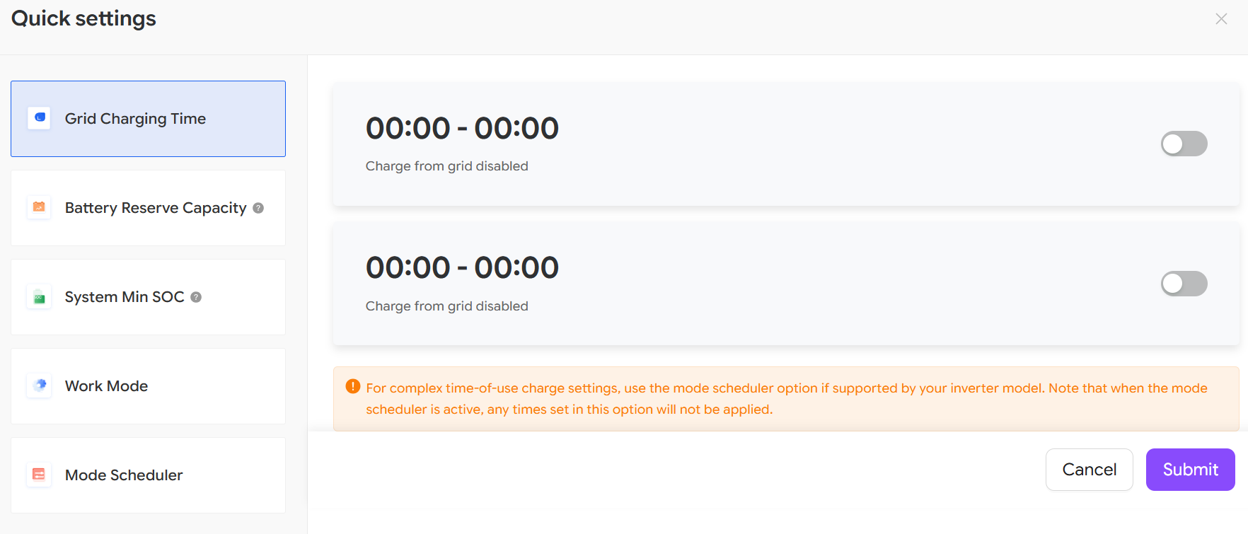

I would recommend you login to the v2 Desktop site here https://www.foxesscloud.com/v2/login
And check the Quick Settings top right in Purple, check each section carefully.
There are 5 sections there, if you can write down what you see, or take pictures more help can be given.

MaterialBarracuda48 wrote: Sun Mar 01, 2026 4:34 pm I would recommend you login to the v2 Desktop site here https://www.foxesscloud.com/v2/login
