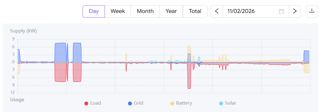

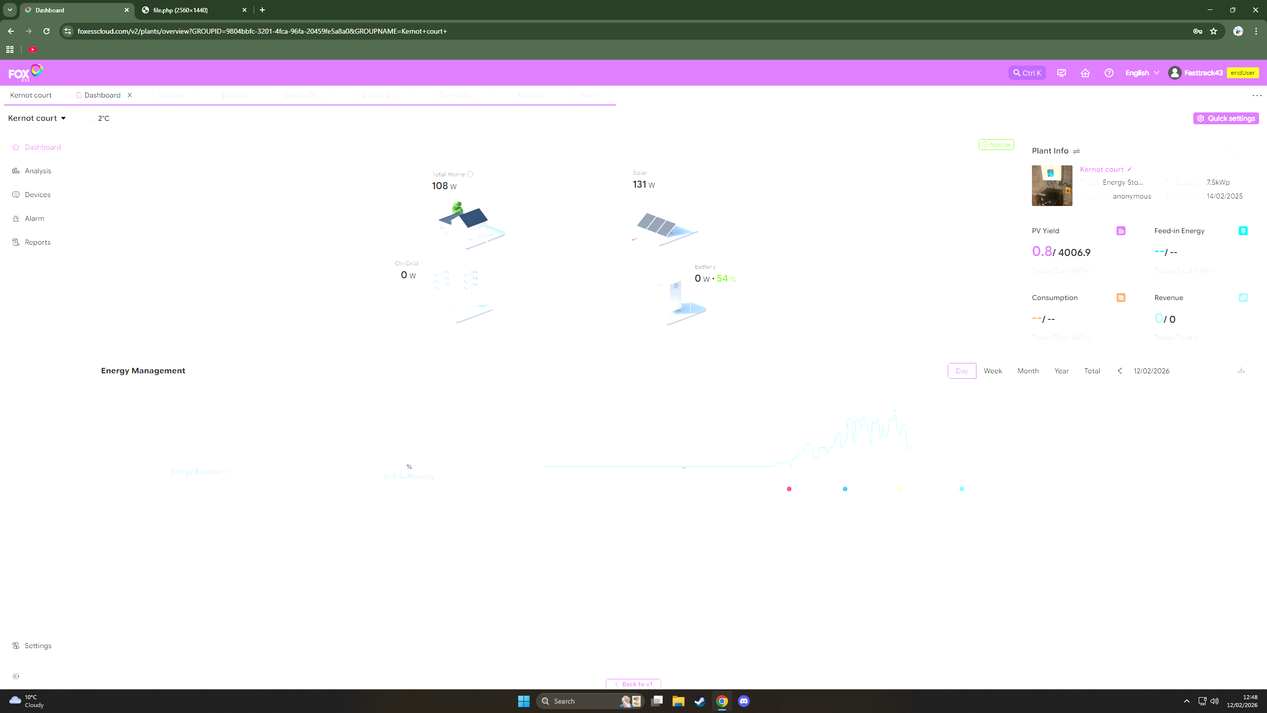

Can you please make a picture for the 11th, so that we can see a full day of data?
This one is from your main page dashboard, bottom right

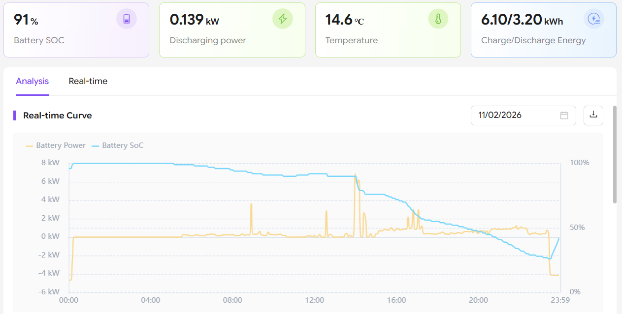

This one is under Devices, Battery
As you can see it will show us your battery input/output for the day, along with a SoC (State of Charge) we can view.

On a surface level, it looks like your overnight grid charge from 02:00 to 05:00 didn't do a thing.
When you get solar, your PV generated is just supply a little power that the house is demanding at the time.
When possible, check those 3x videos and see if you can get the information for the Inverter power limits (Import/Export) and same for Battery (Import/Export)
