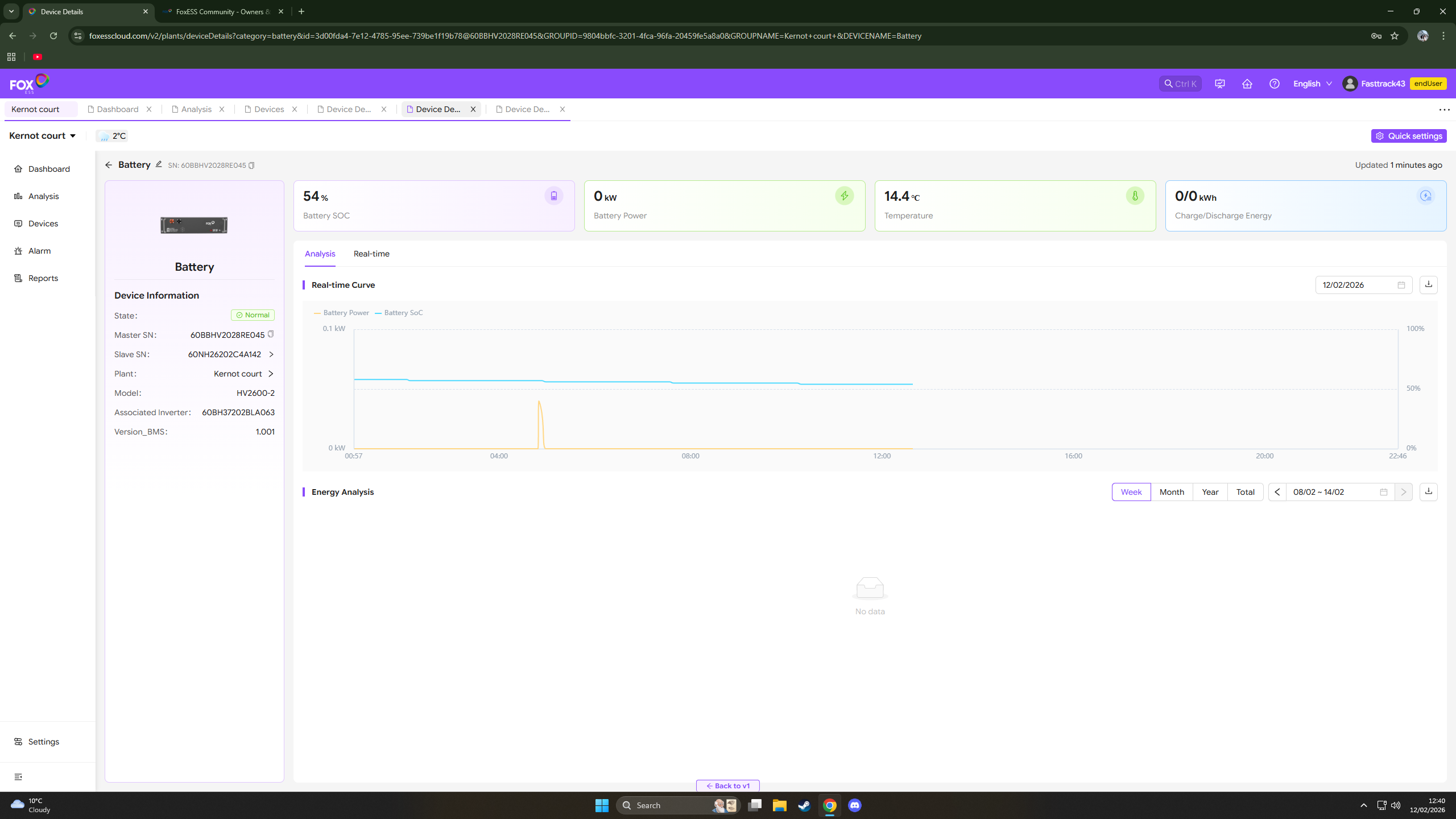

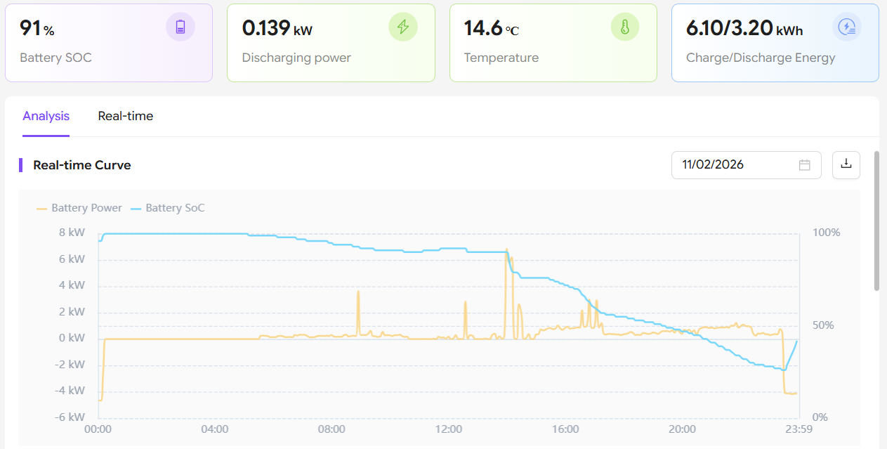

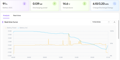

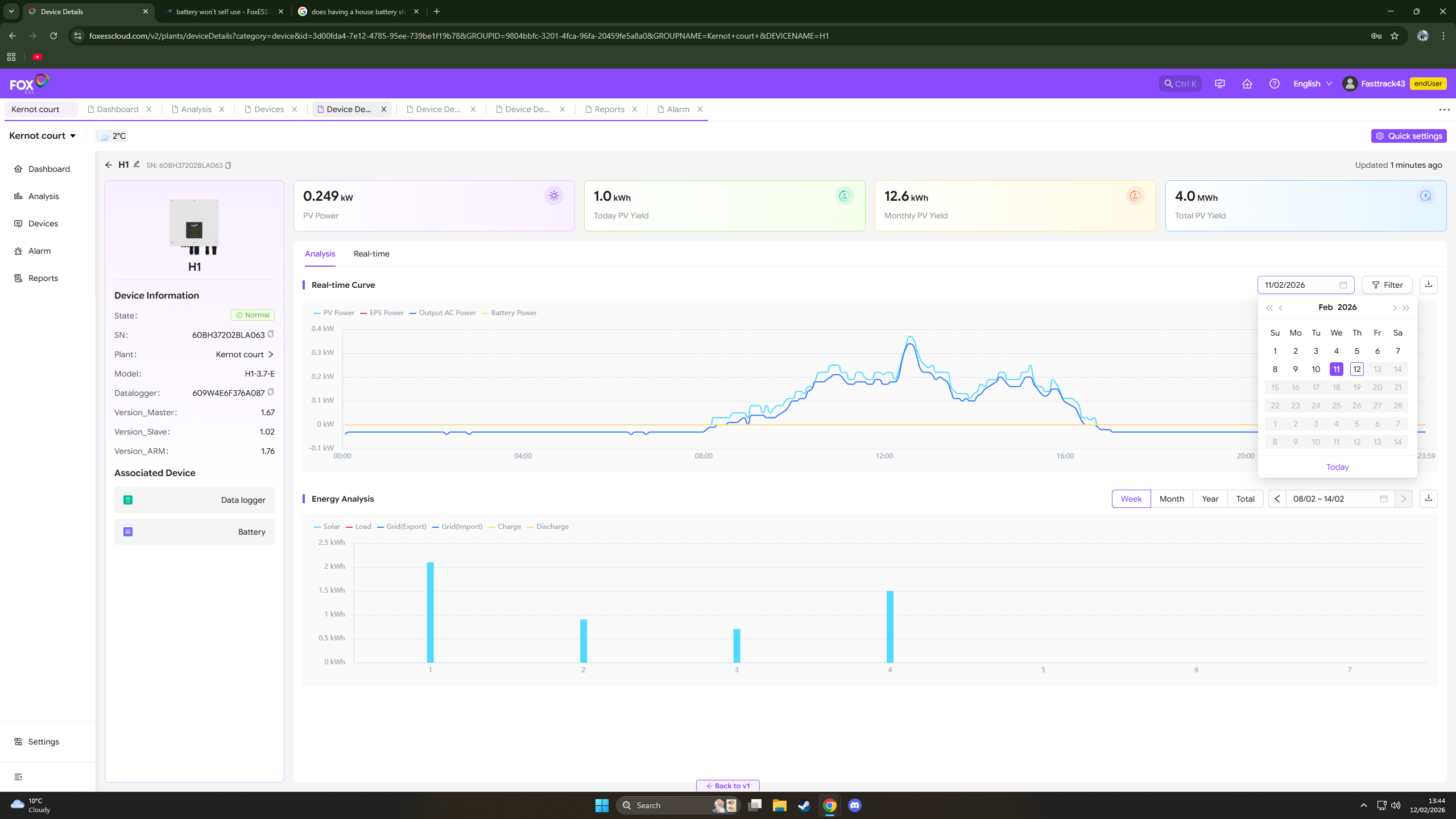

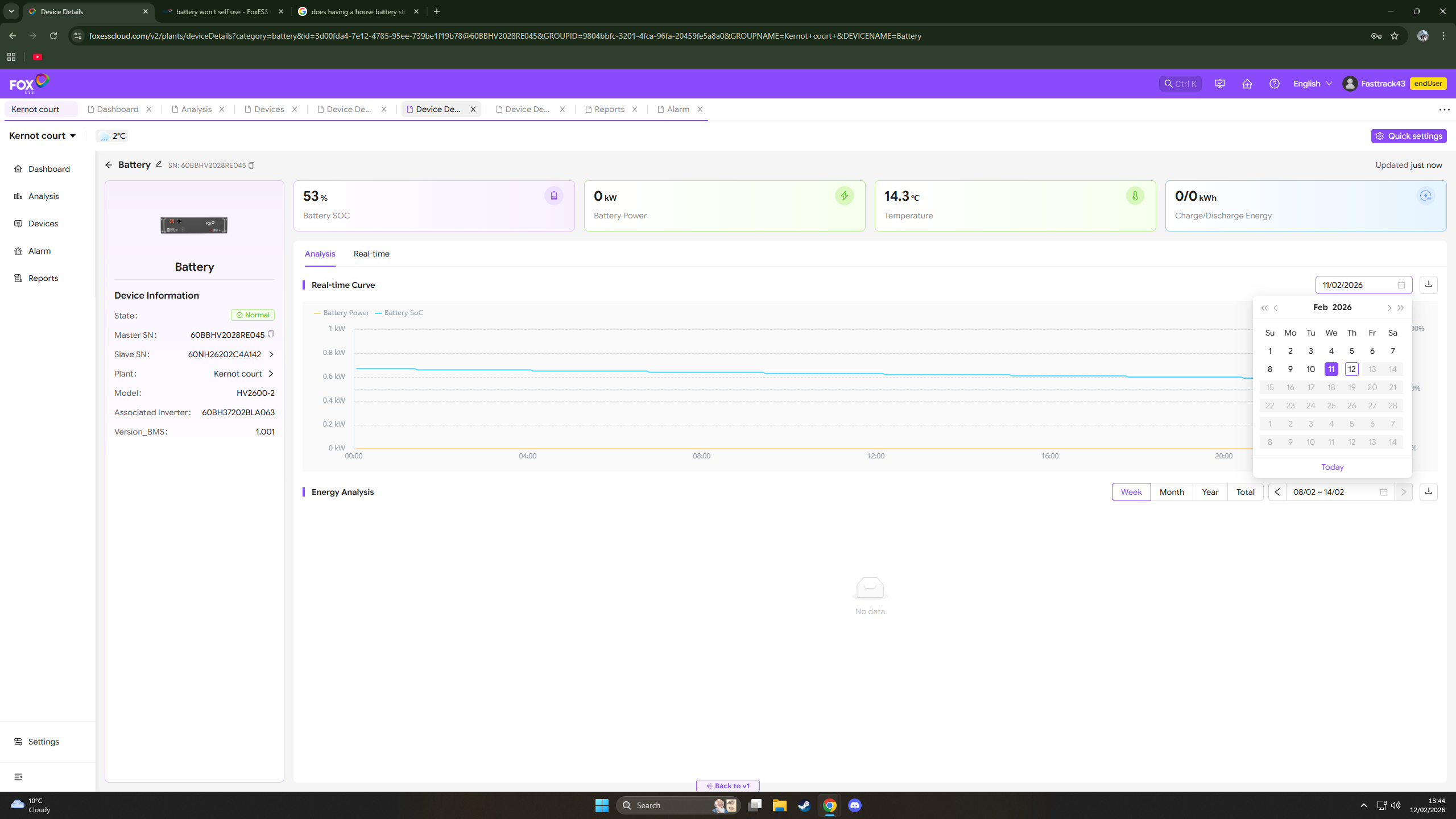

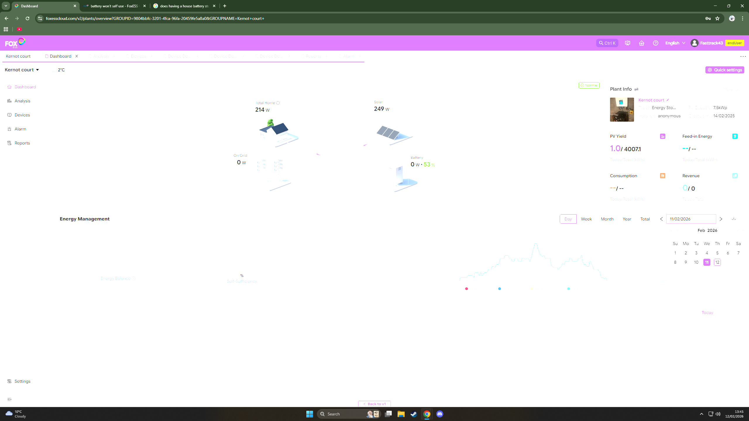

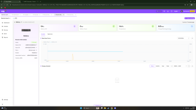

Can you please make a picture for the 11th, so that we can see a full day of data?
This one is from your main page dashboard, bottom right This one is under Devices, Battery
As you can see it will show us your battery input/output for the day, along with a SoC (State of Charge) we can view.

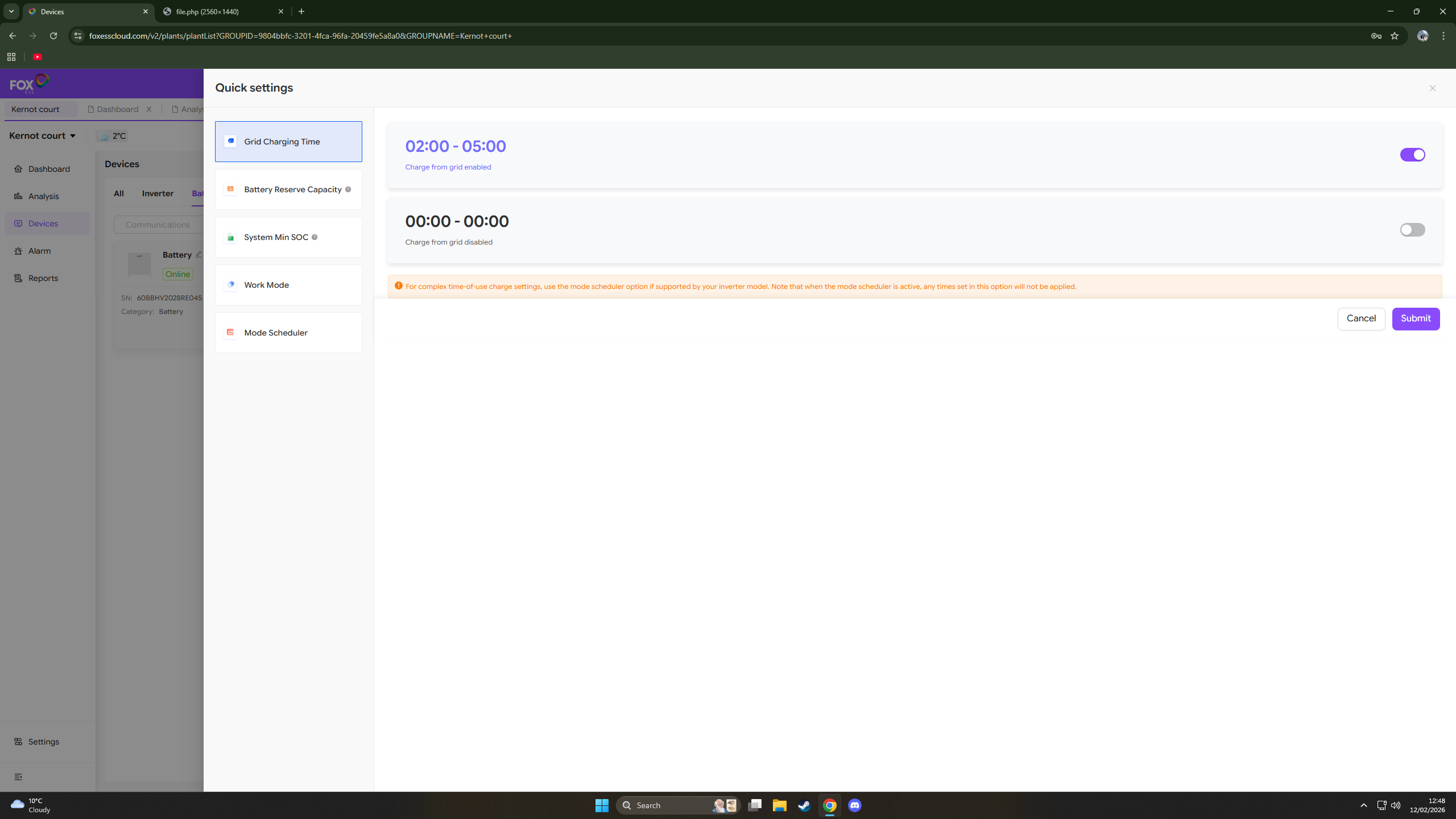

On a surface level, it looks like your overnight grid charge from 02:00 to 05:00 didn't do a thing.
When you get solar, your PV generated is just supply a little power that the house is demanding at the time.

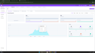

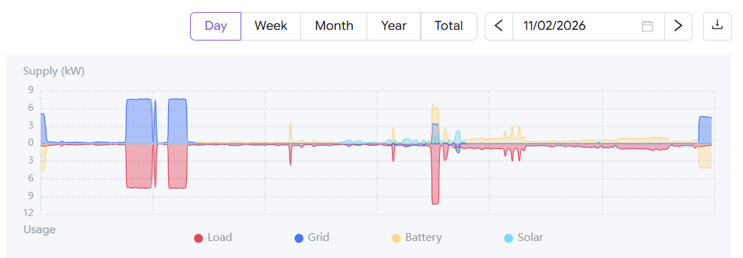

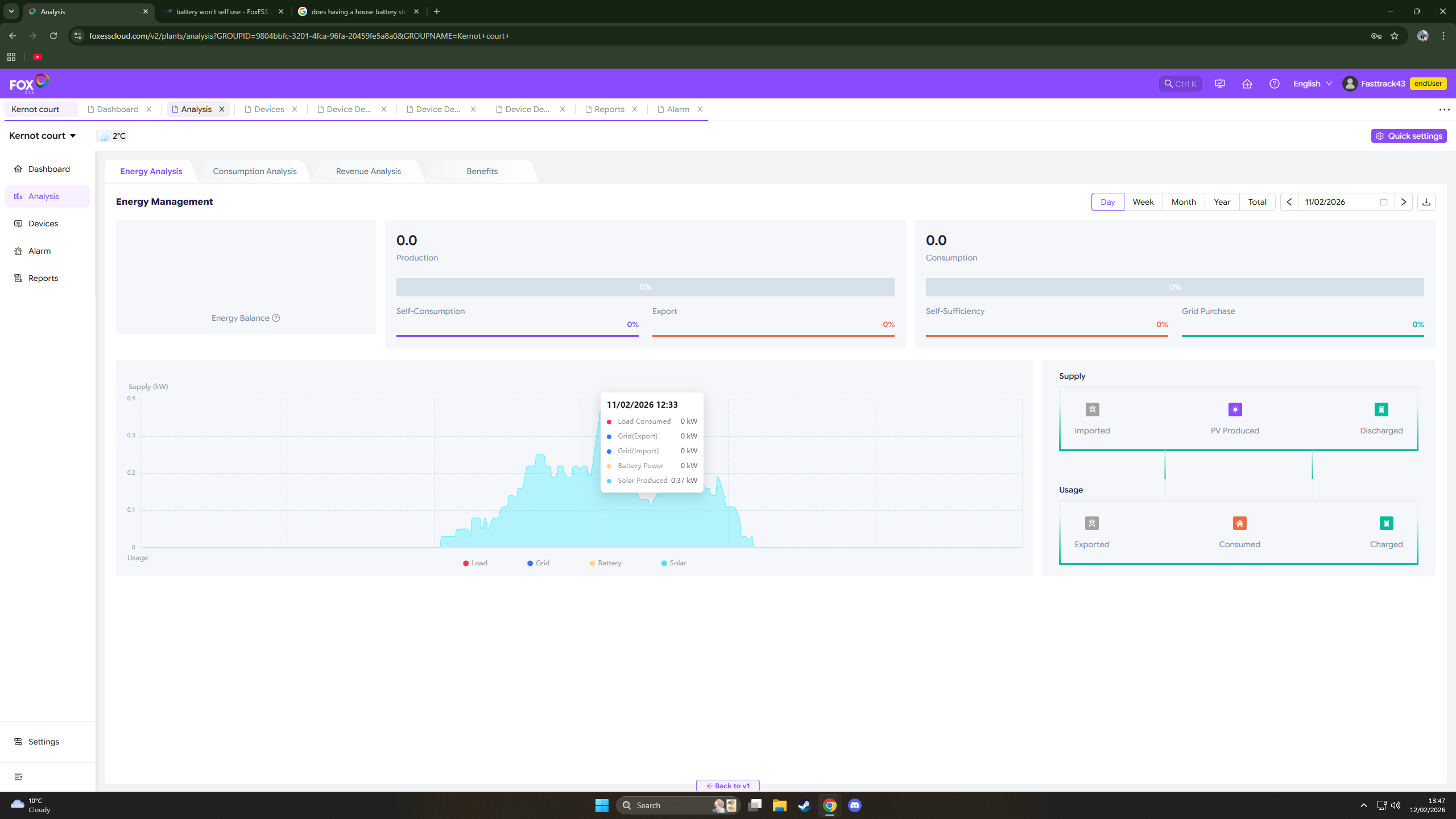

It does feel a bit like a system that doesn’t have it’s CT clamp enabled so definitely check this, it would be easier to tell from the graph shown in the Analysis page as that shows Load, Grid, Battery and Solar all together - if you could post that image it would be helpful so we can rule out meter problems.

It was disabled, I have enabled it and now the battery is actually in use, Thank you all so much, it's been almost two years and last month my dad payed £287 for the electric after just having heart failure and he's been stressing about his bills as he's had to retire so just want you to know for you guys that replied that your time given to a stranger on the Internet has had a big impact, thank you and have a good 2026
The CT clamp has been known to disable itself after firmware updates usually just after installation so that stacks up with what you’ve seen - once it’s been re-enabled it never does it again, so hopefully that’s it now
