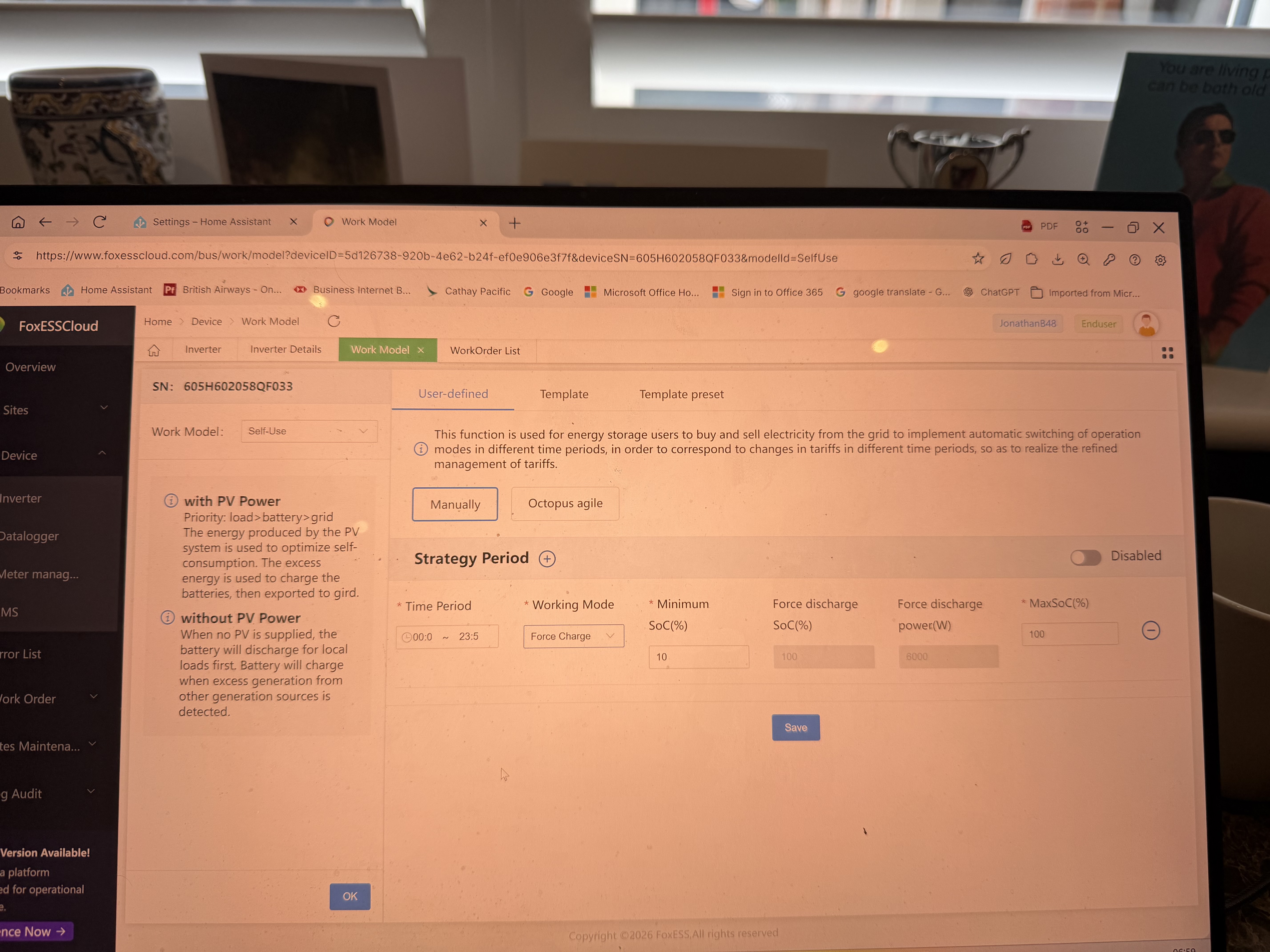

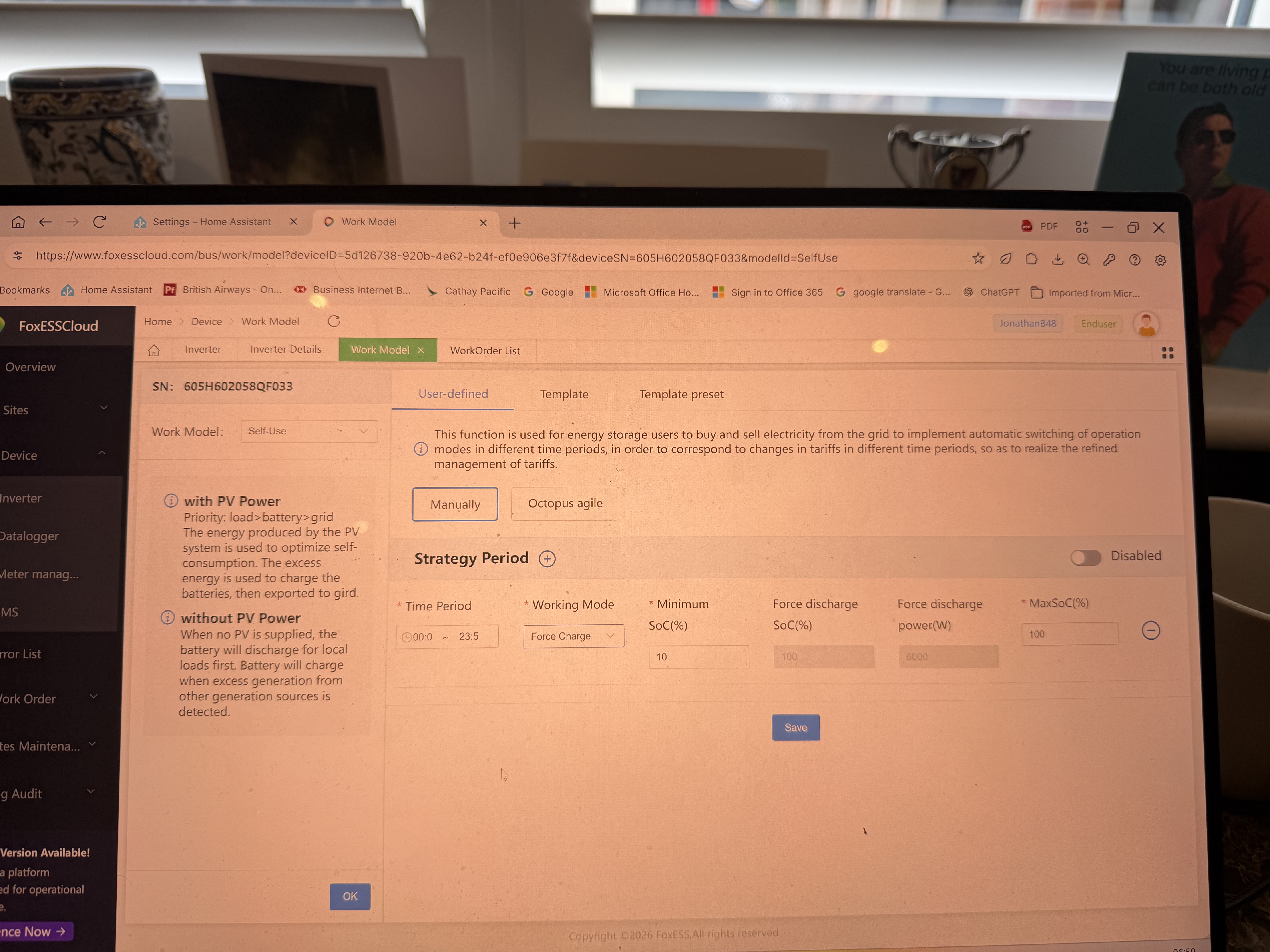

So all has been well until my meter and check comms unit bricked and so after many calls octopus replaced my meter and I re-integrated home assistant and my new meter- charged perfectly for the first night but second night automation started perfectly with off peak but then stopped at midnight and stated discharging - I think something has happened with the scheduler . I have disabled it in the pc version and also switched to a non work schedule mode but don’t seem to be able to delete the phantom strategy period even though it is disabled and I think this may be an interferenceImage[/img]
Appreciate any thoughts as always
Re: Intelligent Octopus Go and Home Asssitant Integration
The only difference between your picture and mine, is I don't have the ghost schedule.
Even if that ghost schedule did activate, it should have been charging and not discharging.
I think you need to look at HA logs to see what happened at midnight, just before and after.

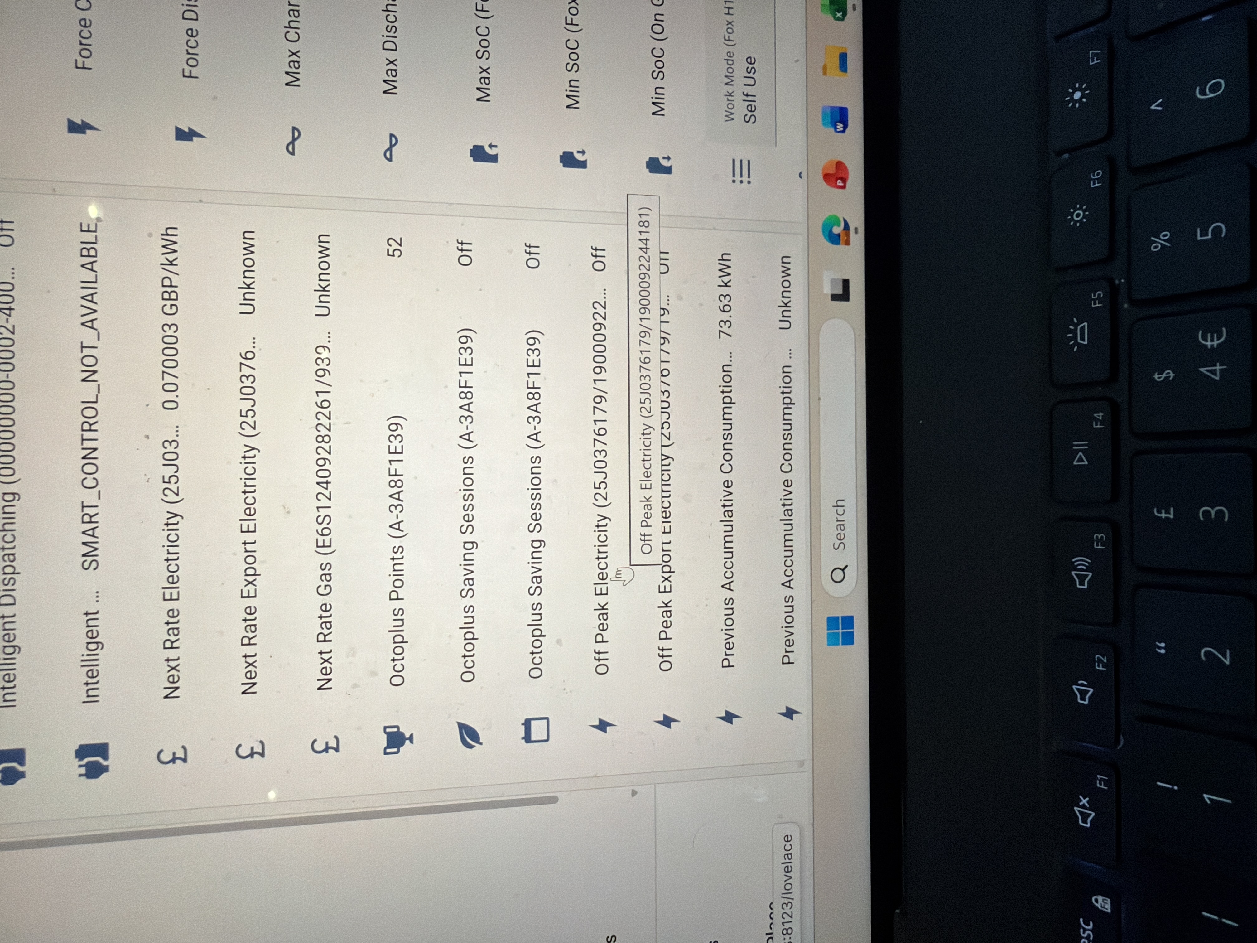

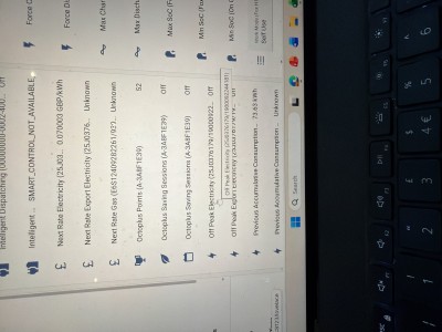

Didn’t see too much in the log. But what I have noticed is that in my automation I have the triggers for off and on of the off peak electricity but only have the sensor for switching off the off peak which does not come back if I reload the octopus integration Image

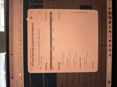

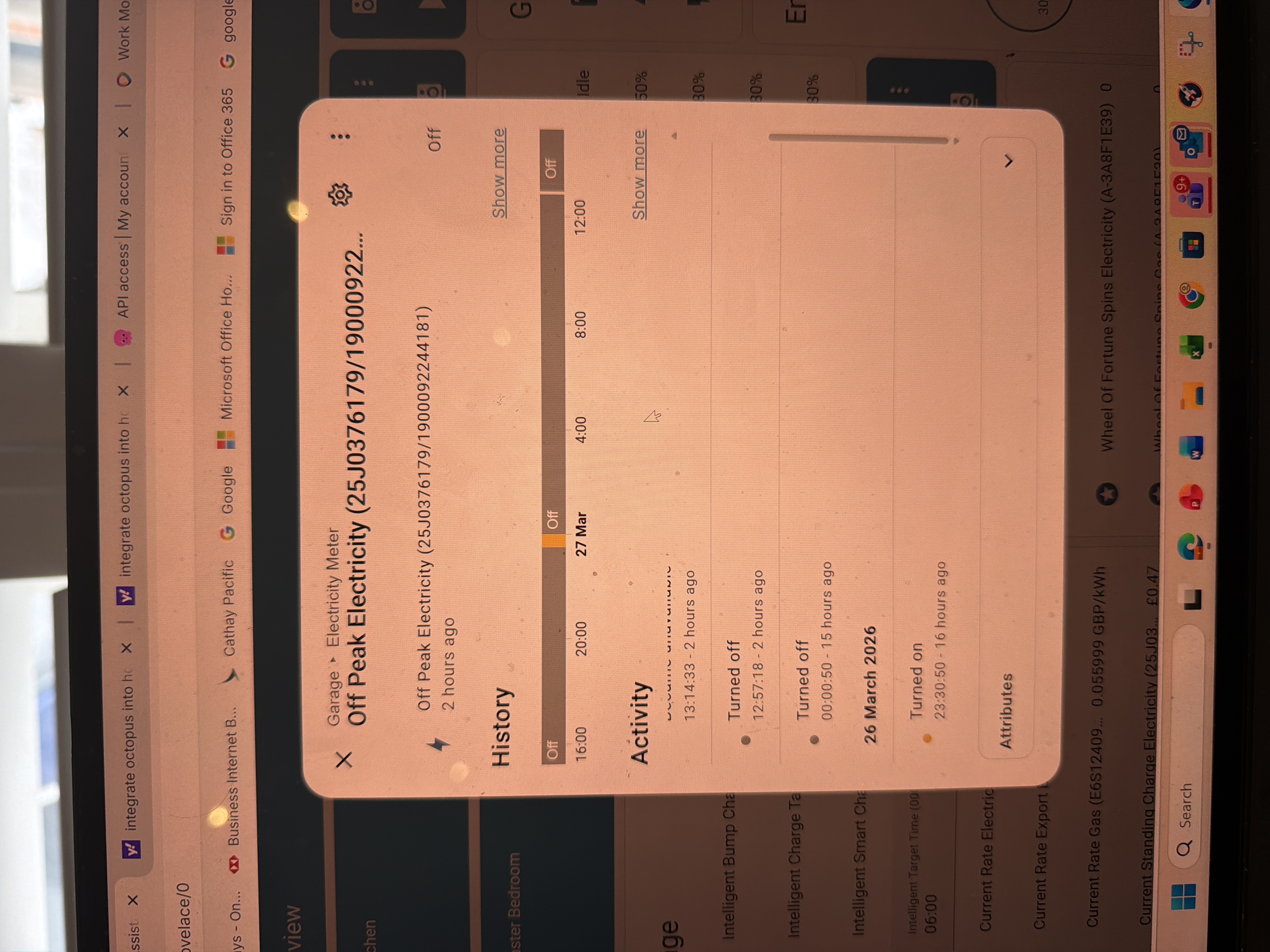

If you click on the sensor, it should show the history.
This is what it shows
Did your Off-peak sensor work for last night?
Yes it appears to have done as I have the car charging up until 6am and the batteries charged too so it seems I have managed to disable the scheduler which is what I think was the problem- new challenge is that my second inverter has now arrived and will be installed on Monday so making sure both work and both operate together will be exciting !
