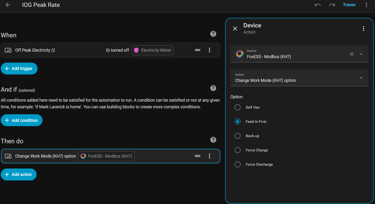

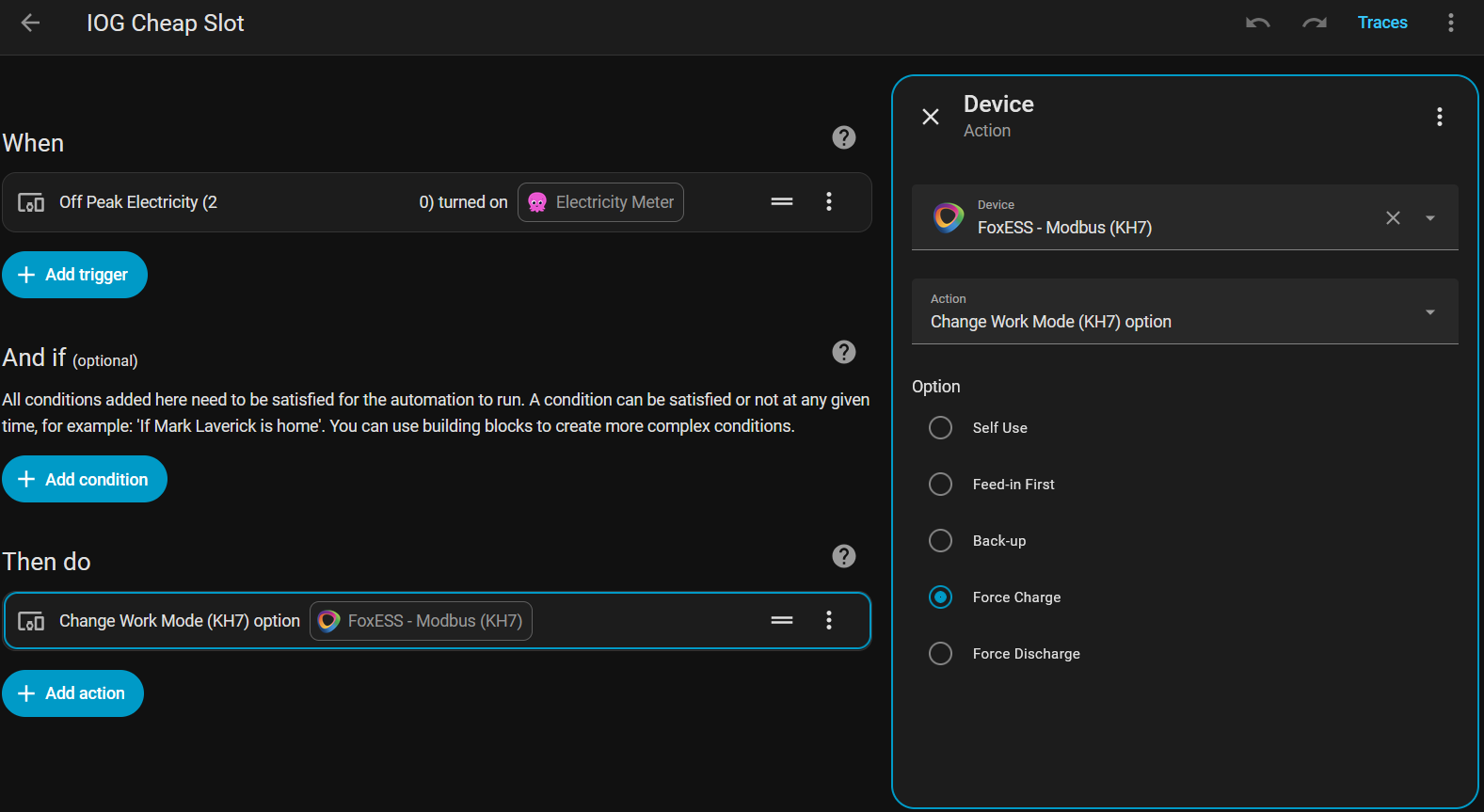

I followed this video from Will
You have 2 automations, one waits for the Off peak to turn on, changes the Inverter into Force Charge, it works with the Dynamic IOG slots, and the night time period.
Next automation waits for the opposite, where Off peak turns off, changes mode to Self-use/Feed-in for daytime or after you have had a random IOG slot occur.

Didn’t see too much in the log. But what I have noticed is that in my automation I have the triggers for off and on of the off peak electricity but only have the sensor for switching off the off peak which does not come back if I reload the octopus integration ![Image]()
