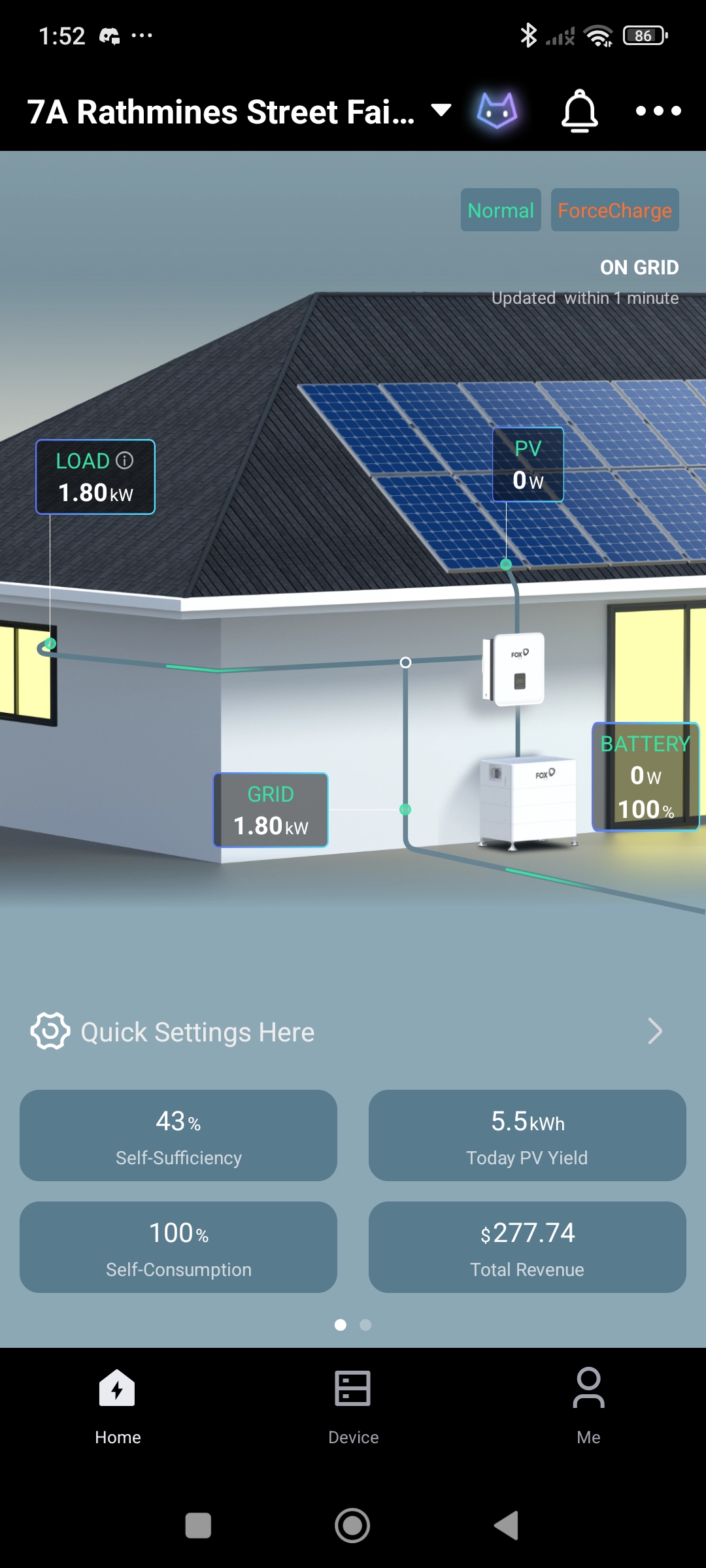

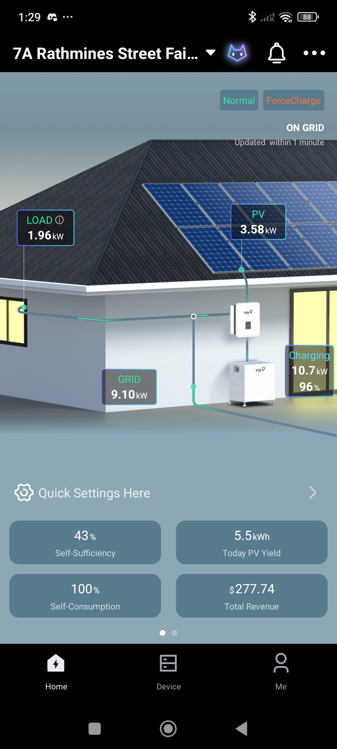

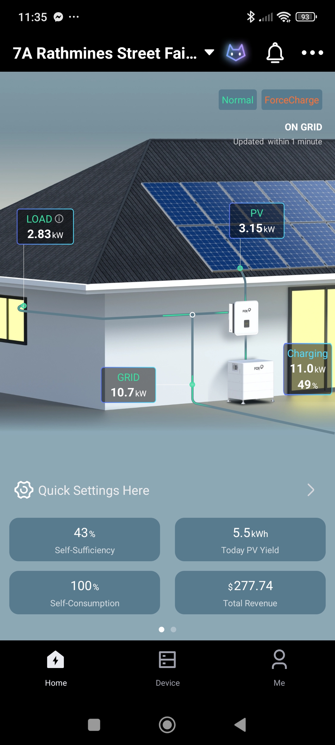

Here is the screenshots of the behaviour during Force Charge from Grid.
(1) 11:35AM - At the begining of the force charge period battery Soc is low (49%) and charging from PV(3.15kW)+Grid(7.85kw) at maximumn of 11kW.
(2) 1:29PM - Approaching the battery being fully charged (96%), the charging from PV(3.58kW)+Grid(6.12kW) is slowed slightly to 10.7kW.
(3) 1:52PM - Battery is fully charged (100%), PV(0kW) is stopped and Battery (100%) is stopped. Load(1.8kW) is from the Grid(1.8kW).

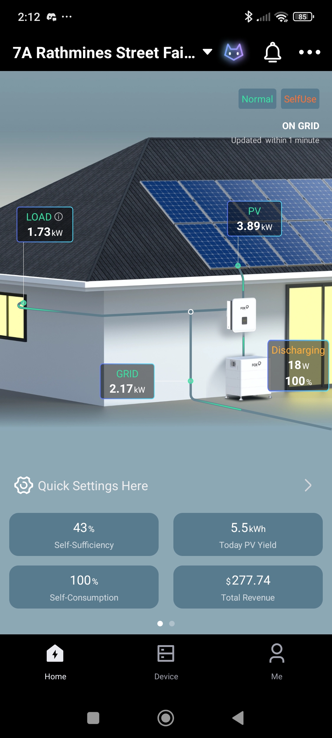

(4) 2:12PM - After the force charge period, in the default Self Use mode, PV(3.89kW) is active again and providing the Load(1.73kW), and excess is going back to the Grid(2.17kW).
Obviously there was around 3.5kW of PV during the force charge period when the battery was full (3), but the inverter stopped using it.
Is there any way to use the available PV during a force charge period when the battery is 100%.

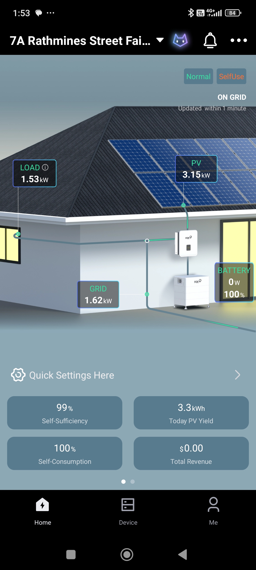

Tried Mode Scheduler with Force Charge again and same result. When battery reaches 100% it cuts the PV power to 0W and uses the grid to power the home load.
Then switched back to basic scheduler and it didn't cut the PV when battery was at 100%. PV was used for the home load and any excess went back into the grid. This is exactly what I want, but I also want to use Force Discharge during other times, which is not available in the basic scheduler.
It seems like during force charge with the mode scheduler, during the entire period the PV can only be used to charge the battery. If during the period it reaches the FC Cutoff SOC, it cuts hte PV to 0W as it cannot charge the battery anymore.

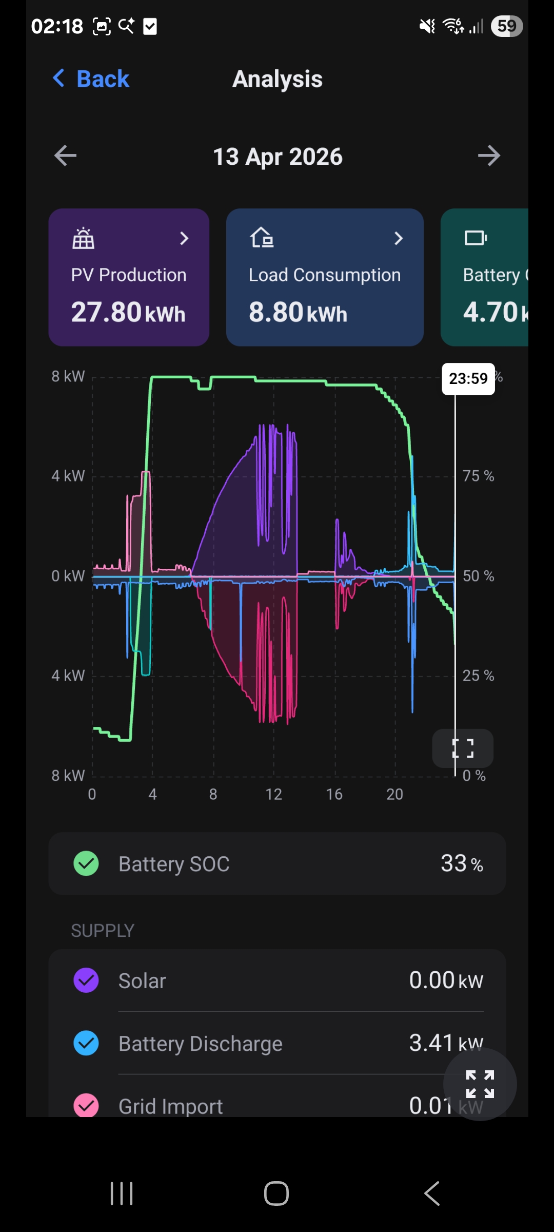

I have just noticed this on the app, we had our forced discharge in the evening capped at 60% SOC so that we could revert to battery power for the evening.
Its utterly pointless discharging if during that period you are powered from the grid at premium rate.
I dont recall this happening before prior to the new updates

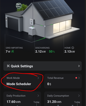

I'm fairly new to all this too, but if it is the same as mine, then you will have Work Mode set to Mode Scheduler. When I schedule is not in operation then it will default to Self-Use (which is what you probably want normally). If you click on that and edit the schedule you can disable the current schedule so it isn't used. Don't delete it just disable it. Then whenever you want it again you can enable again.

Thank you for that guidance and this appears to have solved my issue - Cheers
