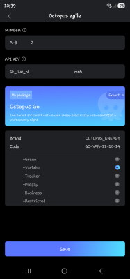

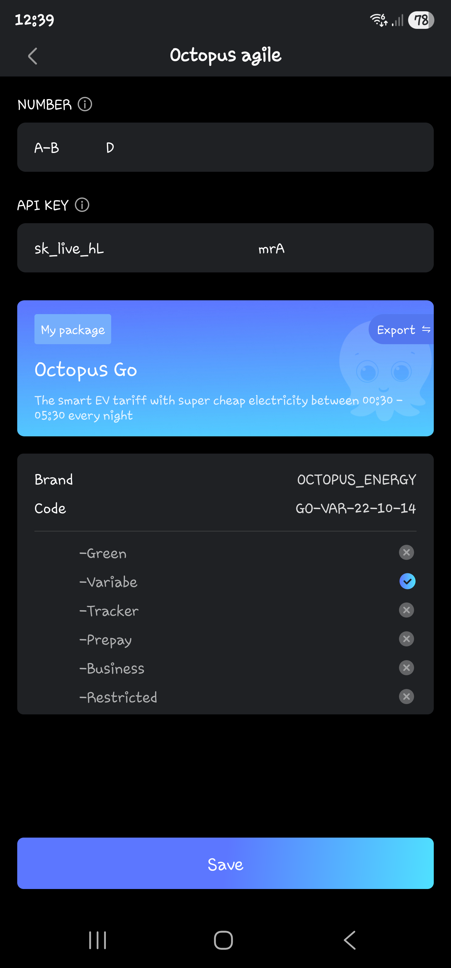

It's probably how you copy/paste the information in, I did struggle first time.
I think it was adding an invisible space on end of API key, or account number.
Here is an example image of how the two inputs should look (sorry if you have tried this and had no luck)
Octopus Account Number
Then API Key
