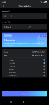

It's probably how you copy/paste the information in, I did struggle first time.
I think it was adding an invisible space on end of API key, or account number.
Here is an example image of how the two inputs should look (sorry if you have tried this and had no luck)
Octopus Account Number
Then API Key
Re: FoxESS and Octopus Agile API
Always worth a check again but no additional spaces. Copied as is from the Octopus API key page. Oddly if i make a mistake i get an API error as expected, but the correct details gives me the error in my first post.
