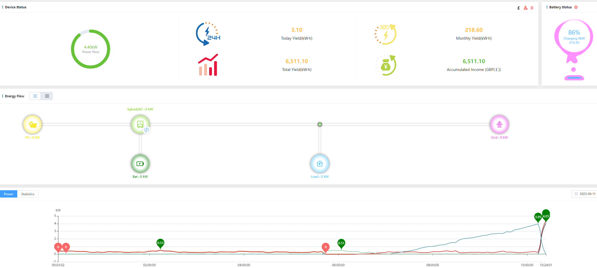

I have just under 6KW of solar panels and a ~10KWh battery array.
Whilst the sun is shining, and the panels are generating over 4Kw of electricity, the batteries have stopped charging (86%) and Im now exporting to the grid.
Some days, the batteries charge to 100%, but this phenomenon is getting more frequent, and as we move into spring and summer Im trying to understand why.
Capture from my Foxess web site available...
Thanks for any help.

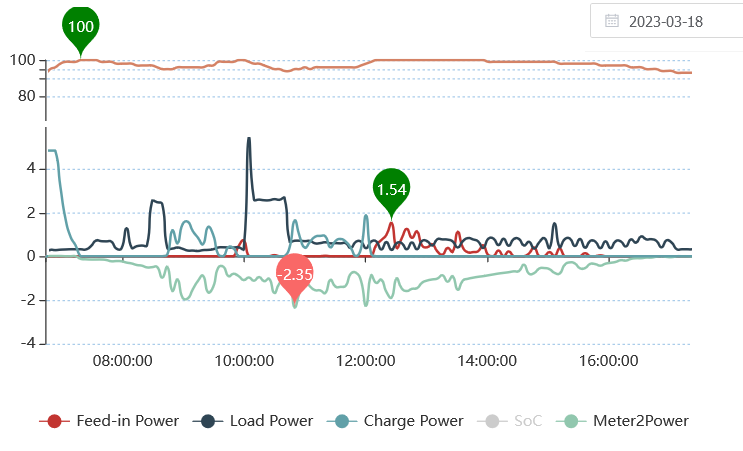

If my battery is charged to anything over 95% SoC and there's any gap in further charging, e.g. someone puts the kettle on to make load exceed solar output, then when the solar power again exceeds load, the excess is exported. That is, it won't start charging again if my battery is already over 95%. But if the solar always exceeds load, and it starts charging when SoC is less than 95%, it charges all the way to 100% before there's any power exported.
I've double-checked that's what happens, and as far as I can see it's reliable. Also, when I first noted that the battery appeared to have stopped charging, even though it was below max SoC, I rang the support engineer from the co that installed the system. He immediately said it would do more or less as described - that there was a threshold above which it wouldn't start to charge -, though he wasn't sure if this threshold was 95 or 90%.
I've been asking if there's a control parameter for this threshold, but it seems not.

Back on the issue of my battery won't start to charge if it's already over 95%: I went and looked at my recordings. What does seem to well show this threshold is when the battery reaches 100% from solar, so the excess starts to be exported. In that case, when the solar power dips below load, then the battery discharges - obviously. But then, if the solar comes back above load, the excess is again exported, not used to re-charge the less than 100% charged battery.
The above shows parts of events of 18 March this year, with everything but SoC expanded for clarity. Early on in the day, I've twice used the oven (once in combination with the kettle) to bring the battery down below 95 percent, once to prevent and once to stop the system exporting. It also shows, towards the end of the period of solar power, the export stuttering until the battery gets down to 95%, by which time there was no excess to charge the battery anyway. But it shows the issue.
But getting the app to plot charge power as green and export as red was less fun than it was worth.
Graham
