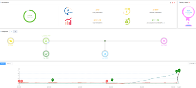

Capture from my Foxess web site available...

Also it's a bit weird that you have no data on your energy flow diagram.

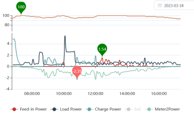

Back on the issue of my battery won't start to charge if it's already over 95%: I went and looked at my recordings. What does seem to well show this threshold is when the battery reaches 100% from solar, so the excess starts to be exported. In that case, when the solar power dips below load, then the battery discharges - obviously. But then, if the solar comes back above load, the excess is again exported, not used to re-charge the less than 100% charged battery.
The above shows parts of events of 18 March this year, with everything but SoC expanded for clarity. Early on in the day, I've twice used the oven (once in combination with the kettle) to bring the battery down below 95 percent, once to prevent and once to stop the system exporting. It also shows, towards the end of the period of solar power, the export stuttering until the battery gets down to 95%, by which time there was no excess to charge the battery anyway. But it shows the issue.

Graham
But getting the app to plot charge power as green and export as red was less fun than it was worth.
