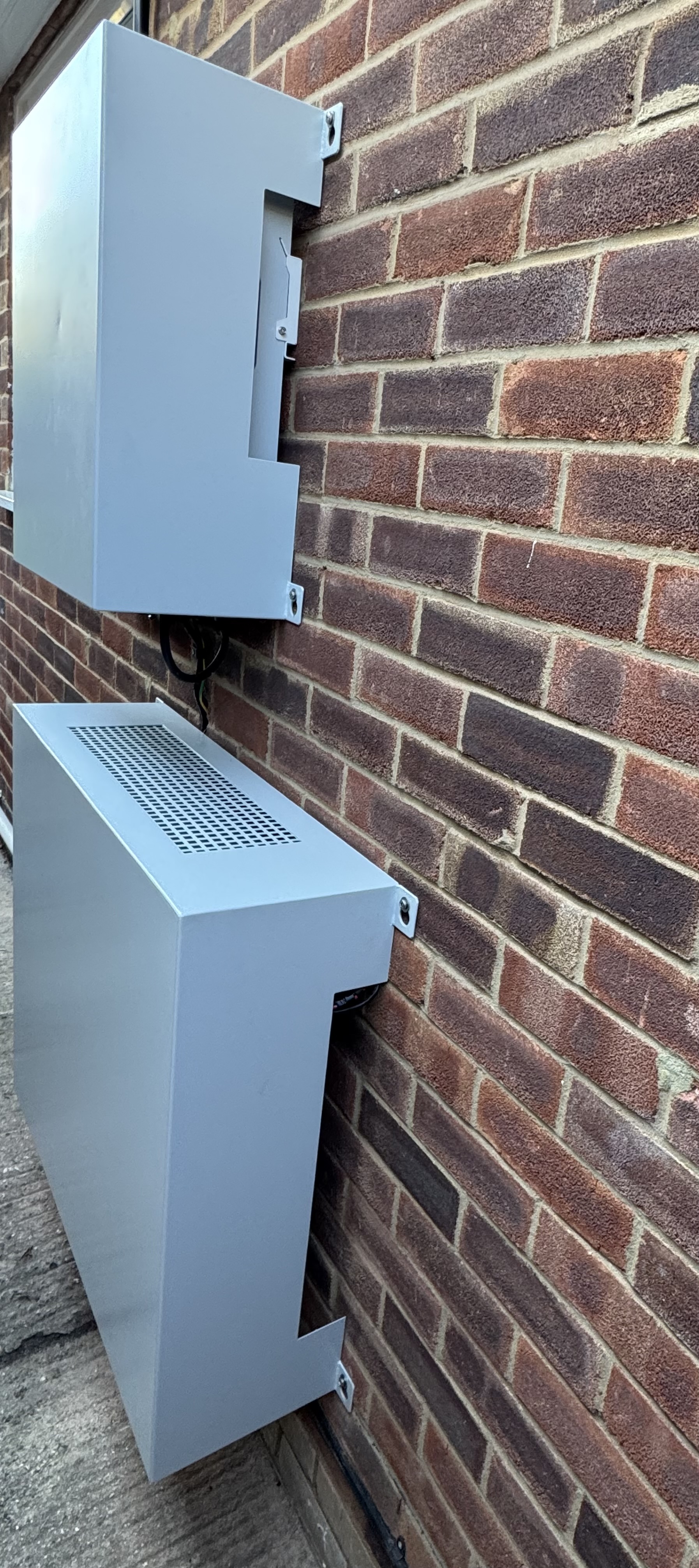

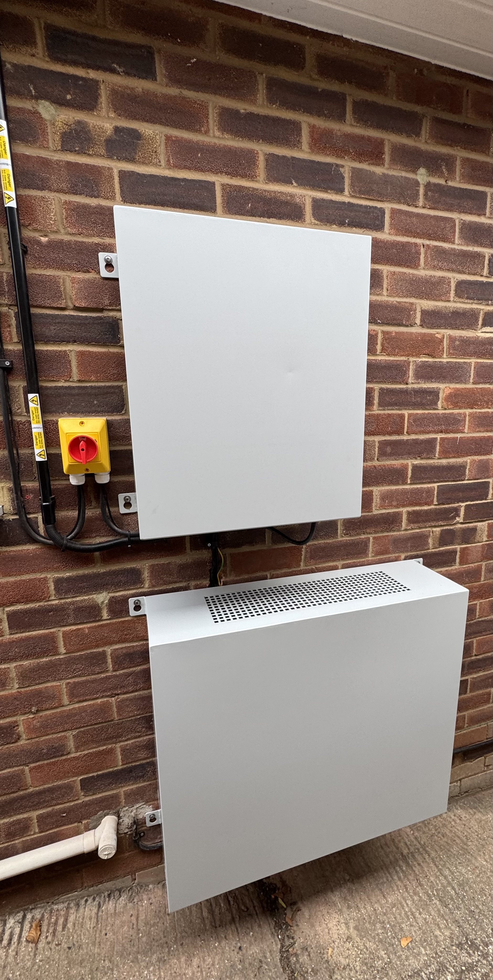

Could not find much out on the market for covers, other than some highly priced folding PVC units, and did not want the look of a shed on the side of the house effect, sketched out some designs and got my local fabricator to knock up a pair of covers.
Very pleased with the quality and outcome.

I think your DIY covers look better; you should put them on ebay do made to order. plus a margin.
Thanks!
I was surprised there was nothing out there, I can’t be the only person looking for some external sun and dirt protection for this issue.
My fabricator is a small 2 man operation, and he had never been approached for solar before.
If anyone wants my measurements, just ask.

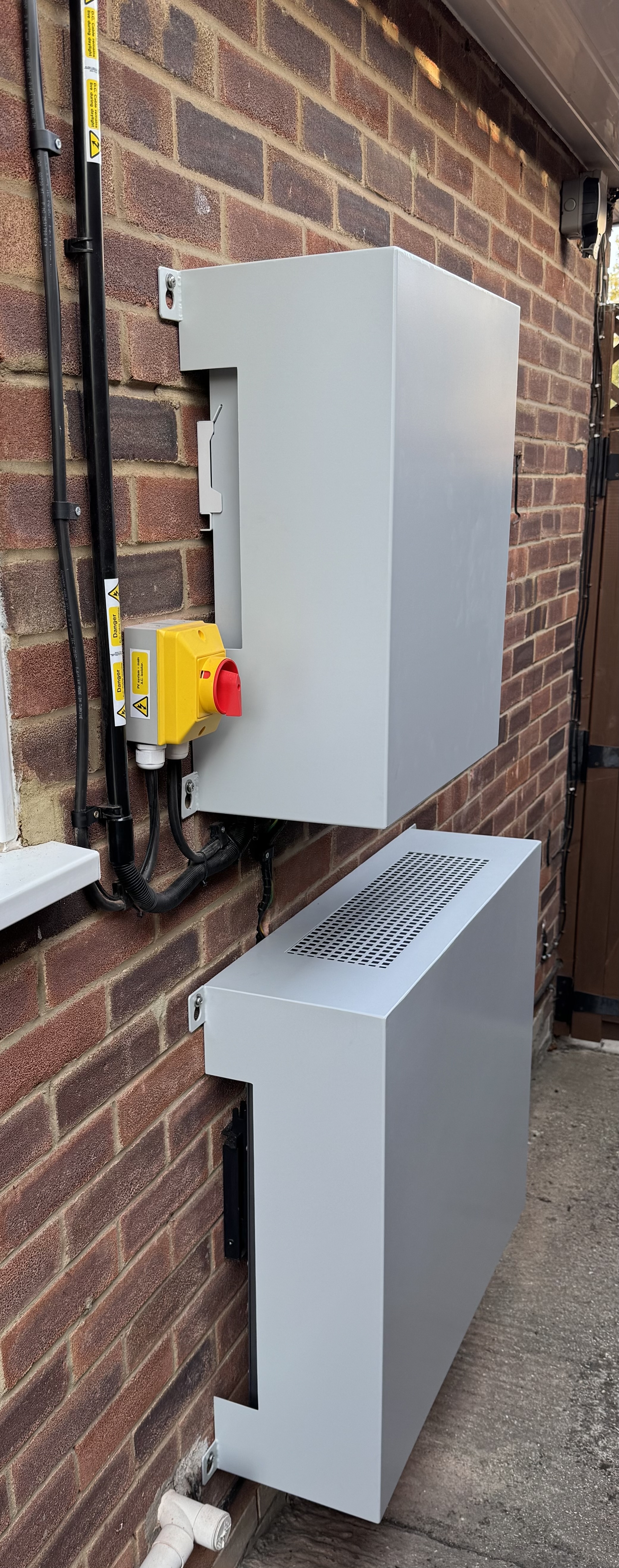

The only mistake I made was not to allow a gap for the cables from the battery to inverter in the top rear of the cover, I just channeled the wall to sit them flat where it passed the cover edge. The other option was to reroute them, as there was plenty of slack to come in via the left hand side.
I’ve left them completely open at the bottom of each cover.
There is plenty of ventilation, and air movement, but the reality is that you can design any size that suits.
Also there is the option to put insulation board in some areas in the battery cover to retain heat in the winter if required.
And you can have them power coated any colour you wish.
All this at well under half the price of the only commercially available option I could find.
