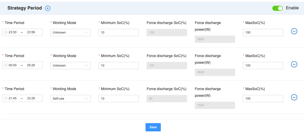

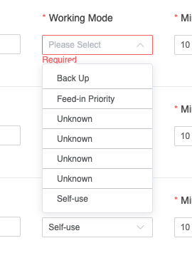

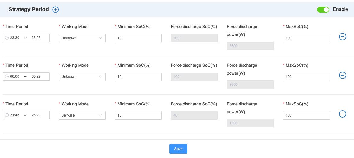

I just had the firmware updated yesterday when my installer came for some other work, and I'm somewhat disappointed that I can not set a force discharge.. and even the force charge doesn't show properly (even though, thankfully, it does charge). If it didn't, I'd be totally screwed as there's not enough solar right now to charge the battery fully.
Working Mode just shows a mess now?
Screenshot 2025-10-23 at 01.04.13.png (18.79 KiB) Viewed 46946 times
Will there be a fix and how do I go about getting it installed? Do I have to get the installer to request it or can I? And if I can get it rolled back, does that introduce any issues?
I also get a 44098 Write Error if I try and adjust the two legacy force time charge times.
Re: H1-Gen2 Manager V1.61 (Known bugs)
Frustrating I know, there will be a fix (I would imagine soon as Fox are well aware of this) but at the moment the only option is to roll the firmware back to a previous version - your installer will be able to do that remotely as the old version is still available.
The old charge periods will still work but cannot be used at the same time with scheduler enabled, that’s what is causing the 44098 error - disable scheduler and they will work.
