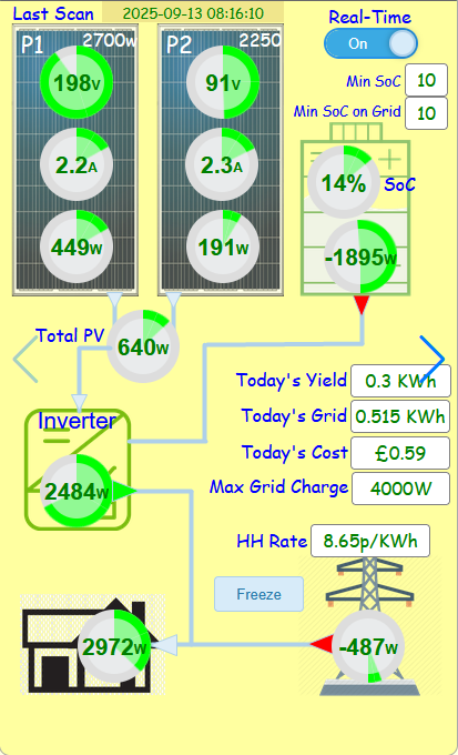

Thanks Dave,
Temp was around 14degC and I was monitoring using my real-time app which can scan every second when I want it to. Here's the snap-shot I took at the time:
I also reviewed my database and I found several instances where the battery and PV was supplying house demand with battery output above 2000W and as soon as the SoC dropped to 20% battery output dropped to around 1900W and the grid had to take up the slack.

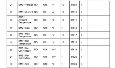

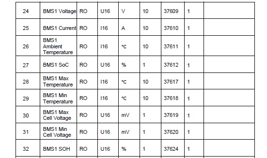

Re: Battery Output Limited to 50%
Try address 37618.
It seems 31023 is the BMS pcb temp.
Manager(ARM):1.79
Master:1.59
BMS:1.013
That's great, thanks Dave and nrb501
