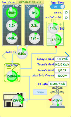

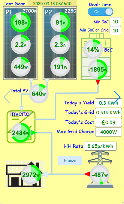

Is there a situation where an EP5 battery output is resticted to 50% of it's maximum rate?
Situation looked like this:
Load - 2972W
Solar - 640W
Battery - 1895W
SoC - 14%
Grid Importing - 487W
Looking back through my data it appears to limit output whenever it goes below 20% SoC. It would be good to know if this is the case as up to now I've expected full output until it hit a min SoC settings.

Thanks Dave,
Temp was around 14degC and I was monitoring using my real-time app which can scan every second when I want it to. Here's the snap-shot I took at the time:
I also reviewed my database and I found several instances where the battery and PV was supplying house demand with battery output above 2000W and as soon as the SoC dropped to 20% battery output dropped to around 1900W and the grid had to take up the slack.

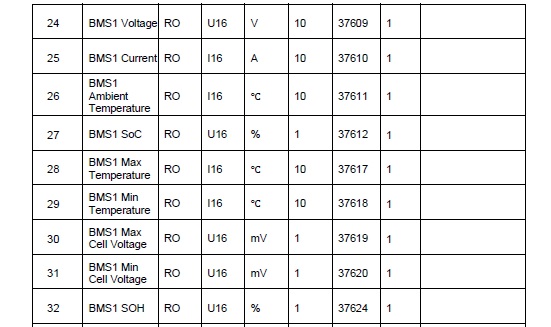

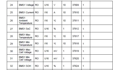

What's the modbus register for 'Bat Cell Temp Low' please?
I'm using a USB - RS485 connection and the main registrer set for most of the invertor read-only values start at 31000
and I can see the ambient and fin temperatures in 31018/19.

Try address 37618.
It seems 31023 is the BMS pcb temp.
