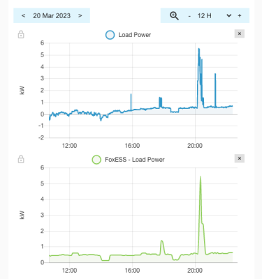

I've managed to get my H1 inverter talking to HA via Modbus over ethernet.
All seems to working well, except there is something odd about the Load Power numbers.
In the charts below the blue line is the Load Power from the Cloud based HA integration and the green line is the Modbus HA integration.
The Modbus Load Power seems to be incorrect since this morning. Any ideas anyone?
Strange Load Power Numbers - Fox H1, Modbus

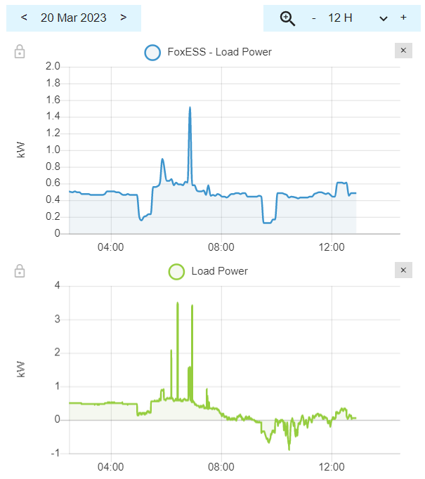

I'm using the version from HACS and I've set it up with the LAN option in the configuration file. Interestingly the numbers seemed to match until around 08:00 this morning when the modbus version seems to have an offset compared to the cloud. All very strange.Dave Foster wrote: ↑Mon Mar 20, 2023 5:42 pm Which modbus version are you using the original stealthchustnut version (where you include a modbus.yaml file) or the one that’s just come out which is installed as an integration.
If it’s the first one, i’m wondering if you’ve used the modbususb file instead of the modbuslan file (the register numbers are different) - it still works (kindof) but you get funny results.
I think I've worked out what's going on. The Load Power seems to be the power drawn by the house minus the power coming from my panels.
This may be a quirk of the way my system is configured.
My panels feed a Solaredge inverter and the output of that appears as a feed into the Fox system. I've struggled to find this value in the output from Fox but this seems to make sense.
Does this make sense to someone with more knowledge than me?

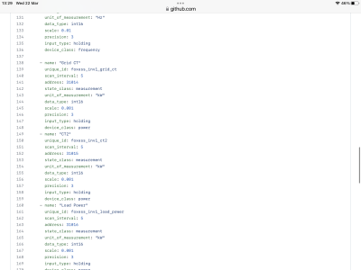

I'm a bit puzzled, I've installed the version from here: https://github.com/StealthChesnut/HA-FoxESS-ModbusDave Foster wrote: ↑Tue Mar 21, 2023 5:17 pm Ahh right ok, that makes more sense - the later versions of the modbus LAN had the second CT meter added about 4 weeks ago - it’s called sensor.ct2 (or sensor.ct2_meter depending on version) if you don’t have it, update to the latest version.
and the CT 2 doesn't seem to appear on my install. The reference table https://github.com/StealthChesnut/HA-Fo ... e---H1-AC1 seems to imply this doesn't exist on the LAN version.
That version is more of a self install, i.e. copy and paste into the modbuslan.yaml
The latest version does include CT2 but you would have to update manually.
If you copy and paste this code segment into your modbuslan.yaml, be careful that the format lines up with the other sensors ,save it and restart HA you’ll have a CT2 sensor.
- name: "CT2"
unique_id: foxess_inv1_ct2
scan_interval: 5
address: 31015
state_class: measurement
unit_of_measurement: "kW"
data_type: int16
scale: 0.001
precision: 3
input_type: holding
device_class: power
There is a very new version which is much easier to install, it’s managed via HACS and just needs the basic configuration and off you go - I would highly recommend it as it’s easier and much faster, if you use RS485 rather than LAN access it allows a lot more control of the inverter (setting minsoc / maxsoc)
This is it here - https://github.com/nathanmarlor/foxess_modbus
If you are going to install this one, in configuration.yaml comment out the include file for your current modbuslan.yaml - then restart HA, then install this new one, otherwise you get duplicated sensor names.
