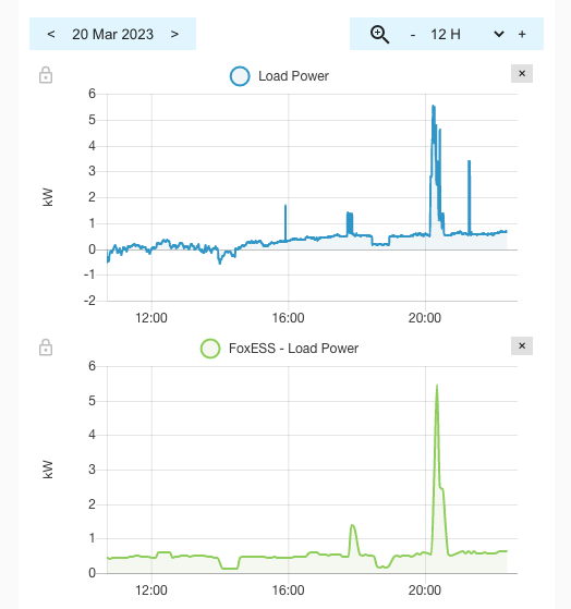

I've managed to get my H1 inverter talking to HA via Modbus over ethernet.
All seems to working well, except there is something odd about the Load Power numbers.
In the charts below the blue line is the Load Power from the Cloud based HA integration and the green line is the Modbus HA integration.
The Modbus Load Power seems to be incorrect since this morning. Any ideas anyone?

I'm using the version from HACS and I've set it up with the LAN option in the configuration file. Interestingly the numbers seemed to match until around 08:00 this morning when the modbus version seems to have an offset compared to the cloud. All very strange.Dave Foster wrote: Mon Mar 20, 2023 5:42 pm Which modbus version are you using the original stealthchustnut version (where you include a modbus.yaml file) or the one that’s just come out which is installed as an integration.
If it’s the first one, i’m wondering if you’ve used the modbususb file instead of the modbuslan file (the register numbers are different) - it still works (kindof) but you get funny results.
I think I've worked out what's going on. The Load Power seems to be the power drawn by the house minus the power coming from my panels.
This may be a quirk of the way my system is configured.
My panels feed a Solaredge inverter and the output of that appears as a feed into the Fox system. I've struggled to find this value in the output from Fox but this seems to make sense.
Does this make sense to someone with more knowledge than me?

Ahh right ok, that makes more sense - the later versions of the modbus LAN had the second CT meter added about 4 weeks ago - it’s called sensor.ct2 (or sensor.ct2_meter depending on version) if you don’t have it, update to the latest version.
