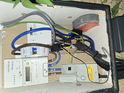

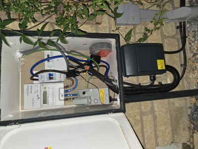

Thanks. This is how mine is wired:
Re: Hi from Gloucestershire
That looks like the solar system is wired directly from the Henley blocks to the black consumer unit below the meter cupboard - Is the EV being fed from a circuit breaker in the black consumer also ?
Yes I think that's how it's wired and yes the EV is powered from a CB in the box underneath.
Willzs wrote: ↑Mon Aug 18, 2025 10:56 am Yes I think that's how it's wired and yes the EV is powered from a CB in the box underneath.
Ok, that’s the problem because of the way it’s wired there is no possibility to move the CT clamp to see the inverter and the house load only, so the only way to charge without flattening your battery is to set a charge period on the inverter at the same time which isn’t so great for IOG.
If you are able to set up a home assistant on the current wiring it is possible to watch the Octopus tariff and stop the inverter discharging whilst the car is charging but the absolute fix is to wire the EV charge to a henley block on the feed from the smart meter so that it is in front of the inverters CT and house load, that will obviously require a sparky to fix for you but it will give you peace of mind that IOG can never steal all your battery power.
