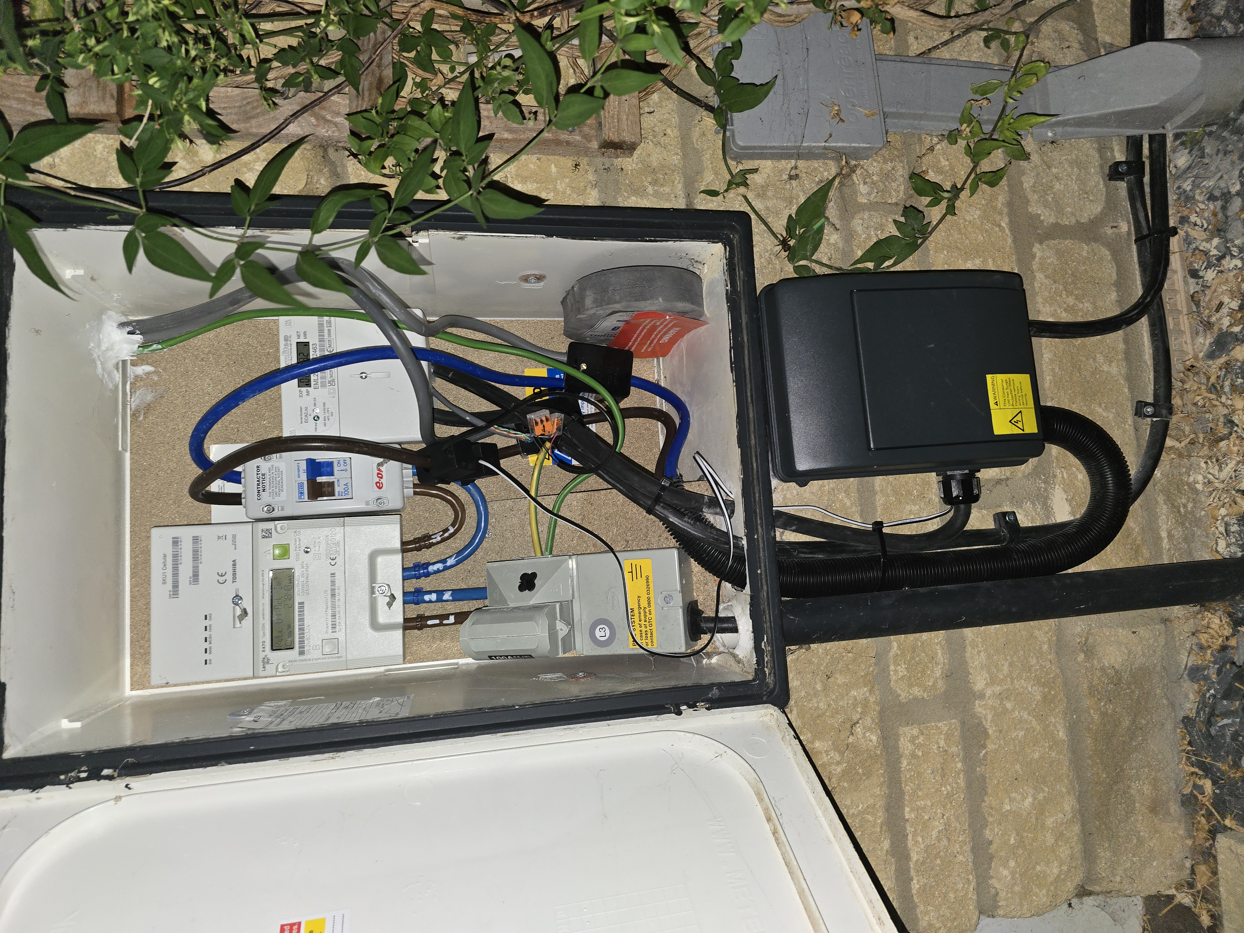

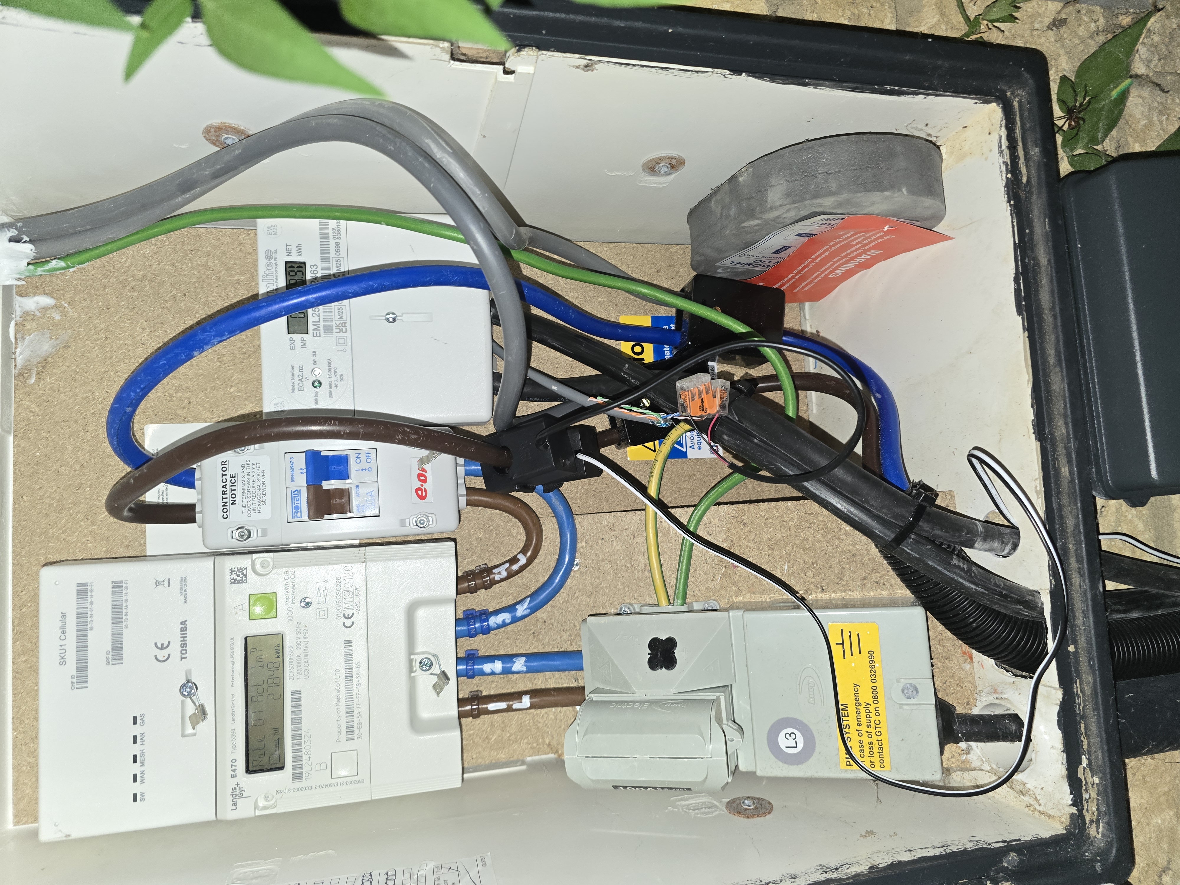

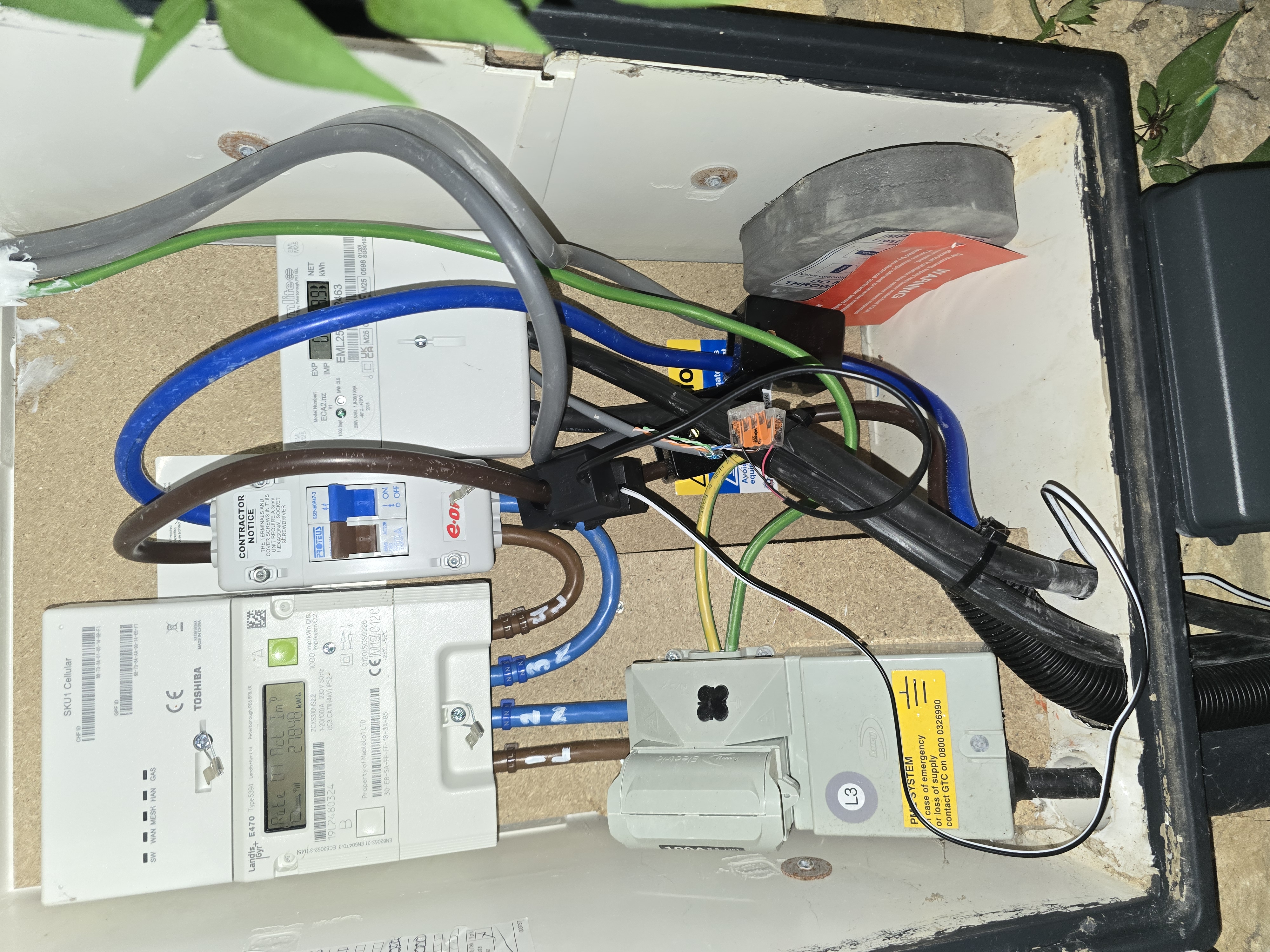

It’s not always possible to eliminate the EV charger from being read by the inverter, it will depend on how it has been wired but if you can clip the inverter CT so that it only reads the inverters output and the house load that is the cable you are looking for.
It may be you will need to get a sparky to split the grid feed on a Henley block where it comes out of your smart meter - one side feeds the EV, the other side the house / inverter and the CT will be clamped there.
That looks like the solar system is wired directly from the Henley blocks to the black consumer unit below the meter cupboard - Is the EV being fed from a circuit breaker in the black consumer also ?
Yes I think that's how it's wired and yes the EV is powered from a CB in the box underneath.
Ok, that’s the problem because of the way it’s wired there is no possibility to move the CT clamp to see the inverter and the house load only, so the only way to charge without flattening your battery is to set a charge period on the inverter at the same time which isn’t so great for IOG.
If you are able to set up a home assistant on the current wiring it is possible to watch the Octopus tariff and stop the inverter discharging whilst the car is charging but the absolute fix is to wire the EV charge to a henley block on the feed from the smart meter so that it is in front of the inverters CT and house load, that will obviously require a sparky to fix for you but it will give you peace of mind that IOG can never steal all your battery power.
