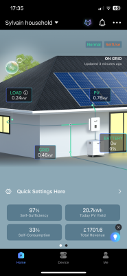

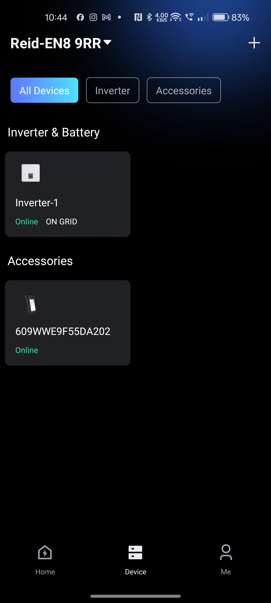

One issue though is that the stats of the battery (State of Charge and Current Power) are not showing on the home page of the app (first picture).

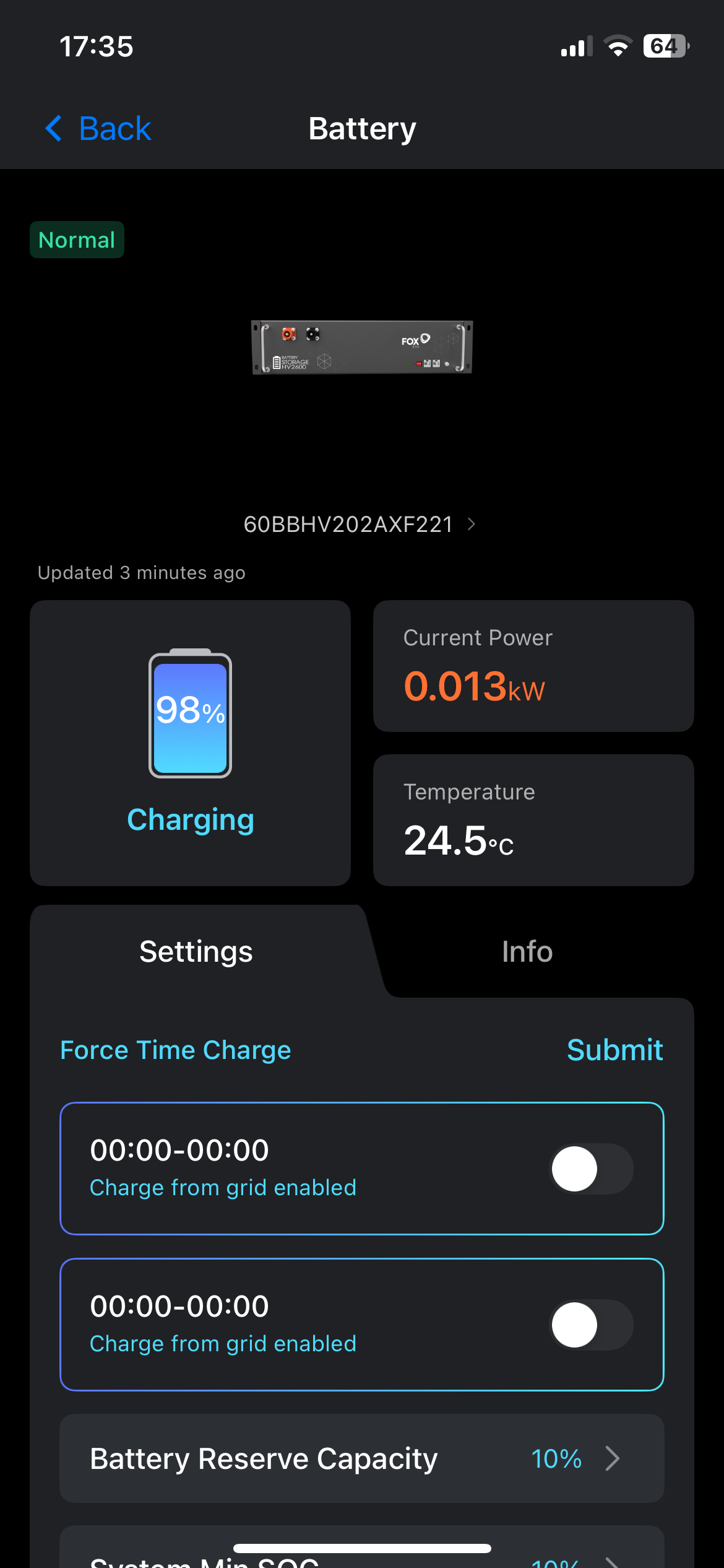

However the battery state of Charge and Current Power are showing on the device page of the battery so the information is definitley available.
Any idea how to fix that on the home page?

I would first ask your installer to update your inverter, datalogger and battery firmware.
When that's all up to date I would delete and reinstall the latest fox 2.0 from the app store and try logging in.
This feels like an app bug but the app is very sensitive to hardware firmware so best to start there.
