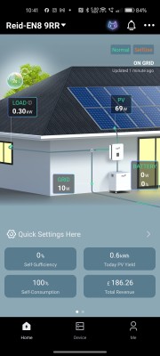

One issue though is that the stats of the battery (State of Charge and Current Power) are not showing on the home page of the app (first picture).

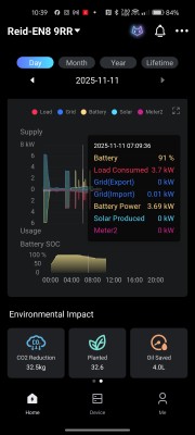

However the battery state of Charge and Current Power are showing on the device page of the battery so the information is definitley available.
Any idea how to fix that on the home page?
