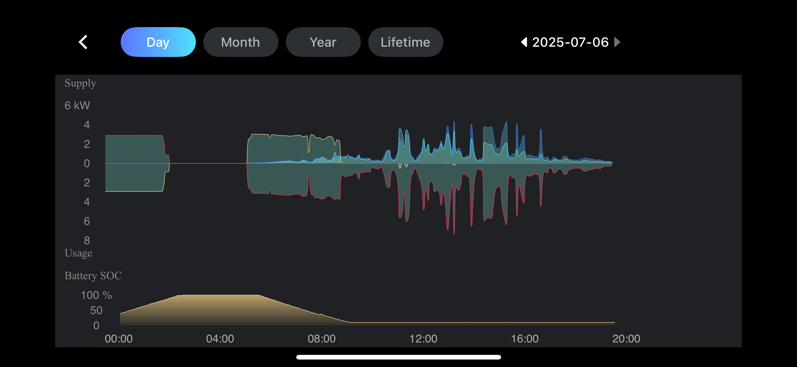

Need to see more information to diagnose, it could be CT placement - on the app’s main page can you swipe left and post an image of the graph at the bottom of the page (load, grid, battery, solar) for the same time period

The glitch just before 8am is where I removed one of the CT clamps to check the orientation. I wasn’t 100% sure , so placed it back how I found it.
