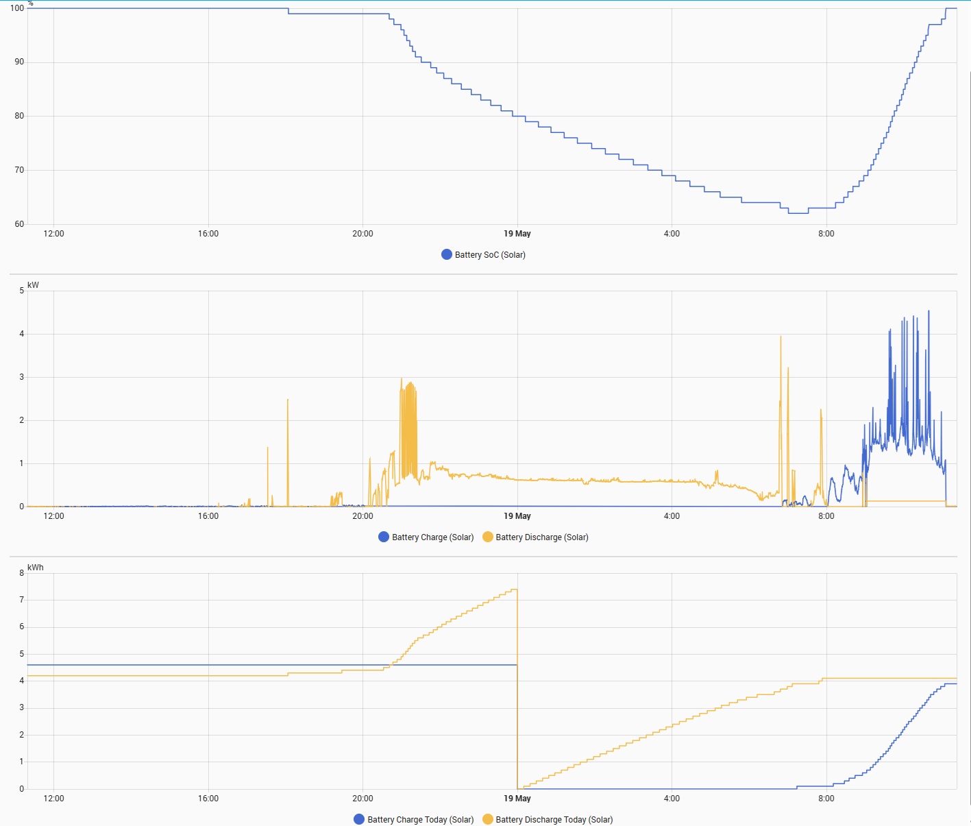

On a graph, the last 24 hours look like this:- The midnight to now lines match close enough but you need to ignore the discharge before midnight. Could there be something funny about this perhaps. I also notice that from about 9am till 11am today, the battery was charging but also has a constant discharge of 128W, which seems odd.
